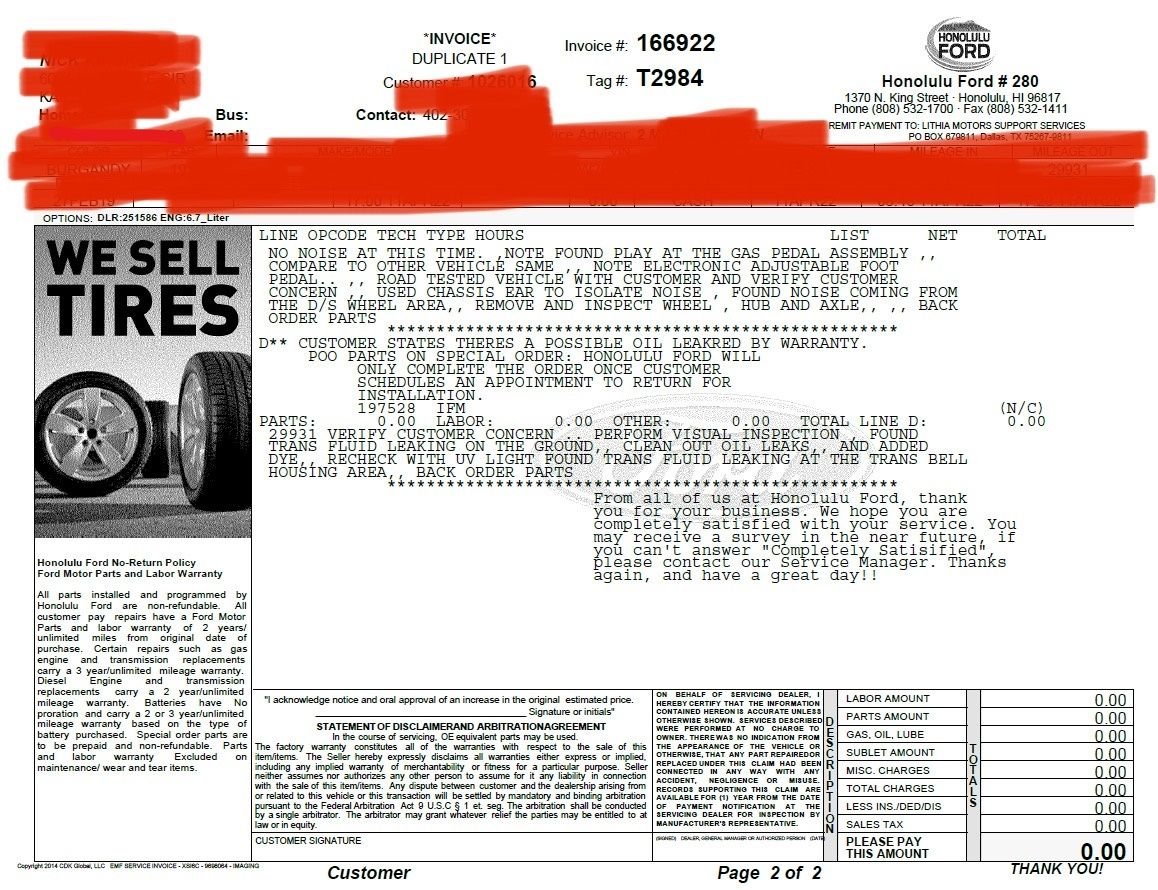

UPDATE: Took the truck into a different dealership yesterday with an appointment. At first they tried giving the truck back over and telling me that the car seat in the back was the cause of the noise and that they drove a similar truck and the pedal felt the same. Once I convinced them to let me take the mechanic for a ride I was able to get him to hear the noise that went with the pedal feeling by driving next to a retaining wall over some minor bumps. Truck went back into the bay, and two hours later they are going to email me over a list of parts that are being ordered for it when they get them ordered. Said he used the chassis ear to locate the issue. Still waiting to see what they are ordering, service ticket just says BACK ORDER PARTS. Any clues or anyone make any headway on their issue?

It may be easier to just start throwing parts at it, but dont want to spend the money if its not what is actually wrong. The truck is also still under warranty and the repairs are being covered by the warranty. The text I just got back from the service department asking for clarification says" the parts are mentioned on the invoice. But as you can see from the photos there are no parts listed as ordered to clarify what theyre doing.

Got a parts list today from the dealership. Here’s what they ordered for the front end noise and pedal “rattle.”

So they think it is the front axle?
I guess. All they did was text me the parts list they ordered. The service ticket says nothing other than “used chassis ears”to confirm the complaint.
