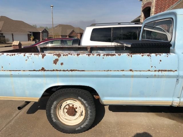

Here's some pictures about the truck its a really fun truck to drive but its scary as well.

My Mistake I quite often get the 2 engines (427, 429) confused, it is a 1970 429 engine from a thunderbird. And as for the transmission there isn't a hole cut in the floor for a manual transmission so it may have been patched 🤷. The current transmission that's in it though is a ford C6. For the interior is a mixture of faded blue so I'm pretty sure its the original interior, overall its a pretty sold truck the only rust it has is the floor pans other than that its a solid truck. I think the reason why its so solid is because its lived in Oklahoma for almost all of its life

Wow that's some fading from the original Harbor blue. Are you able to look somewhere hidden for the color? Is it that light of a blue everywhere the sun don't shine too?
