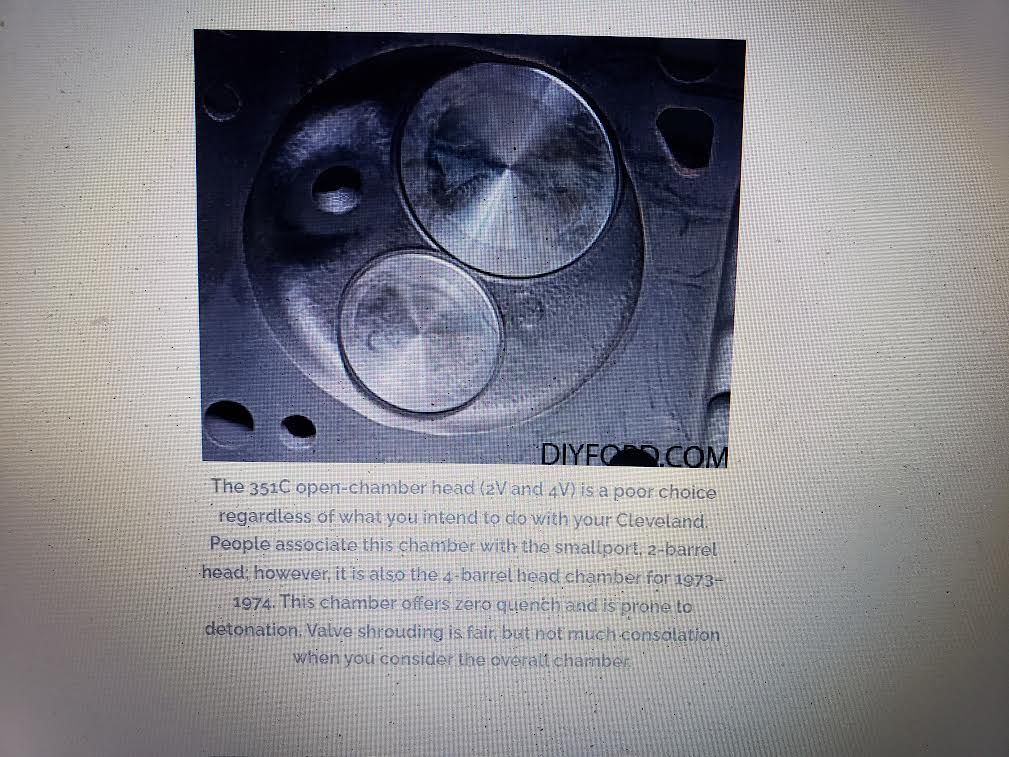

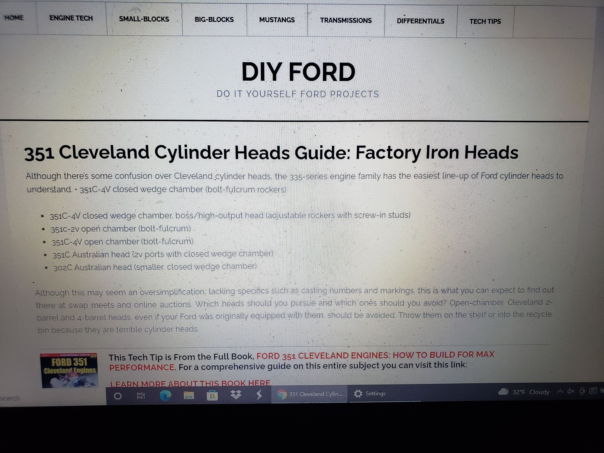

Find some closed chamber (pent roof) cylinder heads from a 351 C
That will bring the compression ratio up to around 10.5 or so
I will put pics below
The aussie heads have small ports that will fit your 2v manifold you bought and have the smaller 63-65 cc chambers
There is a good article about 351 C and M heads that you should read

The 351 C family of engines had a bad habit of wearing the valve guides
Bronze wall them if you do any head work (bronze valve guides)

I do not run premium in mine
Closed chamber 351C 4V heads on a built boss 302 motor
The closed chamber heads do not seem to detonate or run on like the open chamber heads do
Spark knock , ping , detonation and dieseling (run on) all very bad on the engine (pistons and rods)
I have my boss tuned well enough to pass 1980 I/M specs at 3.0 percent CO and 300 ppm HC
