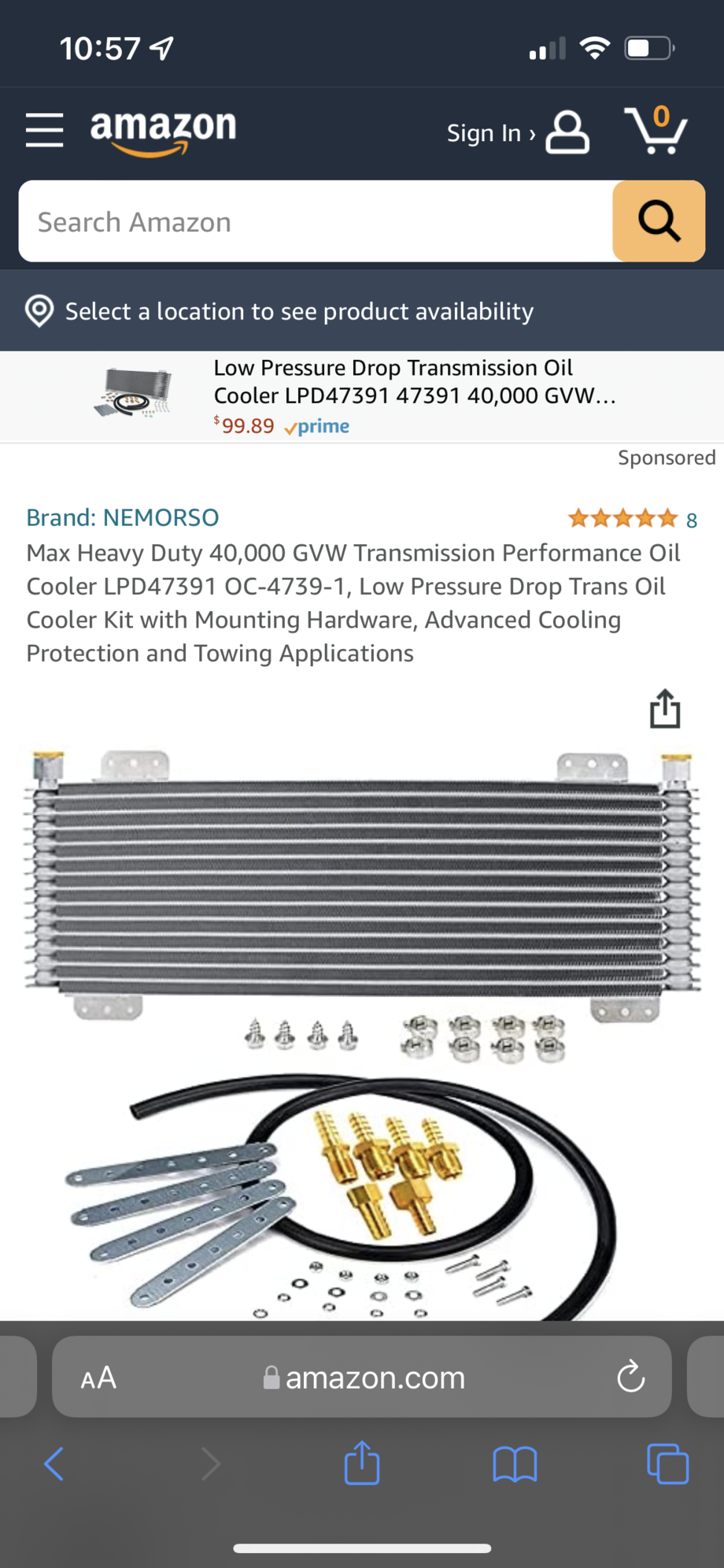

I recently purchased a 2000 stock 2wd with automatic, I tow 10000lbs plus often. I will be adding gauges soon. I know generally everybody does a 6.0 cooler. I happened to see this was wondering if anybody has used something like this.

Not nearly as many rows as the 6.0 cooler, tried and true.

What about running factory plus this cooler a lot cheaper than 6.0
Thats also much smaller than a 6.0 cooler. And won’t be “almost” a bolt in.
Folks I’m sure have done what you’re considering. Could be some extra flow loss by stacking coolers but I’m sure it would work.
When I did mine I used the part store brand 6.0 cooler. Don’t remember the cost.
Leave the radiator cooler in the loop as it provides very efficient cooling of the fluid.

I also don't remember exact numbers, but I think 180 was pretty common. Now, w/ 6.0 cooler it sits at 140 almost all day.
I did an store brand cooler I believe.
I don't think I'd stack the factory cooler and an aftermarket. Just get the size you need. Less connections, less chance of failure.

210°F is not hot at all for a modern transmission. The trans can run at 220°F all day long with no ill effects. You can go as high as 250°F for up to a half hour at a time.
Do not stack coolers. Replace the air to oil cooler with the 6.0L cooler. Having three coolers can cause too much restriction This will cause less cooling than the original, and also restrict lube flow.
