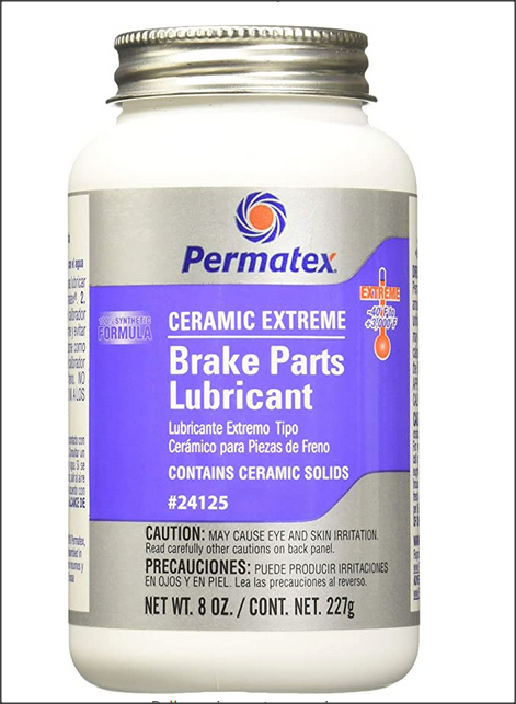

I rebuilt my front calipers recently and used this type of lubrication for the piston seals etc.:
