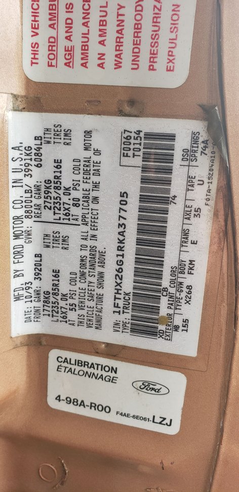

All stock on the front end. Might be chasing a bad bearing issue. Getting a "growl" that goes away when I stop, or turn left. No drive ability issues, no shake, no shimmy. Looked up bearings, they seem cheap enough to just trigger the parts cannon on, as I am sure they are stock. Does the attached VIN sticker help identify what front axle I have? Or is there a tag on the axle I need to reference?

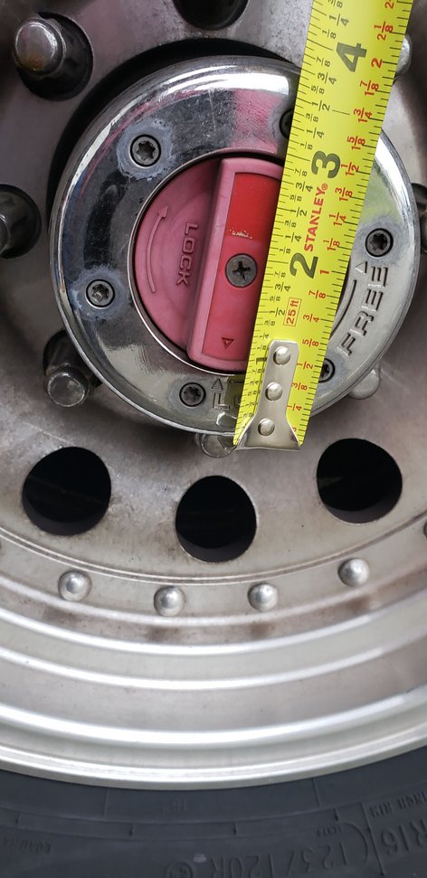

Should be either a Dana 44 or Dana 50 if still TTB. Is the tag still on the differential? How big is the dial for the hub locks? That will help determine which one it is.

To me it looks like a Dana 50.

I thought the D50 was a 4600 lb axle?… not that something else couldn’t have been swapped in at some point. It should be embossed on the bottom of the differential if a D50.

Yes the D50 has a 4600 lb axle rating, but I’ve read that Ford derated the axle for “safety” reasons . My axle is a D50 in a 95’ supercab and my axle plate says 3850# rating .
and the rear axle if Sterling 10.25 was rated at 6,250 pounds , but derated to 6,084 because the stock tires were only rated at 3,042 each.
