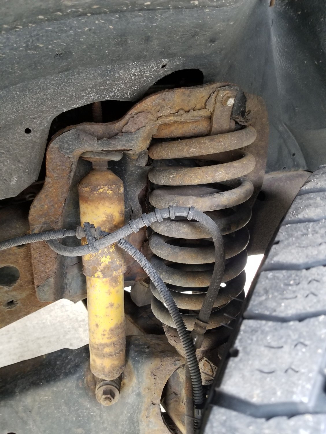

Old Mar 11, 2022 | 01:22 PM
Thekizwalds's Avatar
Thekizwalds
Joined: Feb 2022
Posts: 13
From: Barberton
Front driver
Driver rear
Front passenger
Passenger rear
already planning on replacing the buckets, and as someone else told me to check the manifold bolts while I have it apart, and see if I can replace the windshield wiper fluid reservoir because I'm very sure it cracked during the winter.

Before you go too crazy fixing things I would take a small hammer and go around and check the frame. That has a lot of rust on it. It looks like it was undercoated at one point also, which if not kept up and touched up can trap moisture under the undercoating. No point in going to crazy if your frame is suspect. It might not be limited to just the spring buckets. The springs themselves do not look to be impacted by the rust.
It also looks like your rear diff is leaking
