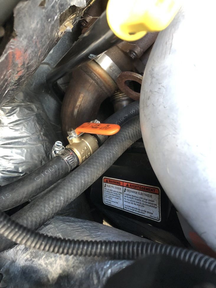

An alternative to this convenient cooler AC mod - you could use a manual valve in one of the heater hoses. On my superduty, I used a 3/4 Pex valve. Fits the 5/8" ID hoses just fine. I'm assuming there's a way to do this on the OBS trucks. It's simple, just have to get under the hood twice a year to move the handle. Only really needed on the hotter summer months. Where I live, I swing it in July, and back open in September.
Did you tee the hoses to divert the fluid when you close the valve?

I did not. The fluid is just stopped through the heater core.
