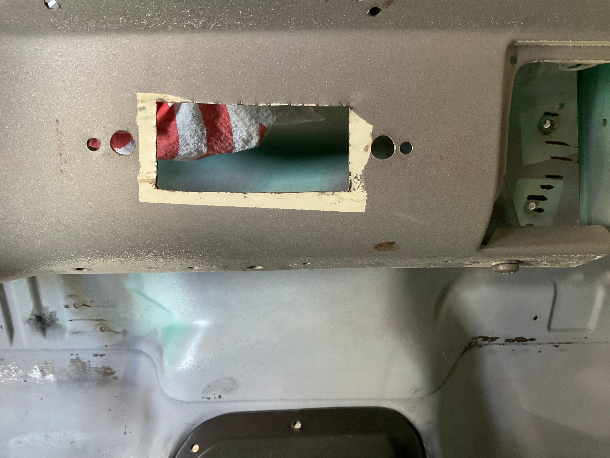

Good morning, My 65 F-250 custom cab dash has been cut to fit a more modern radio. I can mount the original back in place but can just see some of the hole exposed. Is there a template out there that I can get so after I fill in with new Sheetmetal I can drill the proper holes in the proper location for the original radio? Thank you.

Yes, I did search and did not see a diagram, however, upon further review of those post and dry fitting my radio it appears I need to patch the square hole with the appropriate thickness metal and then layout and drill the center hole for the radio light since the smaller holes drilled on either side fit the stock radio. Those holes are also not deburred on the inside so the radio was added by the dealership as noted in some of the older post I searched. Thanks for the reply!

You are correct. Don't fill in the 4 that are already there. You need them. Just fill in the sqaure and then between the 2 big holes exactly centered drill a 1/2 inch hole. That hole is for the light bulb to protrude thru to light the face.

Here is a link to a thread with a sketch showing OEM radio hole dimensions..............
originally posted on slick60s by Brian, aka: ICEMAN6166
Slick 60's ? View topic - radio dash hole size and placement dimensions

Thanks for the help on this one. I think it turned out OK.
