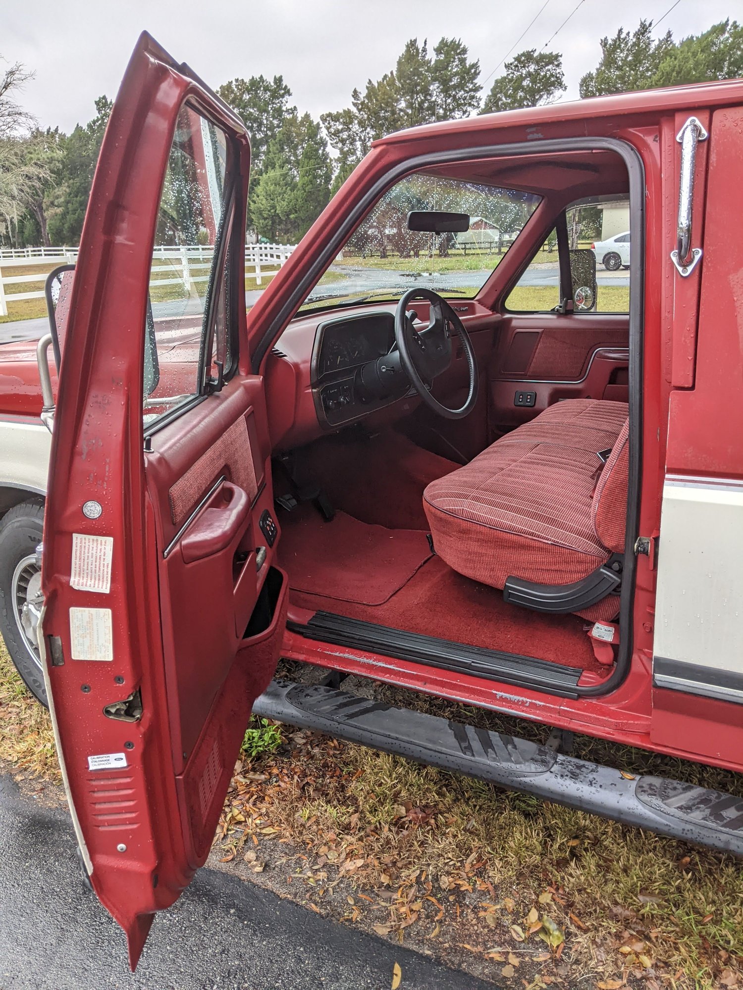

Just getting started on my new to me 1988 F-350 Crew Cab Long Bed 460 C6. It's a California truck with absolutely no rust. Had a stalling issue, fixed replaced the fuel pump relay (was only outputting 4.2 volts), and replaced a failing distributor mounted ICU. Will be remote mounting this.
Also converted the cargo lamp to a third brake light. Easy conversion and the new one is brighter than the regular brake lights.

Clean rig! Especially that interior, man that's nice. I did the same brake light conversion on my dad's truck.
