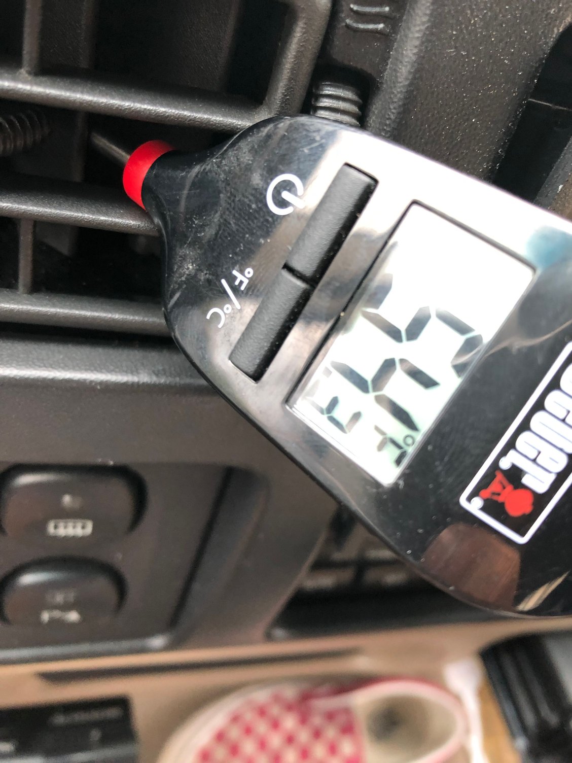

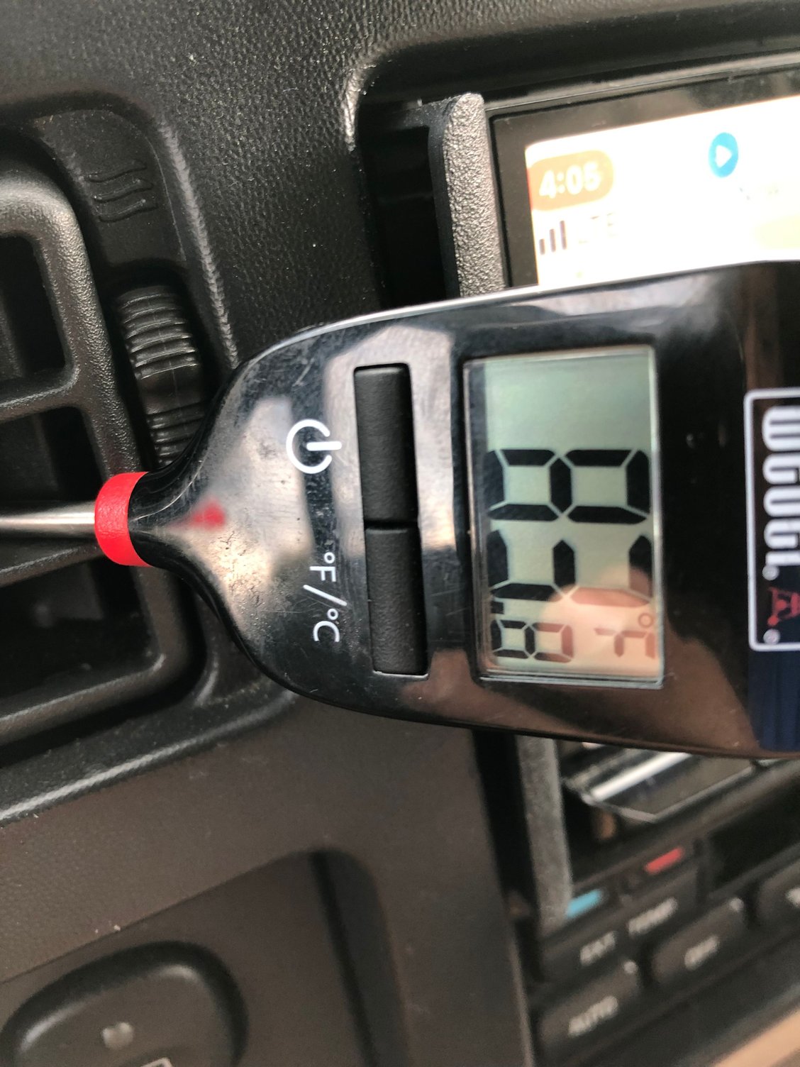

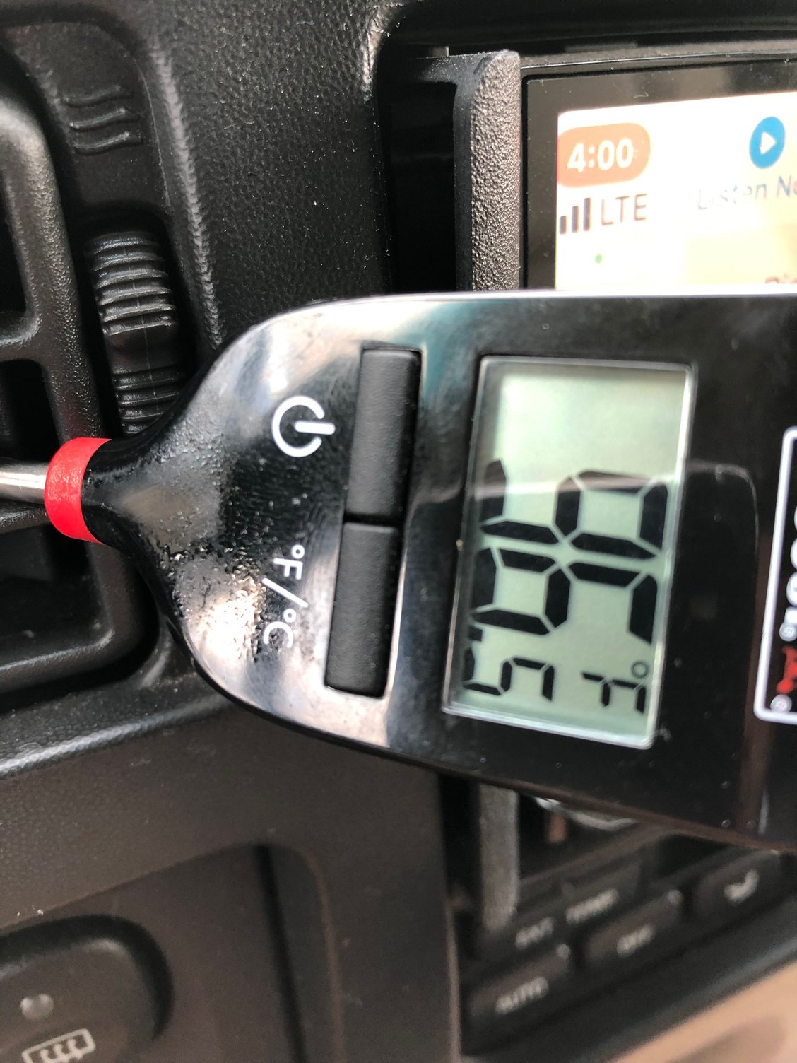

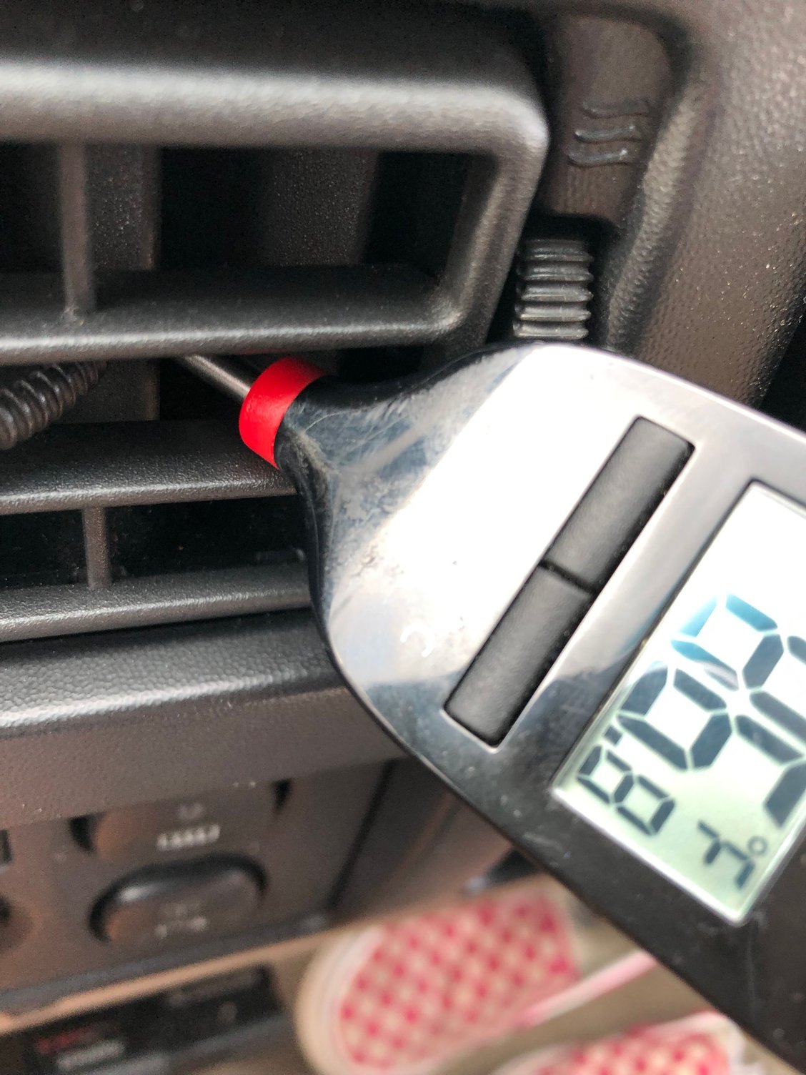

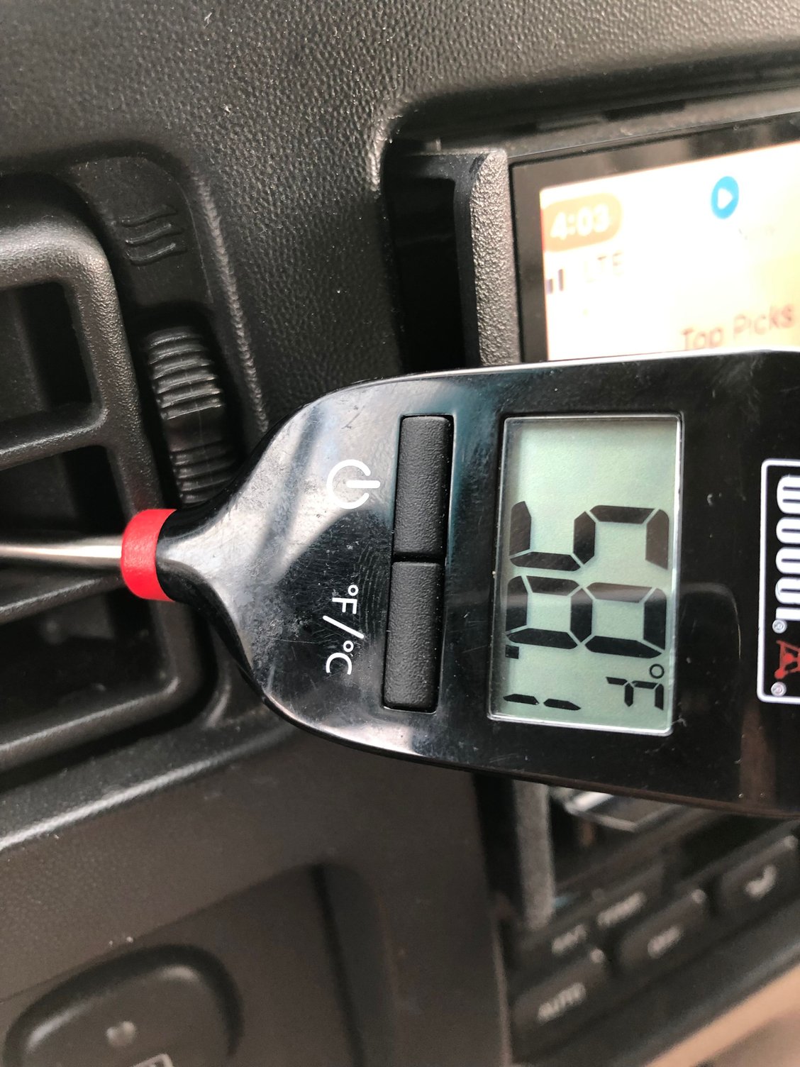

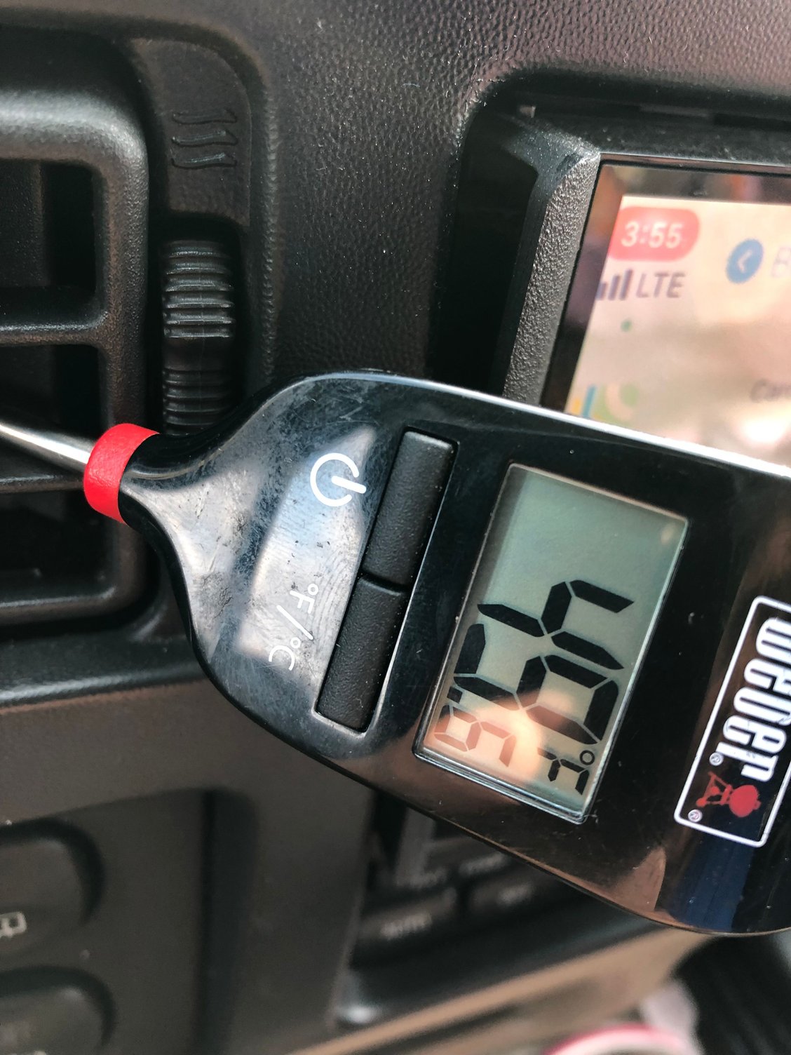

So I’ve finally gotten to test it on the road and I’ve found some interesting things. At idle the ac reads about the same from 60-69 at around 50 or below but 70 changes it to be at the 80s and climbing when I had taken the photo. When driving setting it to 60 while going 45 and it still read at the 50s and dropping but anything above 60 at 45 made it go up to the 80s and climbing.
69 setting at idle and it was dropping after the photo was taken
60 setting at idle
90 with ac off, climbed to 100 or so then I turned ac on again
65 at 45 mph, climbed after too
70 at idle and it climbed after
60 at 45 mph and it held pretty steady at that point dropping a little bit after
