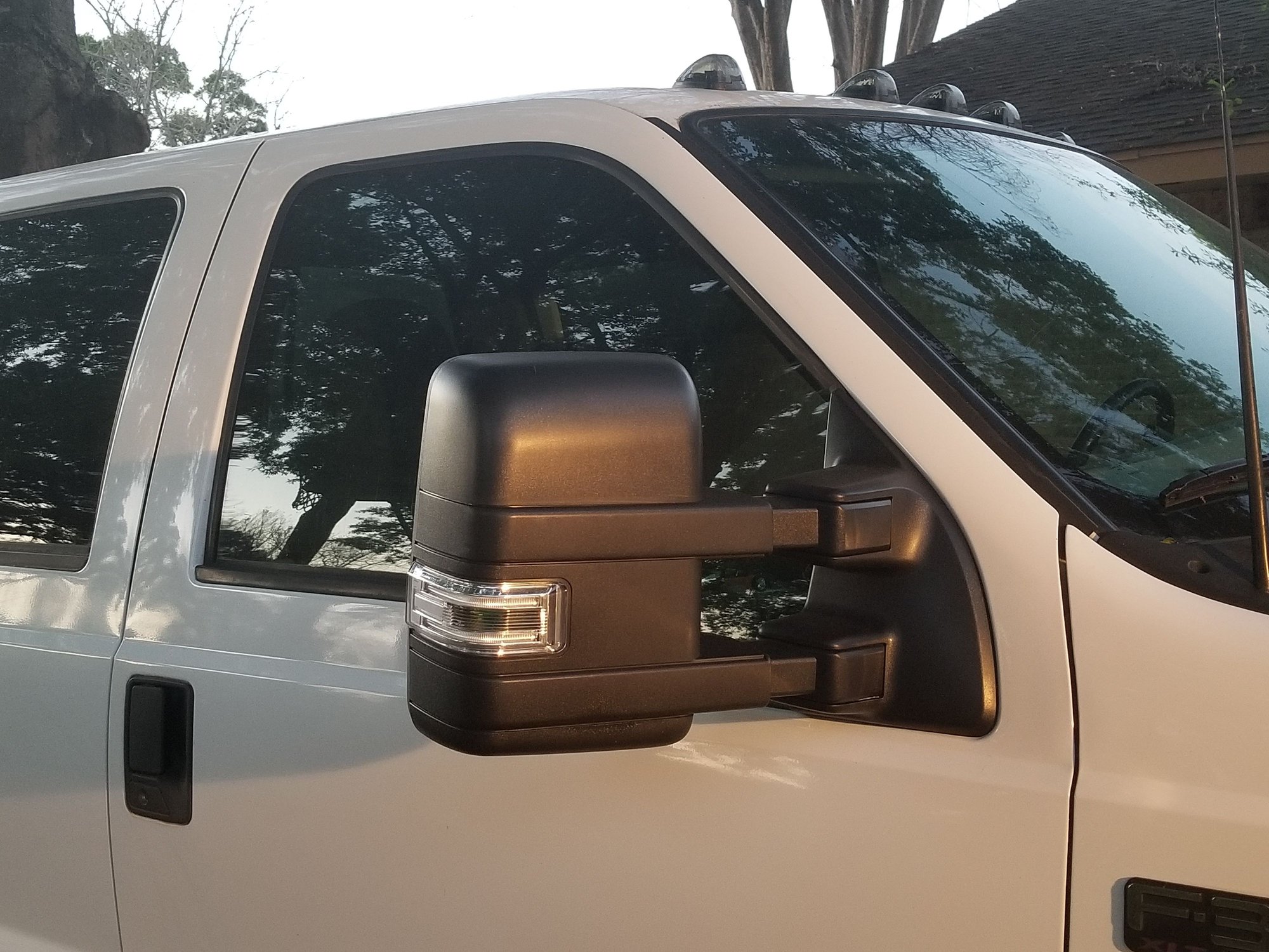

No, the newer oem 2017+ Ford mirrors will not fit an older truck. There are aftermarket mirrors that have the correct mounting surface base with the newer mirror housings which work. I installed some aftermarket AERDM 2008-2016 style mirrors with the 2017+ style lighting on my F350 CC 4x4 several years ago and have been happy with them. I'm wanting to install the 2017+ style mirrors on the wife's 2wd Excursion when I can find some I'm happy with. I've seen some of the AERDM units come with the side spot monitoring symbol below the defrost symbol, and some not have them. Obviously that would be a harder option to get to work in our older trucks, and it just takes up real estate of the mirror.

Thanks, I don't think they are making them anymore as most aftermarket companies are producing the 17+ style with the slant top corner, which has the correct base for our older trucks. I would go to the AERDM website and contact them to see if they have any spares or could make up some. The units for the F150's may work, ask them. When AERDM started producing the 17+ style with the slant top corner, they didn't have the side spot monitor symbol below the defrost symbol...which would be a pain to make work in our older trucks...that just takes up real estate in the mirror surface. I went back to get a pair of those for the Excursion early on, but saw that extra symbol and decided not to.

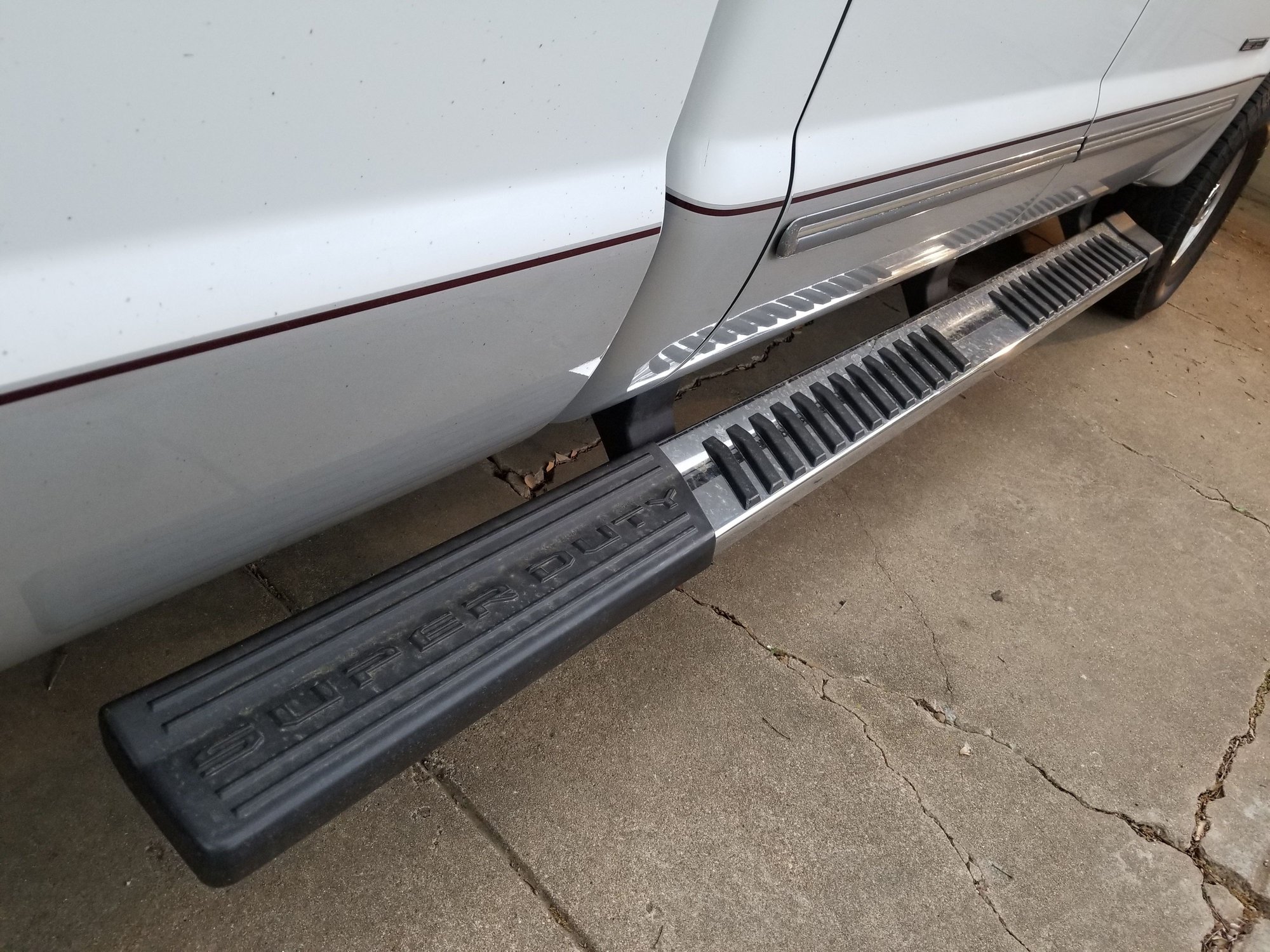

Just noticed that's an old picture from when I installed them several years ago. I've since added newer 20+ extended length Superduty side steps and 04 18" wheels wrapped in 295/70/18 Mastercraft Courser CXT tires...

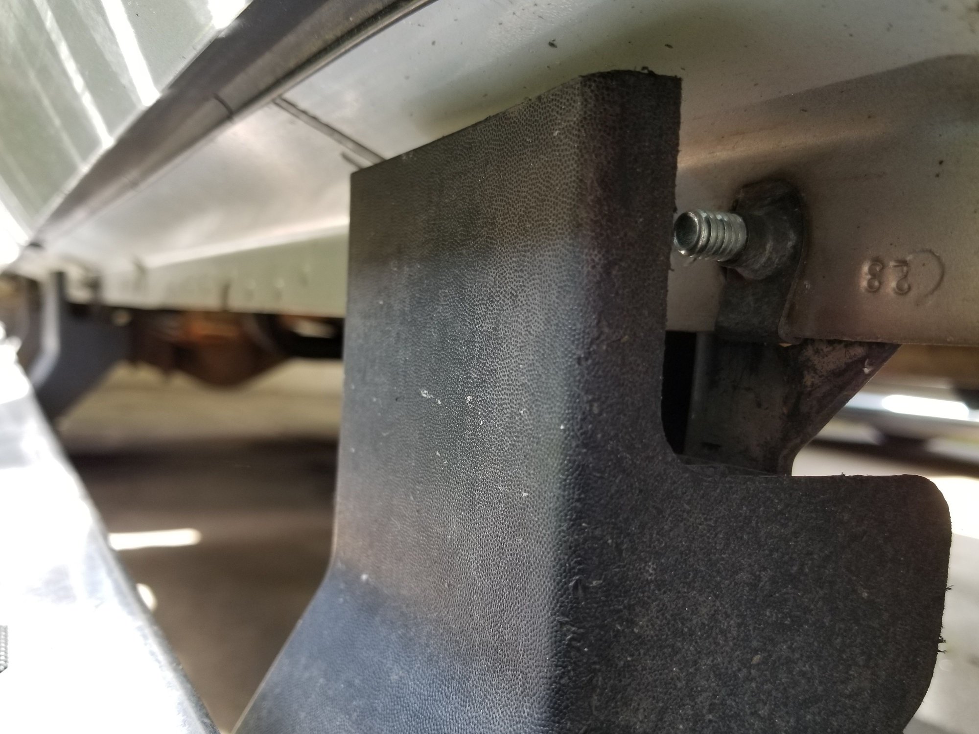

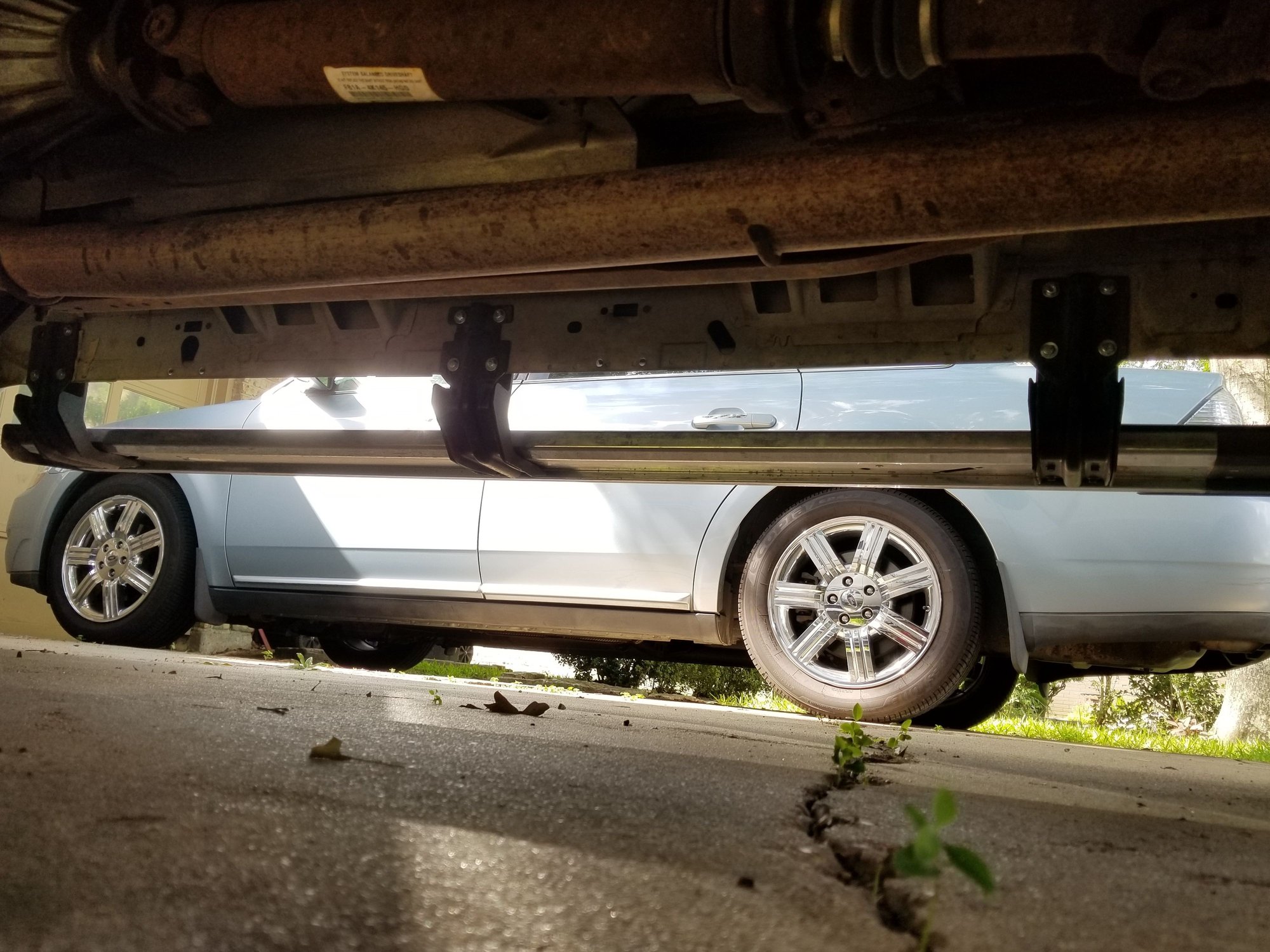

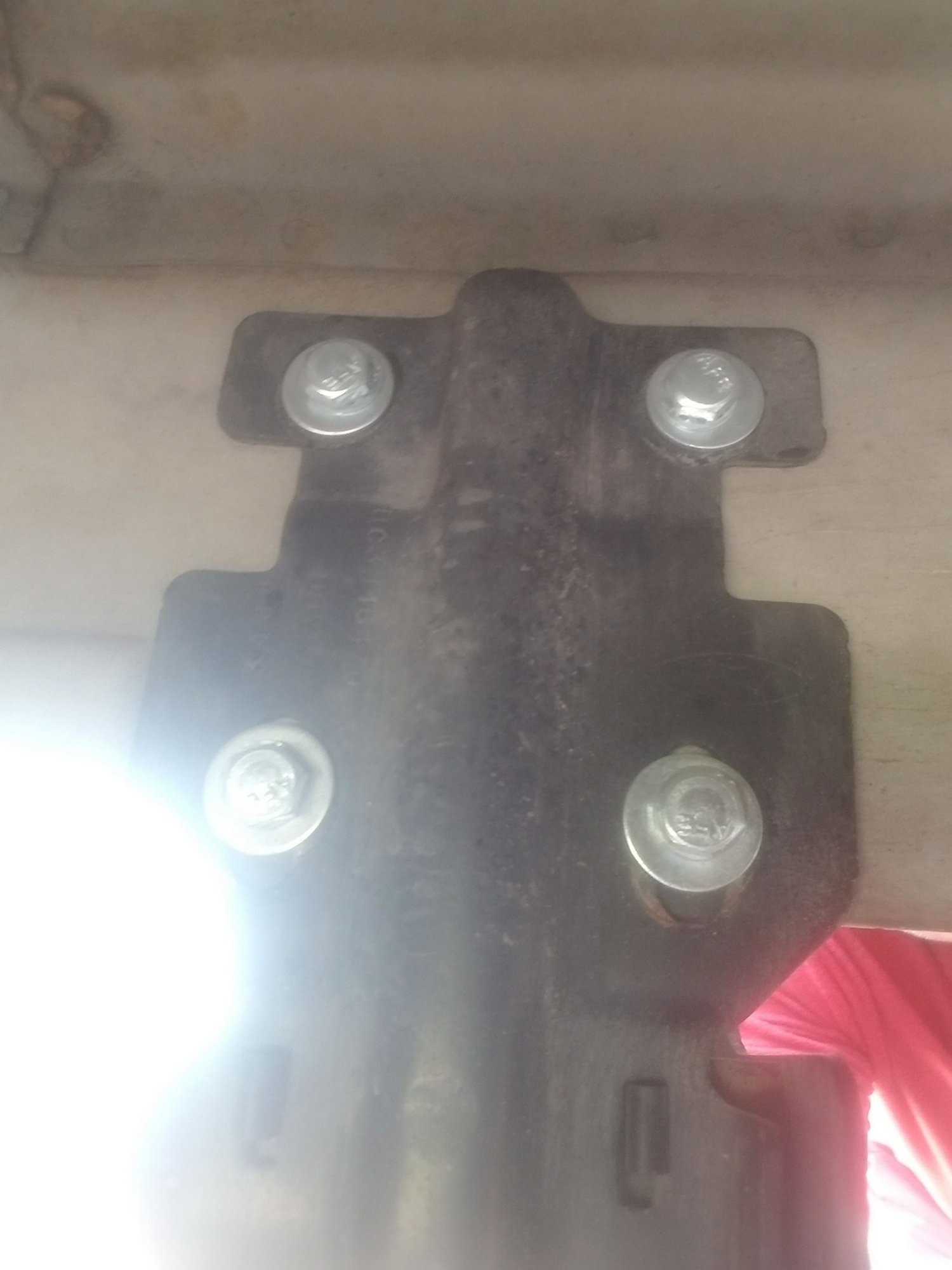

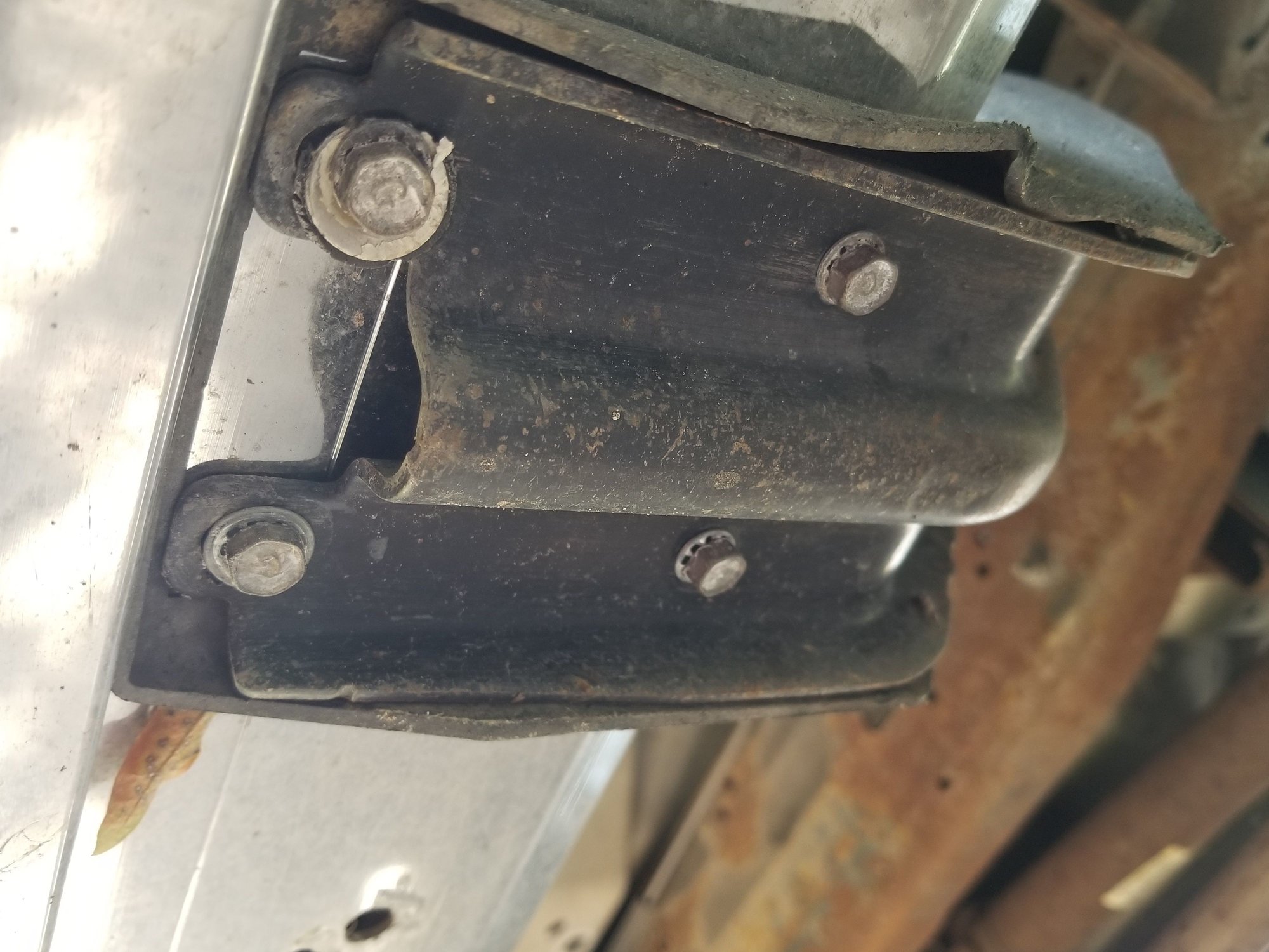

Very nice! Any pictures of how you mounted them? I have a set of the regular size SD boards ready to go on my X, after I fix rocker rust. My plan is to use riv nuts and run them in the flange of the rocker at the bottom outside in and inside out at the top of the bracket.

I used the existing holes in the truck to mount the 3 05+ mounts/hangers per side with 4 bolts instead of the 3 like came from the factory...the Excursion has 5 mounts per side from what I remember in looking at the wife's Excursion. Once I mounted the hangers, I laid the boards on them, made some adjustments, and clamped them in place. I then ran some self-tapping screws with washers up through the existing holes of the hanger mounts into the bottom of the boards...been rock solid...

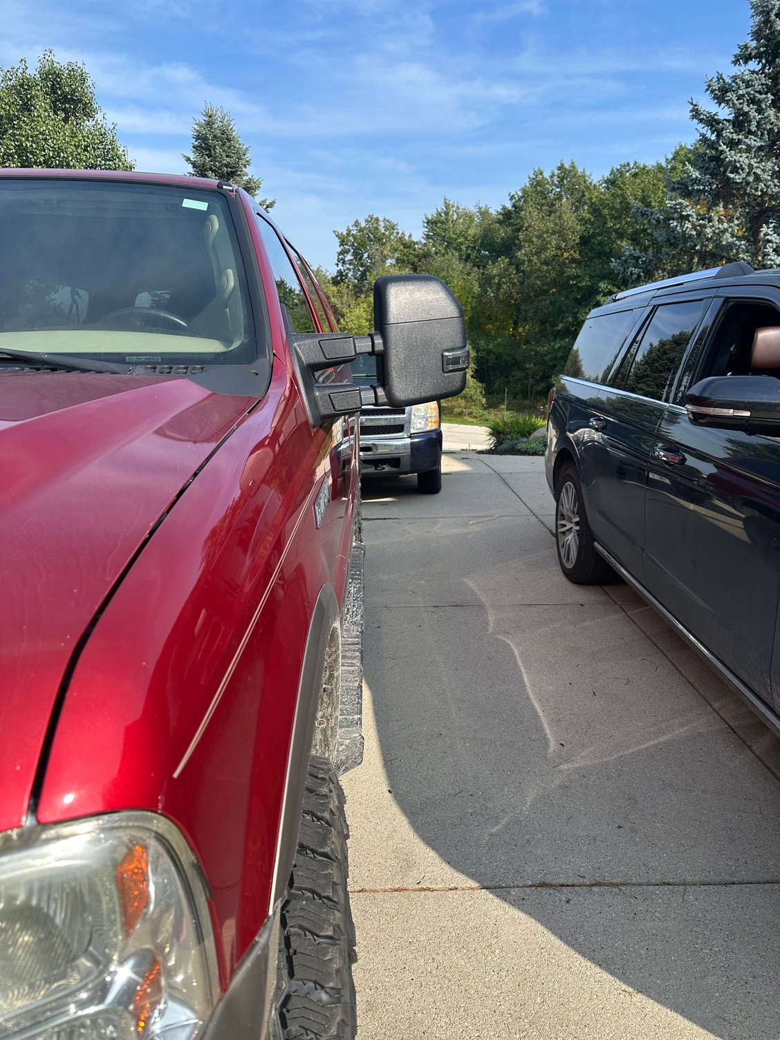

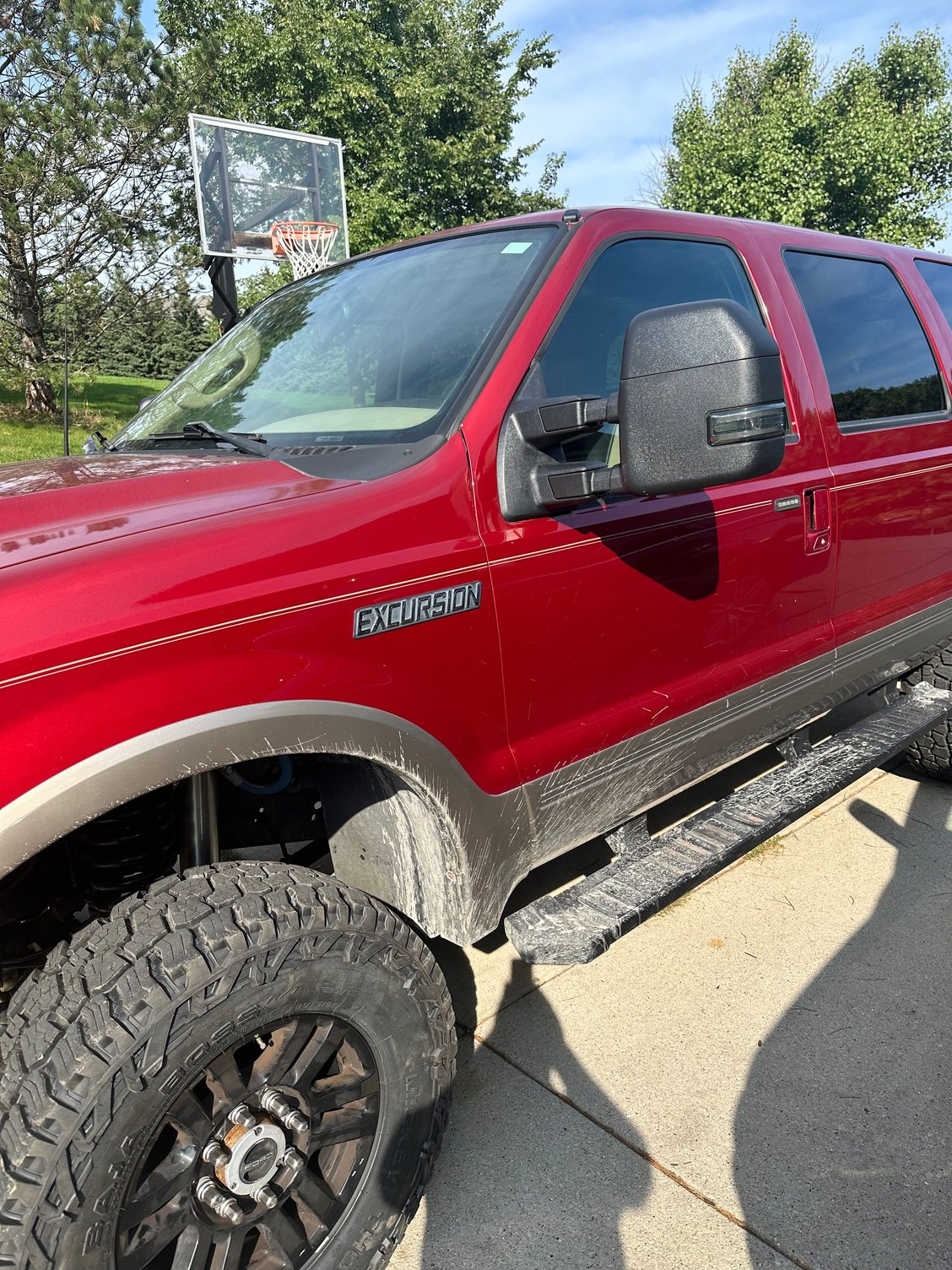

I have the boost mirrors, couple pics for you…

Those look real nice! Appears that they angle upward, is the glass also angled or did they account for that when they built them so that the glass sits level?

They accounted for the angle with the glass mounting. While they look nice, and they are pricey, I wouldn't get these Boost (brand) again. I have had multiple issues in less than a month of buying them. Mine have the heaters on both top & bottom. It keeps blowing the 5A. I've tried multiple switches and yet it blows it rendering the power adjustment useless. I've also had to get replacement glass as the quality was bad and I would get squirmy images. OTOH, their Customer service has been helpful, though they are pathetically slow in their responses.
