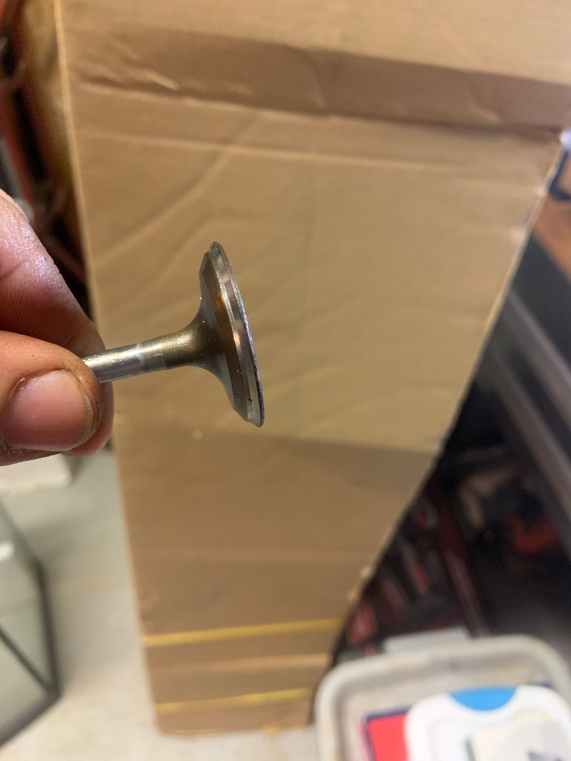

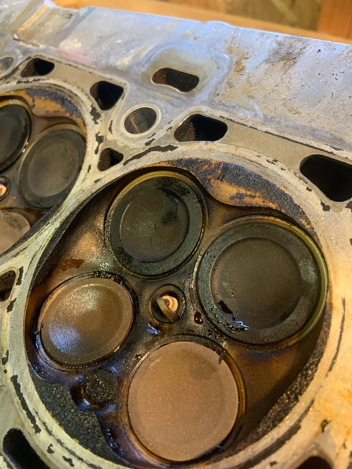

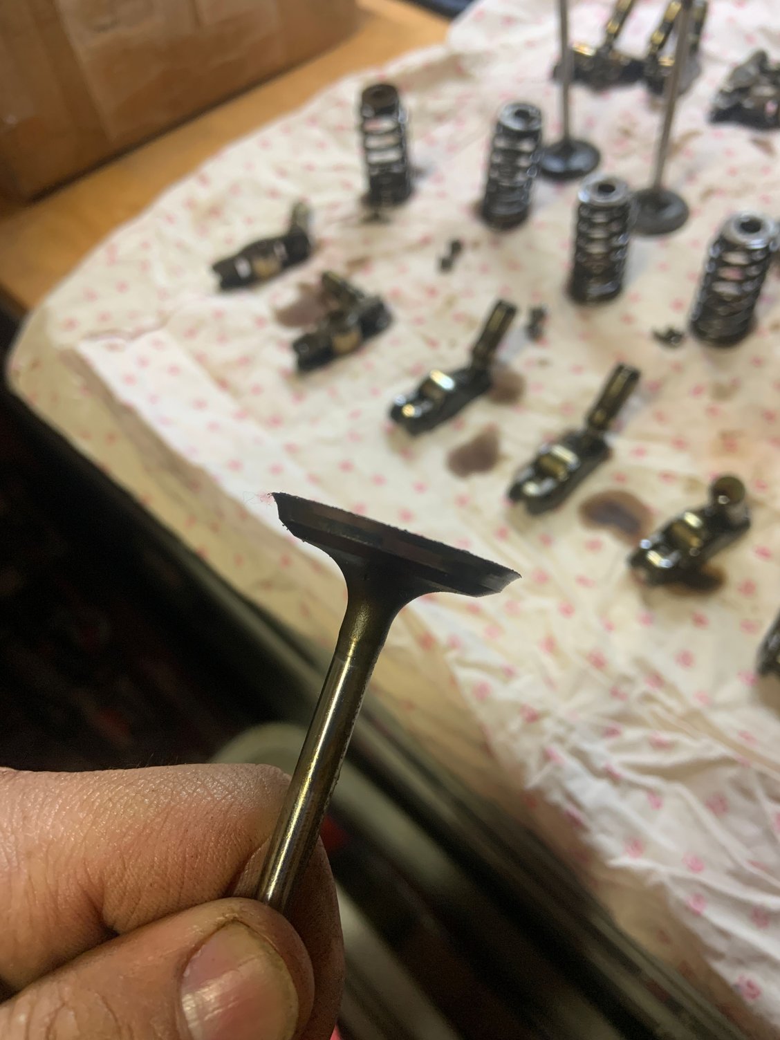

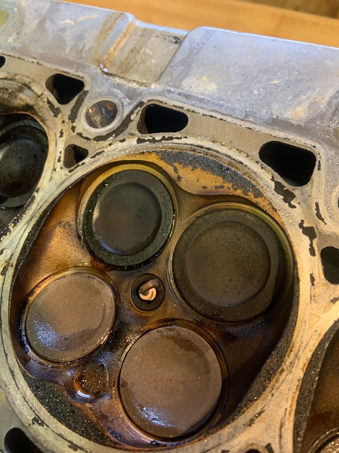

Tuliped intake valves in the 7 & 8 cylinder. That was the main culprit and there was a small head gasket leak between same cylinders. Head and block checked straight. Got new Melling intake valves so I’m going to lightly lap them all back in and put it back together. Got a new Melling high volume oil pump and new timing parts to go in it.
#8 recessed in quite a bit
Mostly normal #6 valves seated.
#7 becoming recessed and worn
#8 valve that was recessed in the most. Note the razor edge that is not supposed to be like that.
Fairly normal wear on this valve as compared to the #8 valve.
