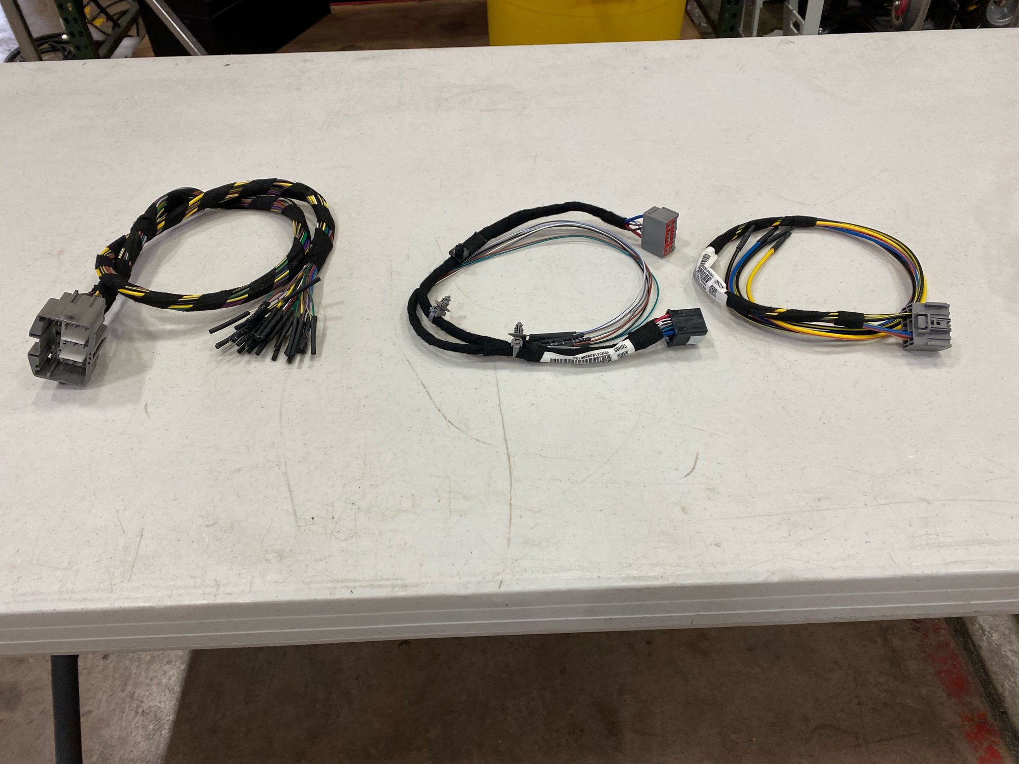

I’ve found a complete lack of information about the Upfitter system. I work with a fleet of 8 SD’s from 2007 to 2022 and 2 Transit Vans, all with Power Strokes. Several of them came with wiring harnesses in the glove compartment, none have any info on what they are used for or even where they plug in. Can anyone point me in the direction of where to find this information? Thanks

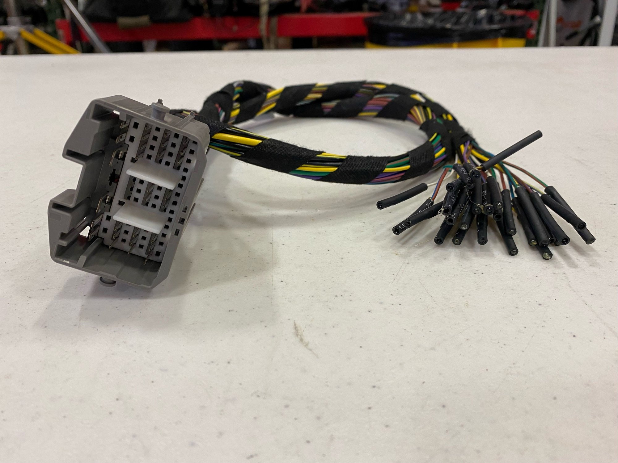

I have no idea about “harnesses” in the glove boxes. Can you post pictures?
I hope you’ll share the results of your application projects!

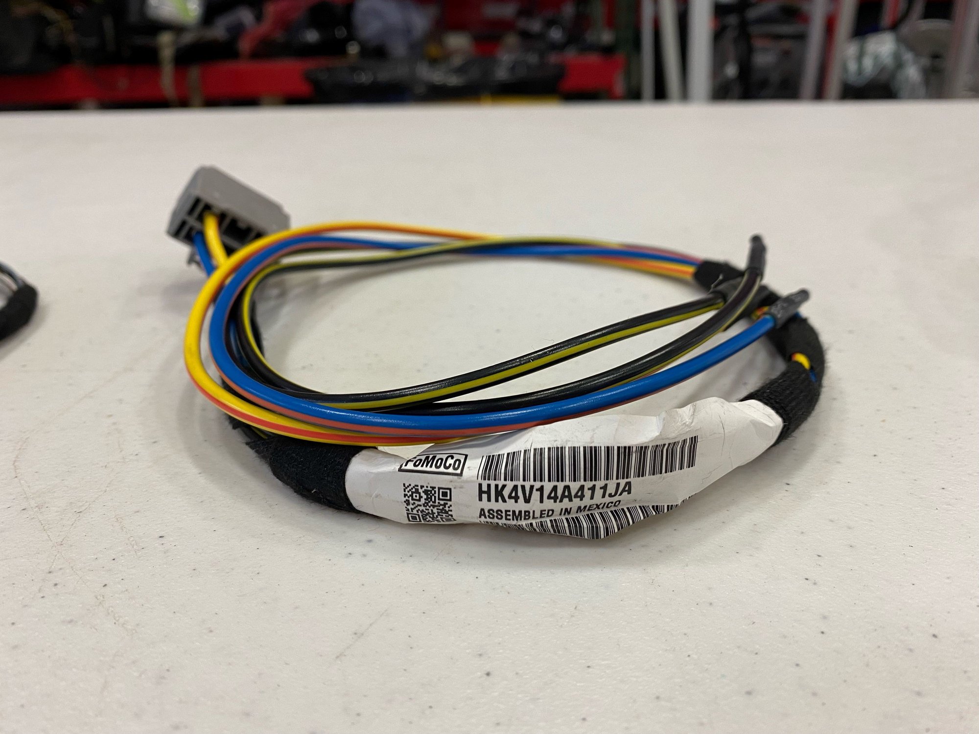

Update: See page 135 in the Transit manual for information on Accessory Kits, including harnesses.

In our 2019 Transit vans.
In this bag was,
Old Mar 1, 2022 | 08:28 AM

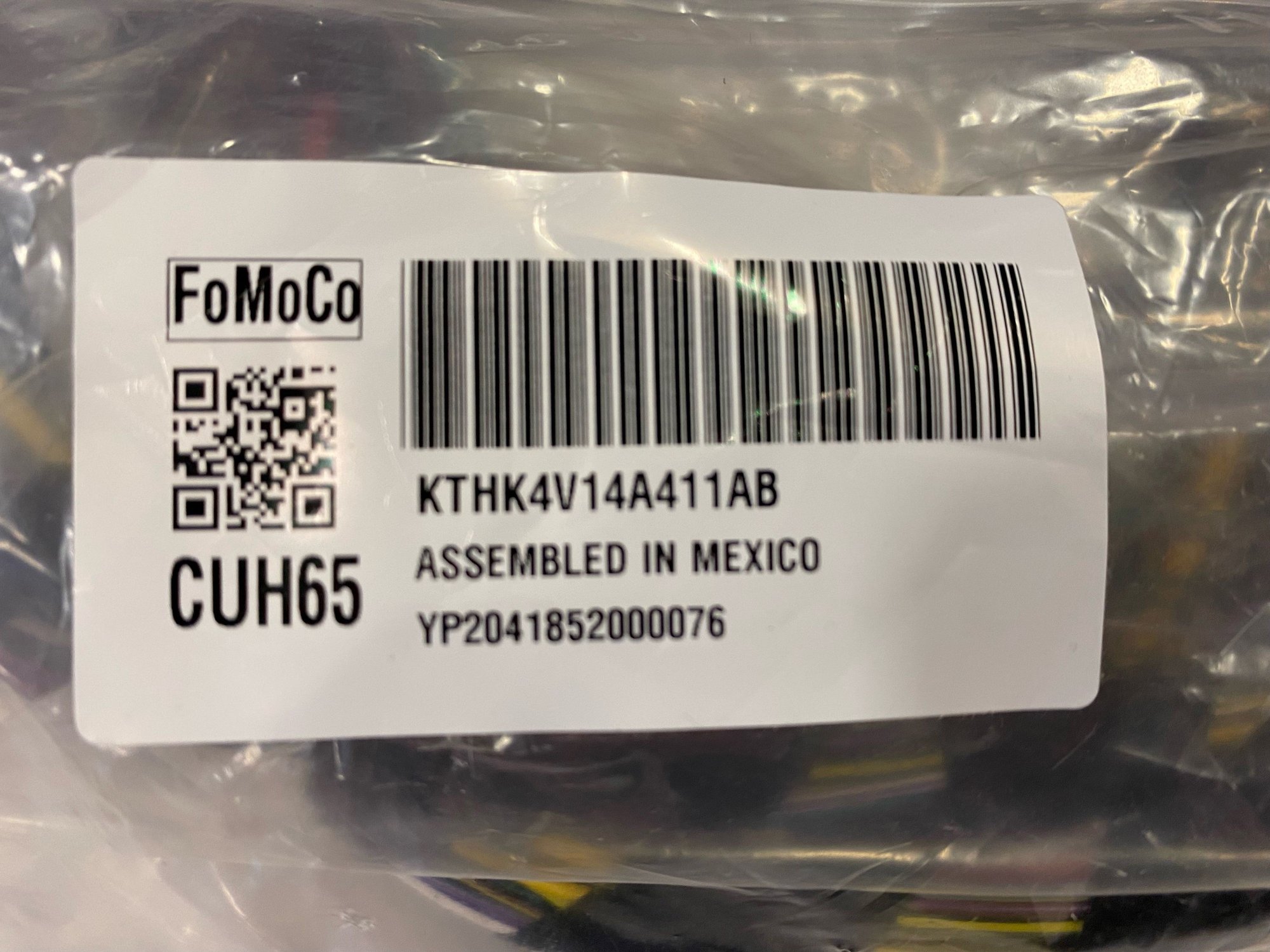

In our just delivered 2022 F350,
Old Mar 1, 2022 | 08:31 AM
Hank Harkey's Avatar
Hank Harkey
Joined: Apr 2020
Posts: 9
Pics added, Thanks for your help and interest.

Here’s a link to the 2019 Transit Body Mounting and Equipment Manual:
https://madocumentupload.marketingas...1318f&v5=False
The Transit harnesses sure look like the ones described in the manual’s “Accessory Kits”; see 2019 Manual pages 136 and 137.
You should be able to Google on the harness part numbers to confirm / get more application info.
