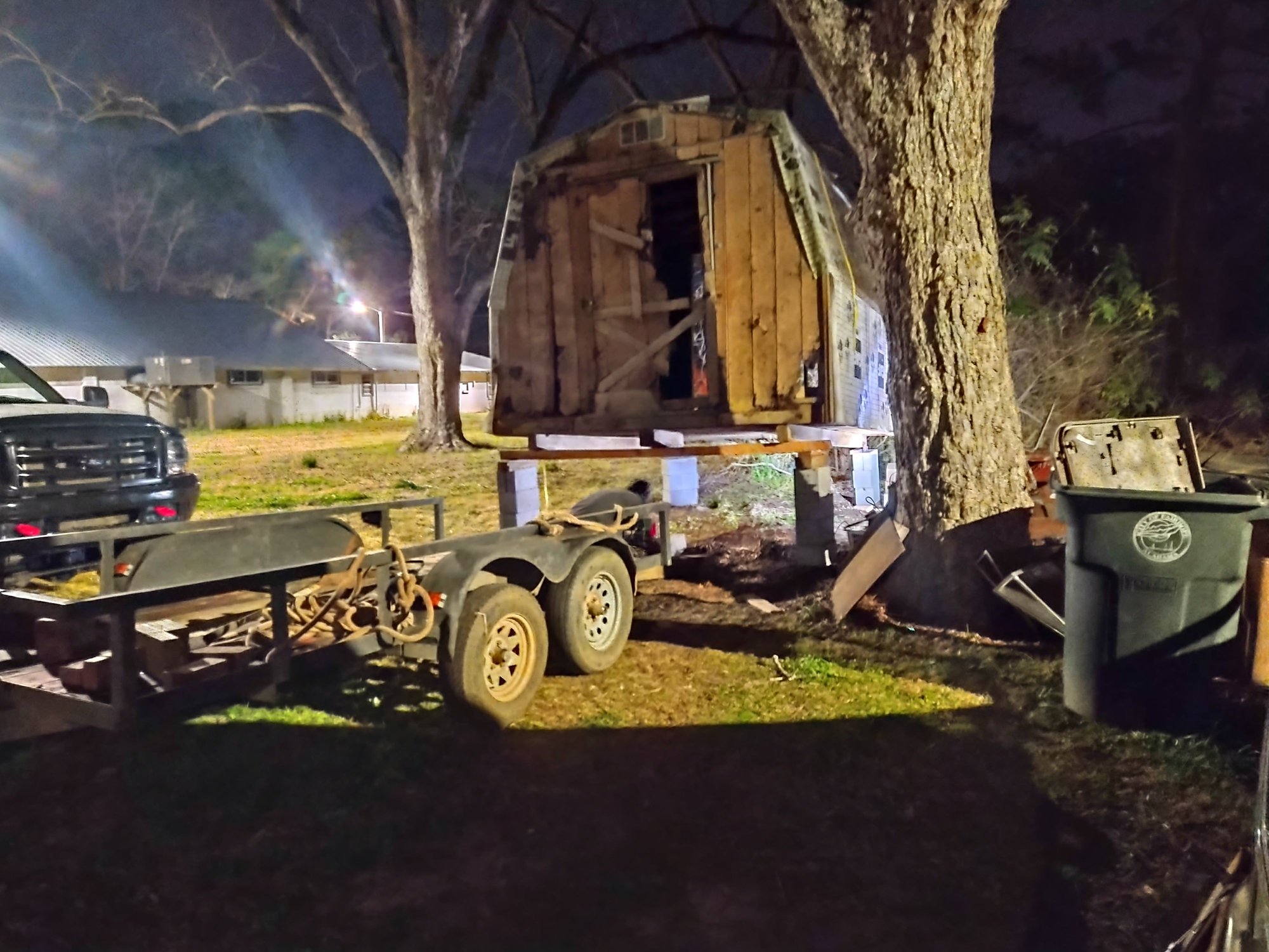

Now, as for how I blew out my three and a half ton jack. This doesn't have much of anything to do with my current issue but, I figured I would share it anyway for some laughs maybe. What I was picking up was definitely not overloading it but, the Jack was getting old. The local guy that saw my truck and phone number, the one that called me to fix both of his 7.3's, was selling a property that he owns and had a shed in the backyard that needed to be moved. All of the bones on the inside are in great shape. The front and back walls got damaged from a hurricane or something but other than that, the sides and all of the frame and support we're in great shape. He said if you can get it out of there you can have it. So, being broke and shedless like I am, we took my Jack and a bunch of cinder blocks and my 12x6 utility trailer..... Talk about sketchy. I did not know anything about moving a building like this but, my dad said he's done much worse and he is the only reason we were able to get the shed. It was still sketchy. As it has been, all of my weed eaters, edgers, blowers, and chainsaws had to go in the house because I had nowhere to put them. So, even though the shed wasn't in the best shape it was an opportunity to clean out the house.
Anyway, When we were unloading it at our house it actually fell off the cinder blocks and landed on the ground and, this reassured me on how sturdy it was because it didn't hurt it much. Anyway, here's some pictures on the shed that blew out my Jack..... At least it didn't happen while the shed was in the air or my truck was on it.
We ended up borrowing a bottle Jack from one of my buddies to finish the job as you can see in the photo.
It was shortly after this that it fell down. We had gotten it down to three blocks high when it fell. Actually, we were letting the front down to the three block mark. It may have been actually two blocks on the front we were letting it down to, I don't remember but either way, we were trying to let the front end go down so that it was level with the rear, and it started going, so we moved out the way. luckily, the shed landed right close to where we wanted it. We will just stick with the "I planned that scenario before I kicked to the shed over" technique.
