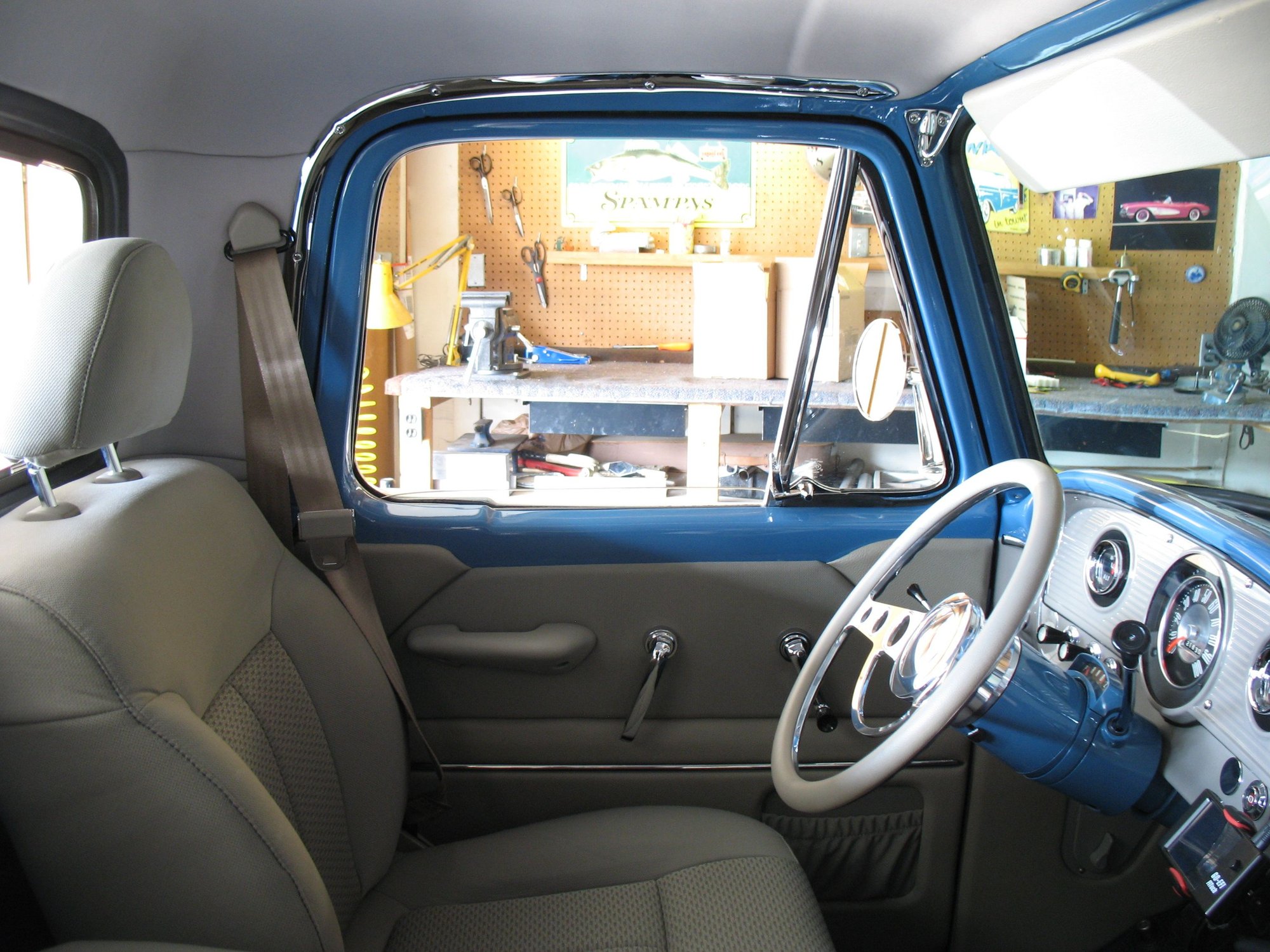

I’m not sure this answers your question because you said “rotate up towards the dash” and also mention the distance from the dash lip to the wheel/driver. These are two different dimensions in my view. I did use a 78 tilt column and took 4 inches out of the 9 you mention. I had to shorten the column tube, the shift tube and the steering shaft exactly the same amount, while keeping the orientation the same. I would advise against welding the shaft. I shortened my shaft by cutting off the splined end and having a machinist mill it to a double-D then using a matching U-joint. I also used an after market steering wheel and adapter. The adapter was taller than I wanted, so I had to cut it down as well. I’ll post pics later today. I appreciate the additional distance away from my chest, particularly since I used seats from a 2010 F-150, which are thicker than the stock bench.

Here are a couple pics of the 78 tilt column, similar the the one used by Lizardman. I could only take 4" out of the length because that brought the collar right up to the dash. I lost a couple inches in the steering wheel adapter but gained some back due to the steering wheel having a smaller diameter and less "dish" than the original one. I'm still not understanding the "rotating up" part of the question, because the column is already contacting the underside of the dash. Anyway, I hope these suggestions help.

But, in response to your photos above? I don't know how you did it, and how much time it took you to dress out the cab, but your cab interior and what others are able to do here are show-worthy.

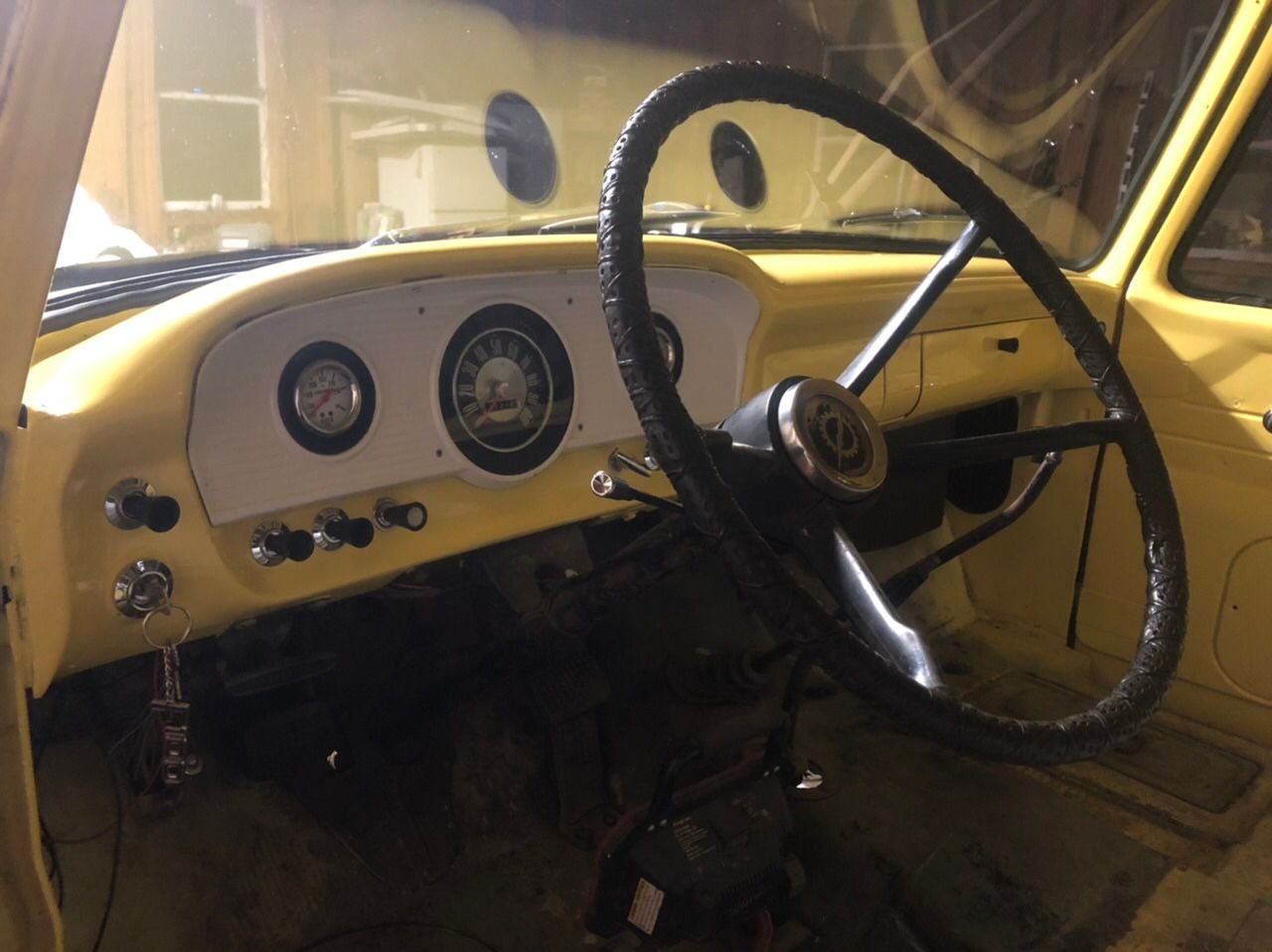

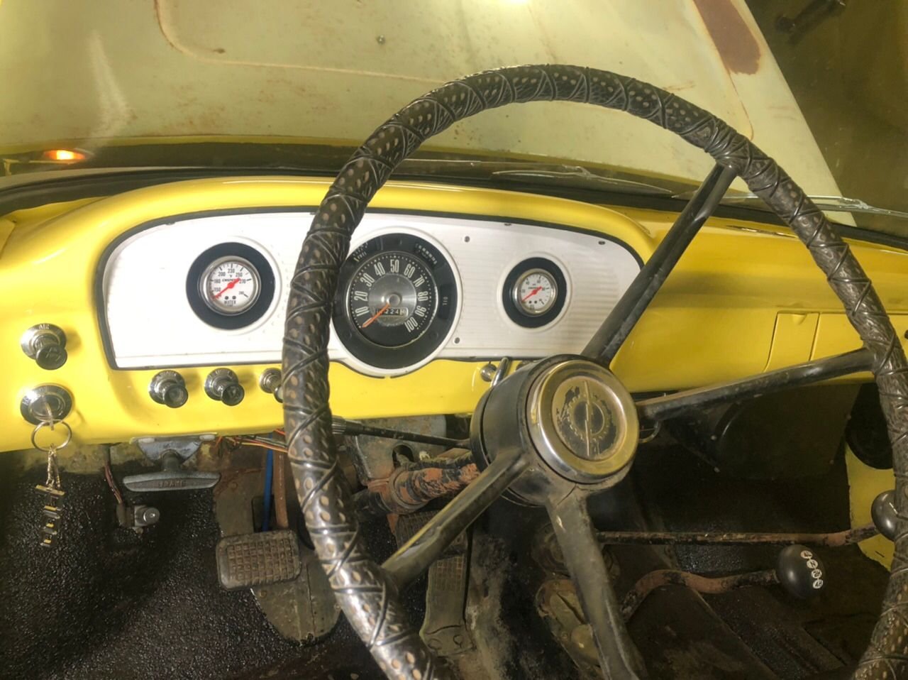

Your good, that is my exact point. Until now and seeing the above pictures, I did not realize my 4x4 with its 3-4” bracket between the dash and column may be 4x4 specific? The pictures above have no space between the dash and column.
Here is mine with the bracket below dash and 18” stock wheel.
