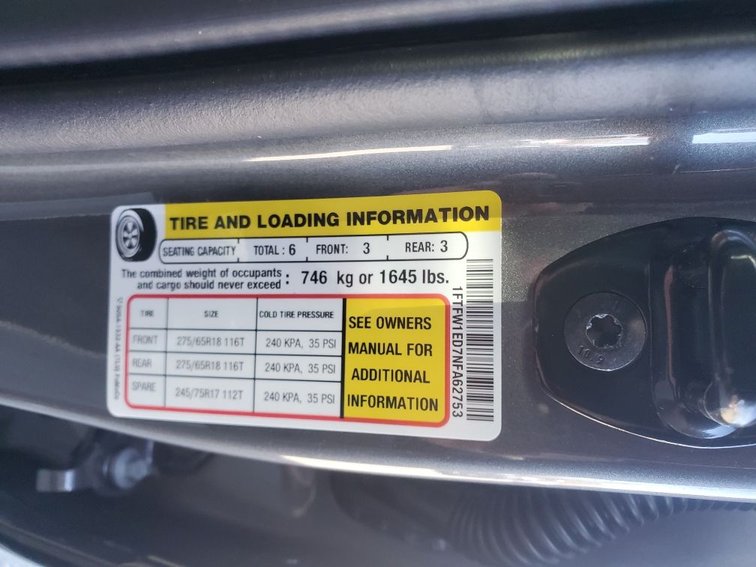

I have a 2022 F150 Power Boost. Attached is a shot of the Yellow Loading and Tire Info . As you can see, I have a relatively high (for a PB) 1645#. Also attached is the window sticker. Ignore the (almost) fictitious number found in Ford's Tow Guide. Just find the yellow sticker. It will tell you all you need to know about what your truck will carry. When I was ordering my PB, I was very judicious in selecting options I wanted but didn't carry a large weight penalty. And example is the moon roof/sun roof. My truck has the 6.5' box and 4x4.
Thanks. All very helpful information. I think I'm realizing that for my truck the payload is likely going to come in below 1,400. So I need to do some soul searching and decide if I want to go with something that has "just enough" capacity, or want to scrap the whole order and start over with something that will have much more than enough. I really want the hybrid and all its features and the big issue is that my wife fell in love with that specific model. Decisions, decisions...
