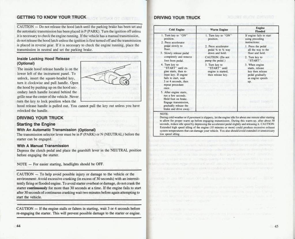

In the cab on my truck the handle has a key in it. if you lock the key it locks it into the housing and can't be pulled out.

Yes you have an OEM inside locking hood release.

I ended up going with the OEM locking hood latch. I bought a wafer set and rekeyed it to my ignition. Just about ready to install it and was wonder how the factory routed the cable? I can see several ways of going about it but the engineers at Ford likely did it a certain way. If anybody has pictures of the OEM routing I would like to see how they did it!! Thanks!!

I found the instructions on this site, it was in two documents so I condensed it to one.
