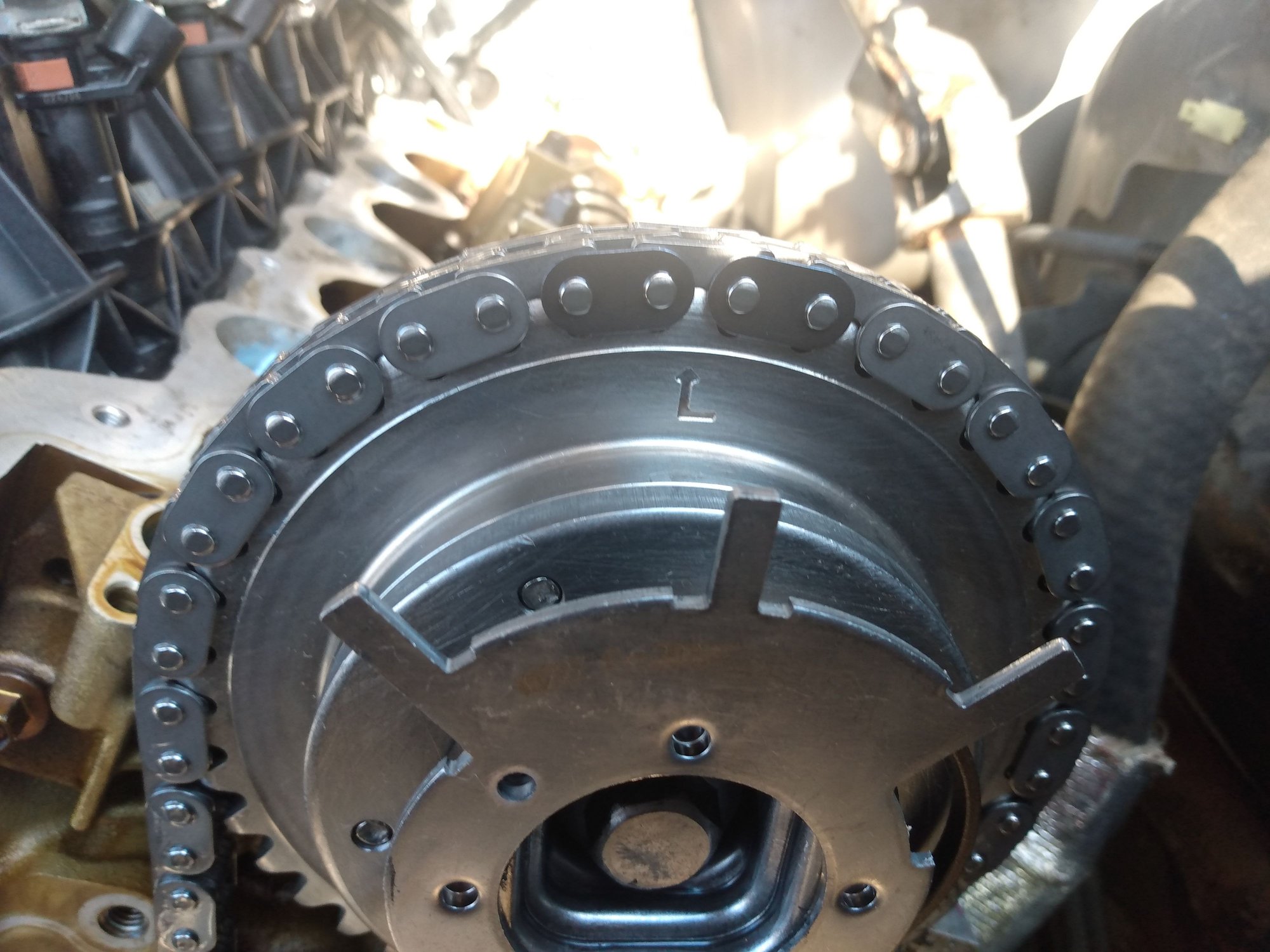

P0340 after Cam Phaser install
Ok so I just did cam Phasers on a 2008 5.4. Truck runs great, no issues that I can tell, but is throwing a p0340. Any ideas? I DID accidentally put the phaser marked "L" on the Passenger side and the phaser marked "R" on the drivers side, but i heard they are universal and the L and R marks are in identical spots so it doesn't matter, correct>?

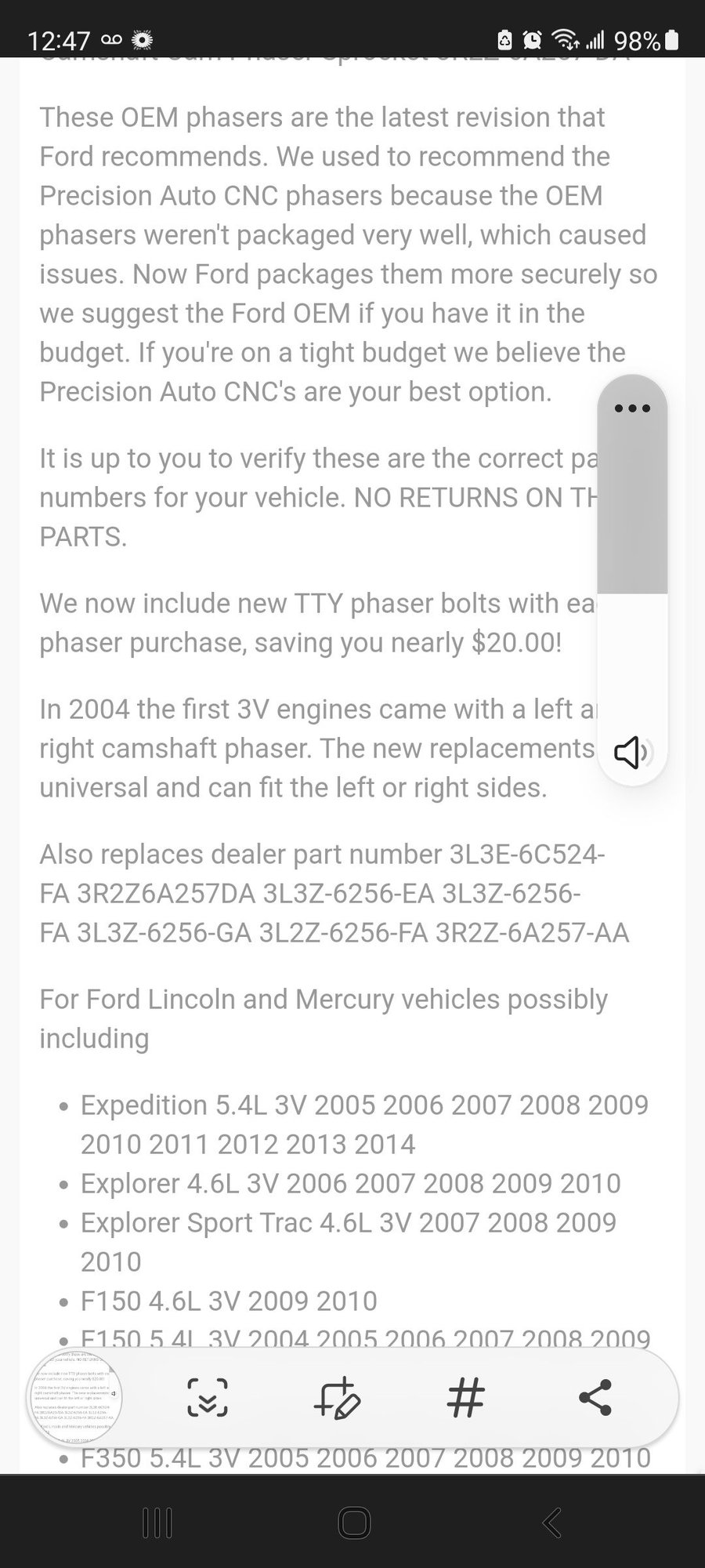

Originally Posted by Johnny Paycheck
Wrong. L and R are there for a reason.
This is a screenshot from the product page and it pretty clearly says they fit either side. And I've seen that with multiple different ones of these, so if that's actually not true, I need to know.
Old Feb 20, 2022 | 07:55 AM
redfishtd's Avatar
redfishtd
Joined: Apr 2016
Posts: 1,653
Likes: 193
Phasors are dual marked there is no difference. A long time ago that was not true. If you look at them now each will have both markings .They are 180 degrees from each other .

You use the letters to set time.

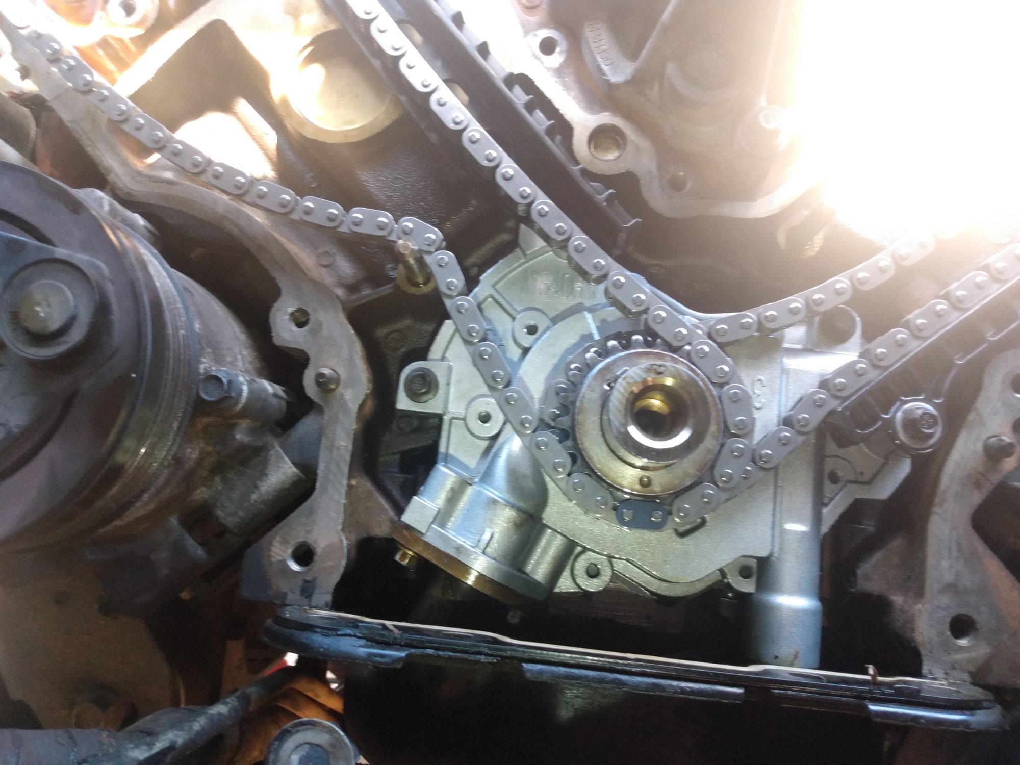

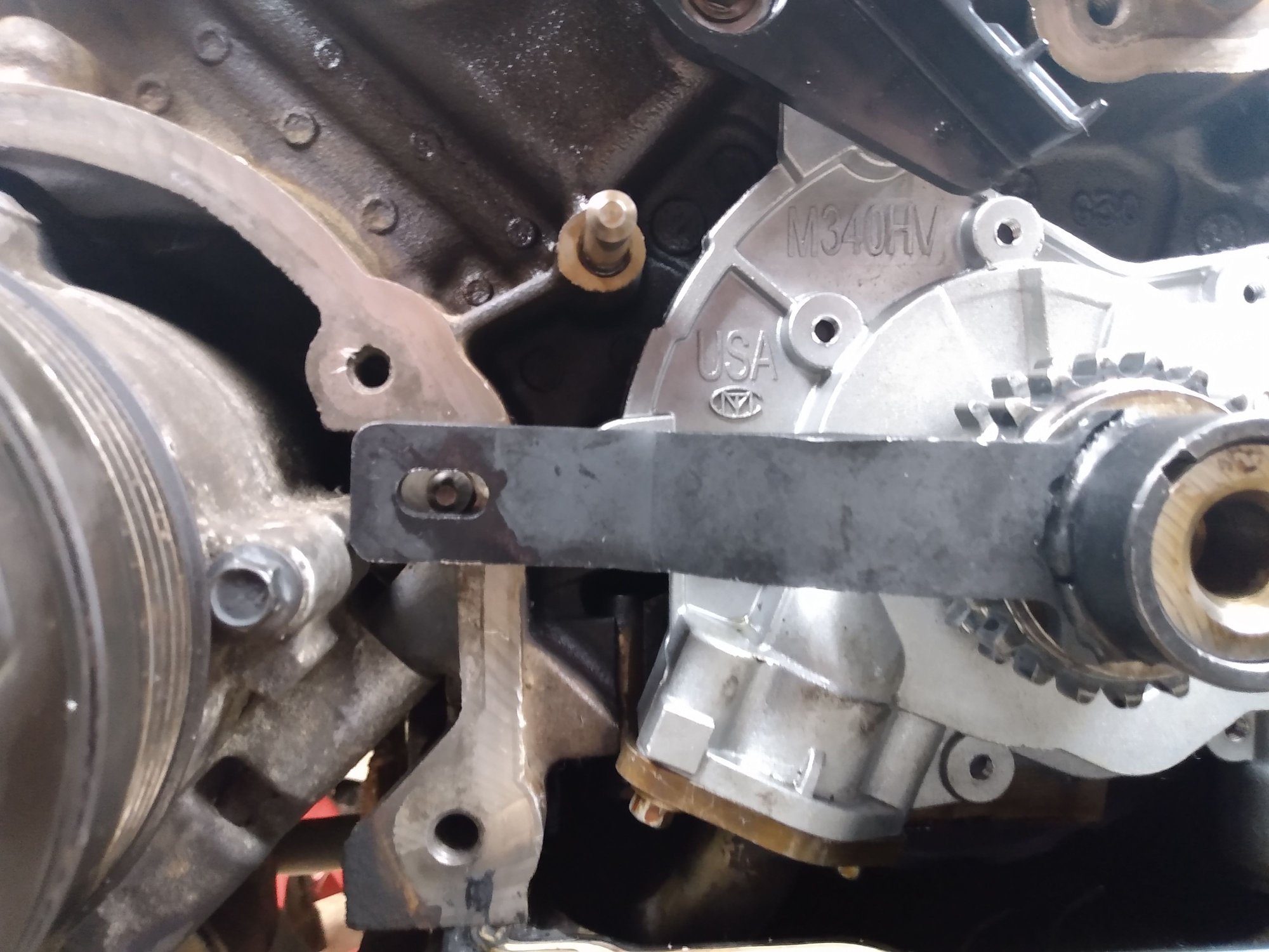

Old Feb 21, 2022 | 09:43 PM
grinditout's Avatar
grinditout
Joined: Nov 2014
Posts: 42
pictures
Old Feb 21, 2022 | 09:45 PM
grinditout's Avatar
grinditout
Joined: Nov 2014
Posts: 42
Did you cheese wedge it?
