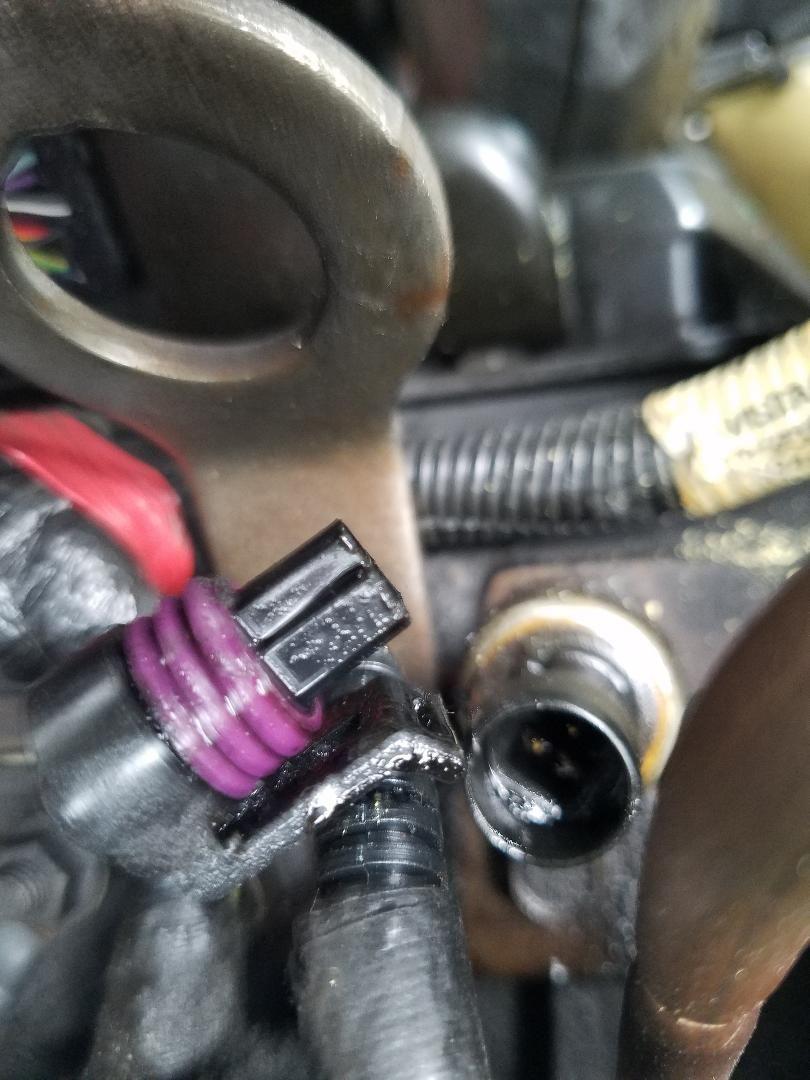

With an original ICP sensor, take a look at the pigtail and make sure the wires look good well into the loom. Check for oil leaking into the pigtail connector from the sensor.
If all good there, try unplugging the ICP sensor and running the truck that way for a drive or two. See how it runs then. If idle is smooth, no misses running on the PCM default values for ICP, we blame the ICP sensor.
If it still misses, recommend rebuilding the IPR valve or replacing it. Motorcraft only for these parts.
Good warm idle ICP will be 470-500 psi or so . IPR% will be 8-12%. Both will read higher when cold.
