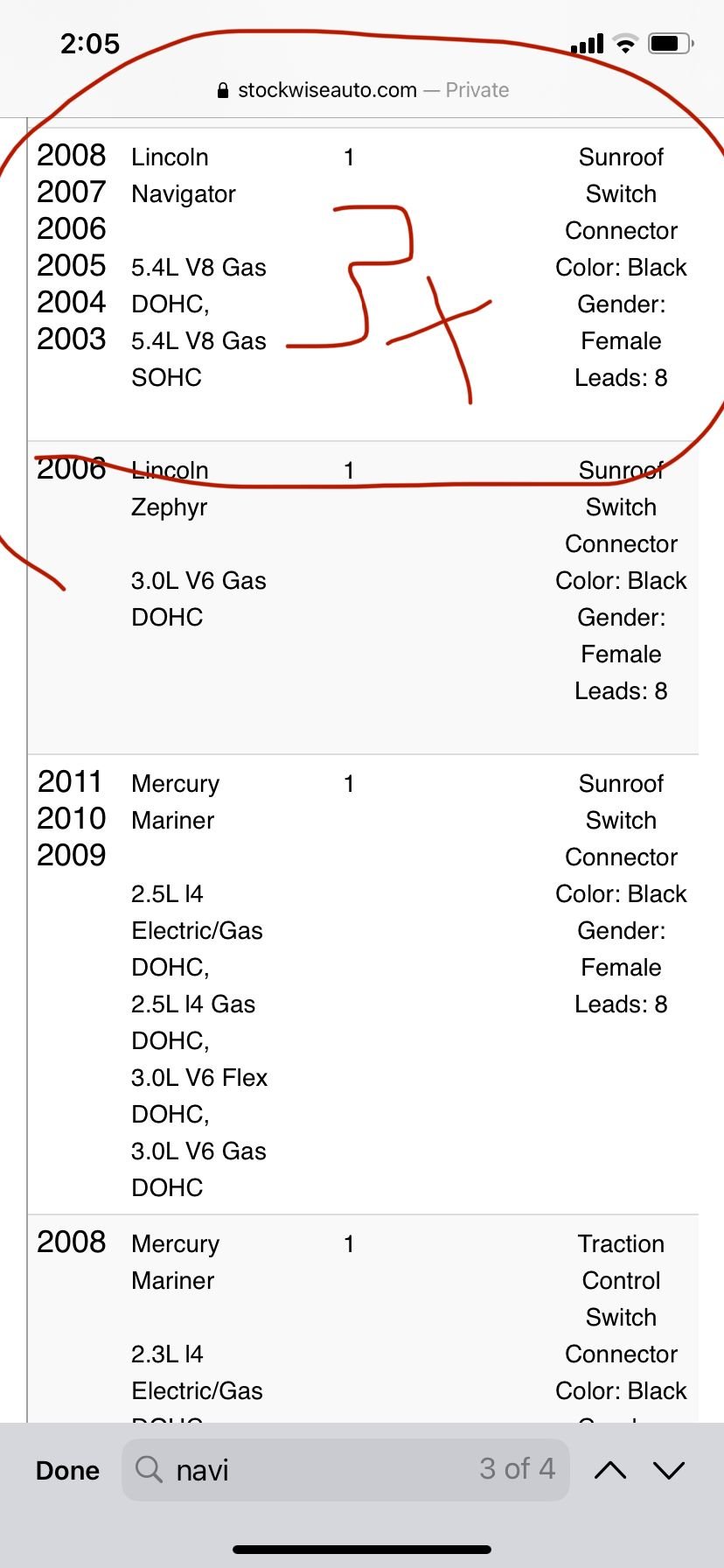

Quick search on Ford site shows just “latch”, so they may only sell it as a unit which is $100.
I would go out and take pictures of the connector and try to see any numbers on it.
Type those in google along with descriptors and start searching. When you think you found it, go on stockwiseauto.com.
I accidentally discovered this site when looking for the f150 small side mirror connectors to adapt a set to my super duty.
Its cross reference of interchangeable parts is impressive and helpful at least in my area as newer vehicles dont end up in the pick your part area of the yards usually.
Was able to see that they had 3 of the connectors I needed up high on a vehicle, which is important for junkyards cuz it makes it easier for you to pick and you dont have to lie in filth.
Screen shot or right down the vehicles and start looking.
Here is an example of how the site will look. It will even tell you how many of the connectors are there. It said one but I found two others that were close enough after working them over with snips and that is why it says “3x” as I was making a write up of the swap before everyone on this site told me I was crazy.
Edit: Read your post better. If I understand you correctly now, my added advice would be to try and take the connector it plugs into off a junkyard latch, jump it and seal it up with a big piece of shrink tubing and plug that into your harness.
