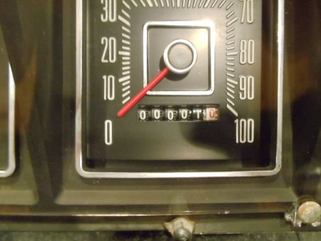

While we're on the subject of odometers this is just a heads-up, point of interest.
If you come across an odometer that has a red tenths digit instead of black, that mean at some point in the vehicles history the speedometer was replaced with a new one. That's how Ford prevented someone with "questionable" values from being able to quickly and cheaply roll maybe tens of thousands of miles off of a truck by visiting the parts department.
I found this out when I was restoring my instrument cluster and replaced the speedometer with a NOS unit.
Of course the typically "values challenged" individual would visit a wrecking yard not the parts department.
