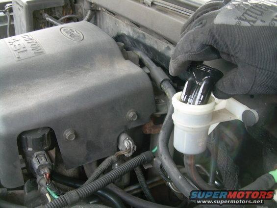

Are you talking about a little rubber thing that kinda looks like this? I’ve pulled that out and even felt around in the bottom of the reservoir and it seemed all good nothing blocked or debris there.
That's it. Looks like you took care of that problem.

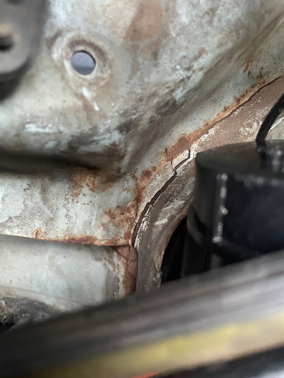

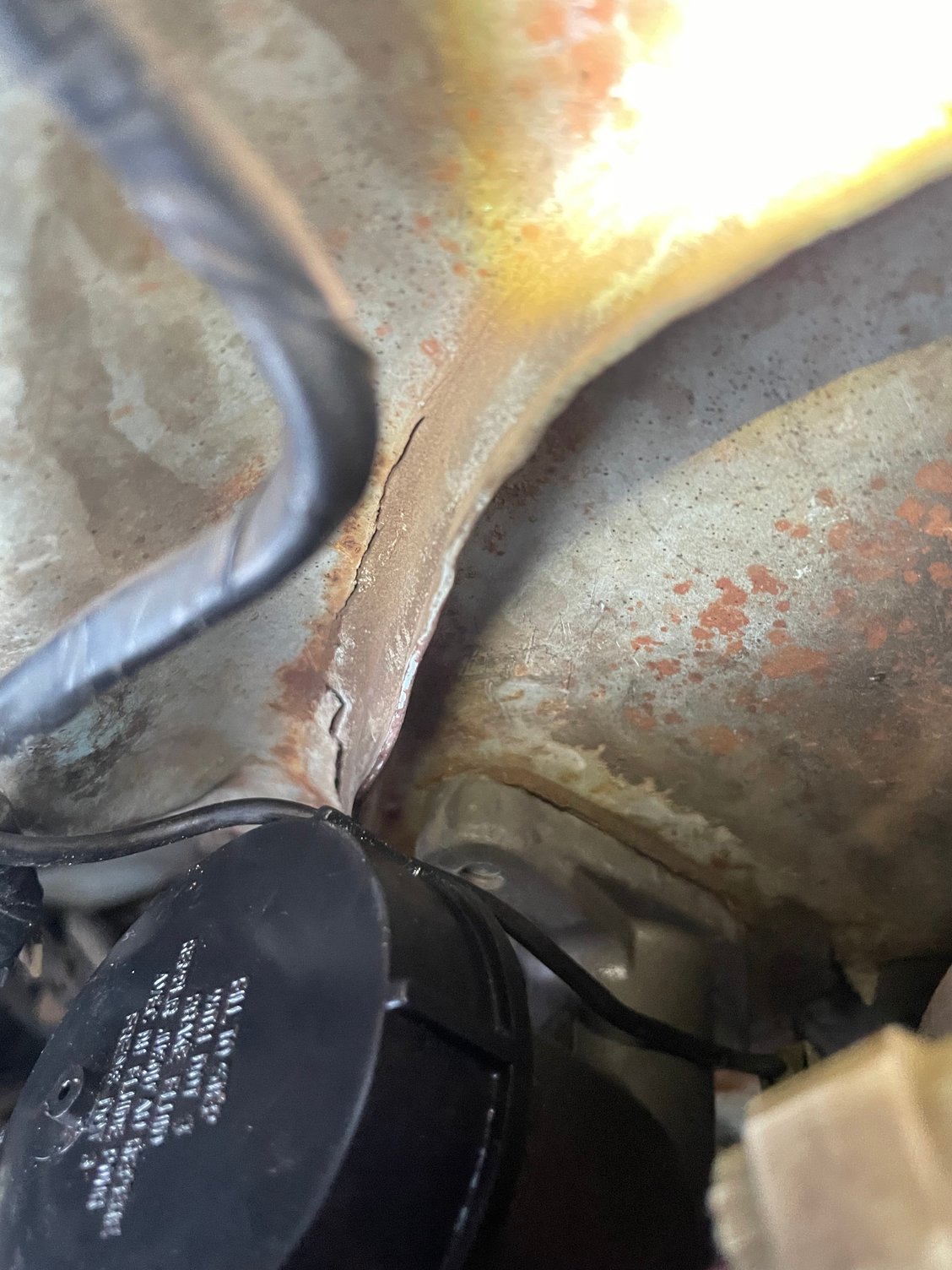

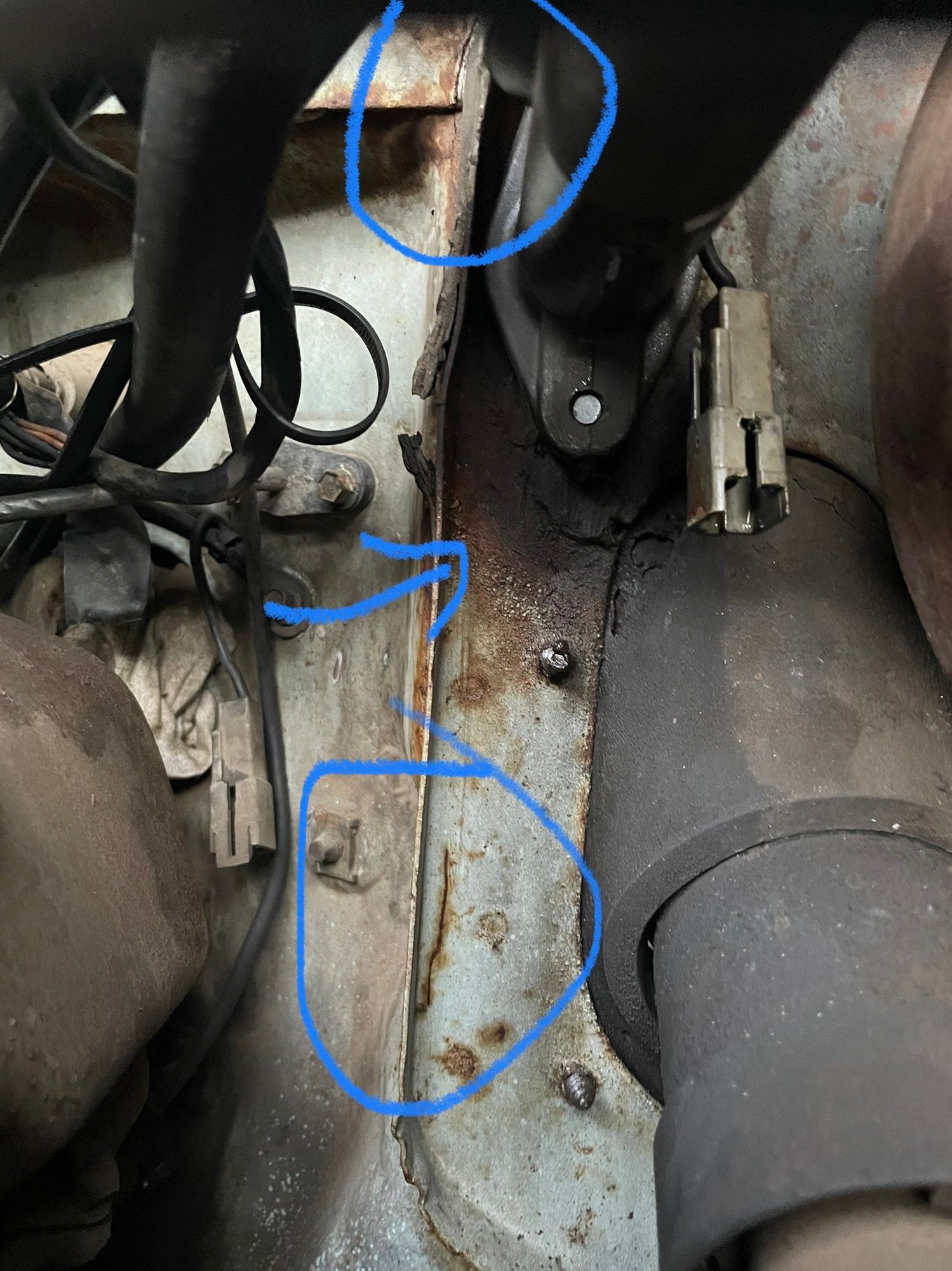

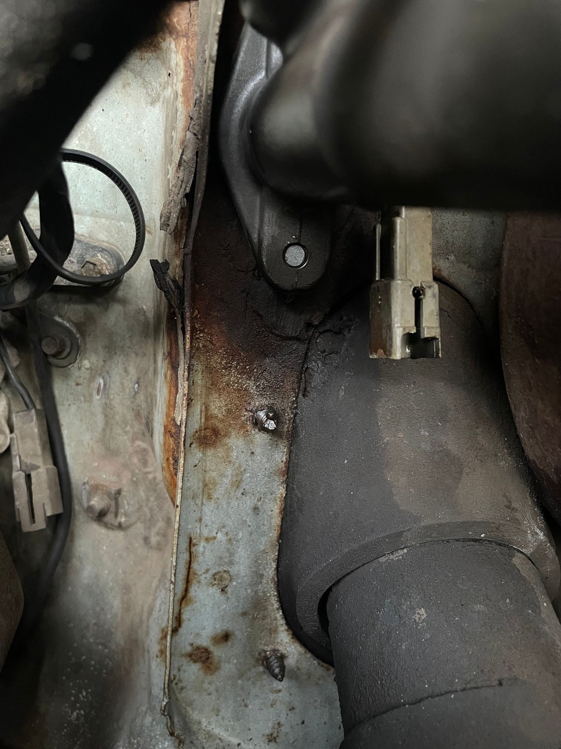

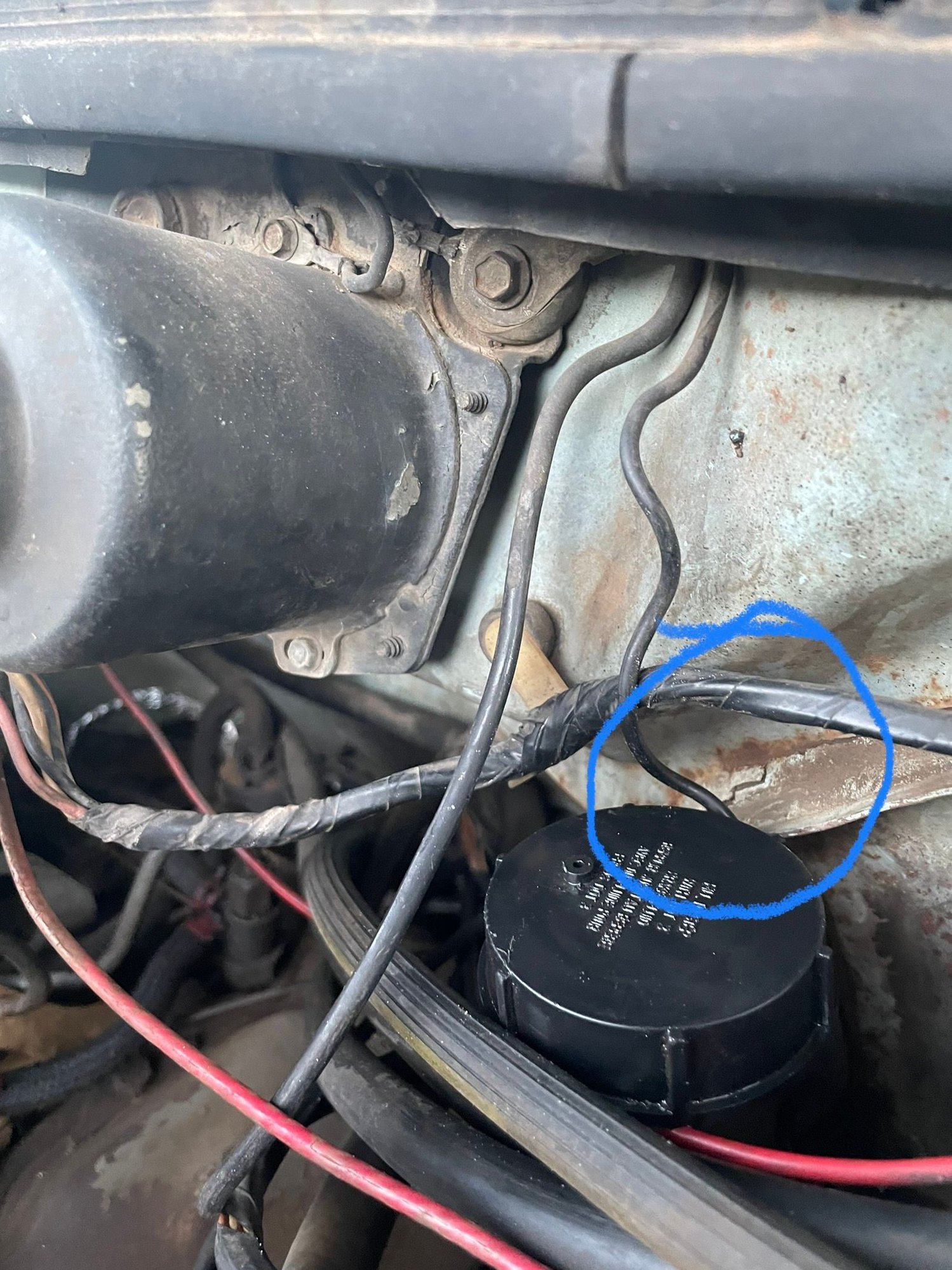

So these are the pictures I got not much too look at lol. I didn’t clean anything up yet but this is what I could see so far. Would this be the cause of my problem?
It’s not often one can say this to another guy, but thank you for sharing pictures of your crack.
Looks like it’s time for that repair plate.
