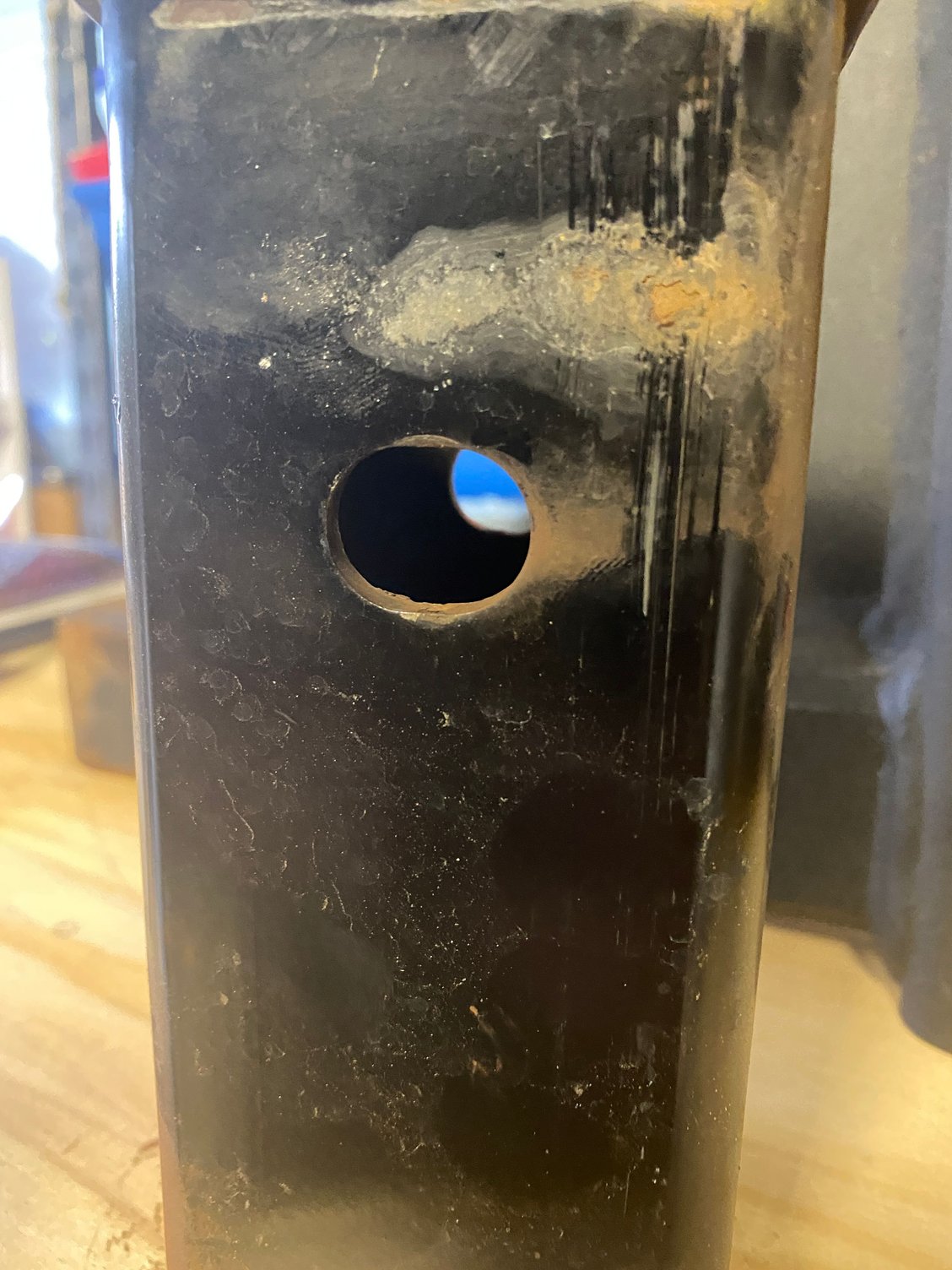

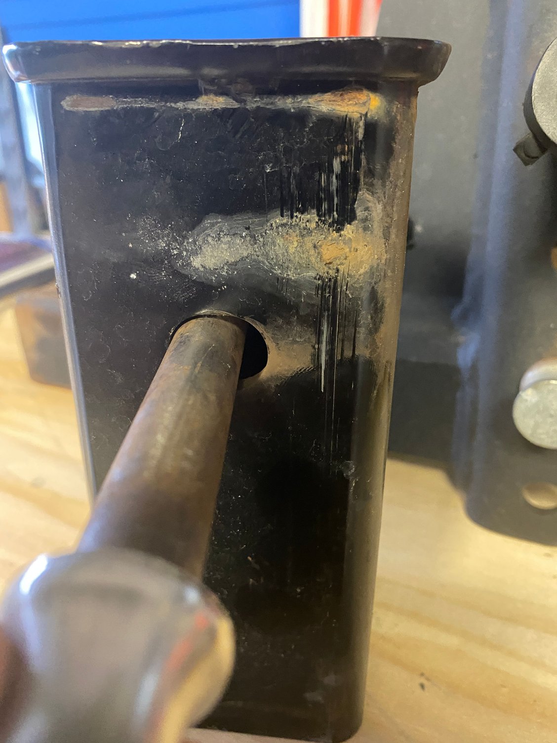

Do I have reducer sleeve oblong hole syndrome?
was finally able to get a hitch that has a 3 inch shank and I saw this on the hitch reducer sleeve

The reducer holes are slotted up and down to make it easier to insert the pin.

Yeah, no issue there.
If it was slotted out in the other direction, then it might be an issue.
Plus, it's just the sleeve, the ball mount having the proper hole is most important.

theres a lip that keeps it from sliding into the receiver all the way. Probably sticks out 1/2” or so.

The pin hole wallowing that has been reported - I experienced this myself - is on the receiver. Could it happen on a reducer sleeve? Maybe, but I would be a lot less concerned about the sleeve than the receiver.

Probably not, the sleeve doesn't transfer the load from the ball to the hitch, it just keeps the bar aligned in the receiver.

Just make sure your pin is straight.
