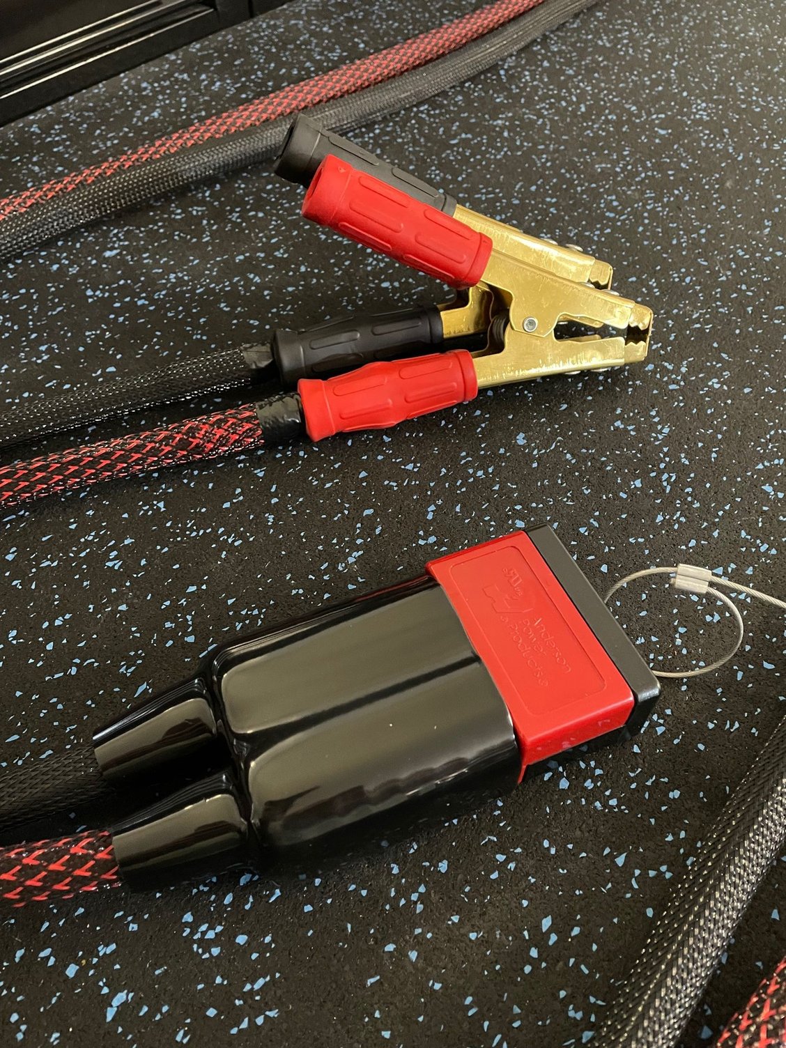

If you are looking for just the battery connection, many drill a hole in the flat/raised part of the connector and run a bolt there to connect other cables.
For my application, I just went with straight jumper cable connectors so I can easily put them on and take them off as well as using them in other vehicles.

I'm not sure my cable has that much room on it, to put a bolt. I'll have to take a look at it. Thanks for the response and pictures.
