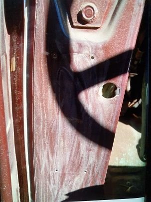

Yep; that happened. So this truck is a family owned F100 Ford Truck, now an antique. My dad Raymond Sanchez was first owner, then My uncle , and now me.
My brother is in possession of the truck, and found that the VIN plate is completely missing- taken off for some body work/ painting etc.
BIG Q: how do I obtain a replacement VIN plate? Through what source? I was thinking maybe Ford Motor Company? or is there another Company out there that performs this services???
Thanks for any feedback!

If you need a data plate that is screwed on the driver's side door sill in 1956 trucks, there are places that make them. Try Mid Fifty or Google for others .

Don't freak out, that is just a Data plate, not a VIN plate. IT has the VIN on it but is not legal as a VIN tag. VIN tag wasn't required on the dash till 1968, then standardized location in 1969 (model year). Your original VIN will be stamped on the frame if this as listed above is a 1956.
