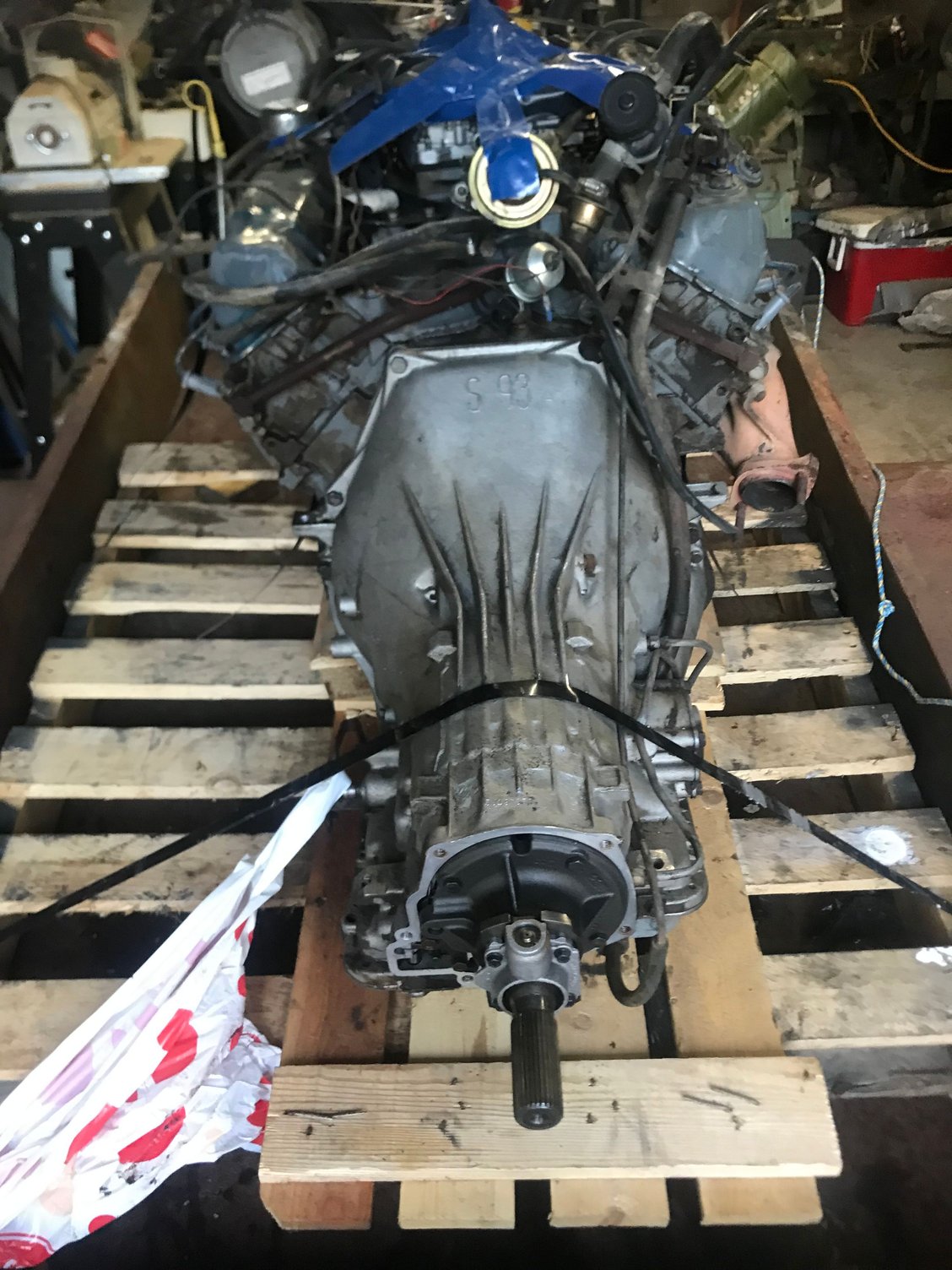

this is my transmission
Sorry!!!!!
My truck is a 2WD SWB F100, but I think the cab was replaced with a F250 bumpside, I'm pretty sure they are the same.
The engine I brought (460 with BBC6) was out of a 4WD F250 with electronic ignition, the seller kept the T/C as I didn't require it for 2WD application, he also kept the oil filter housing as he said it would not fit my truck?
I have read a few threads, but they are a bit contradictory when it comes to engine mounts, BBC6 output shaft housing ect. i.e. do I need just the BBC6 2WD output shaft housing OR do I need the 2WD output shaft as well??
Can attach photo's if it helps
Thanks,
Mark

if that is a real '4x4, 460, C6' (not from a 400 or 351M) then it is worth some $. It should have big drums in it. Worth 2-3x a 2wd version.
Buy a 2wd and sell the 4x4. The output shaft is worth more than a new core.
