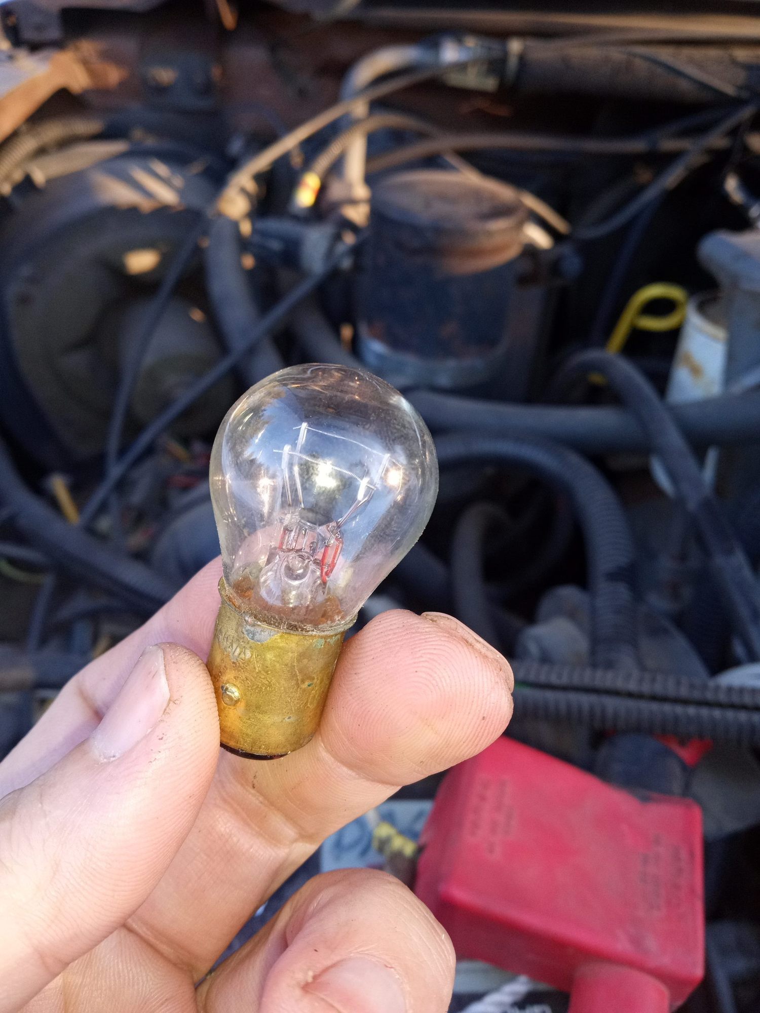

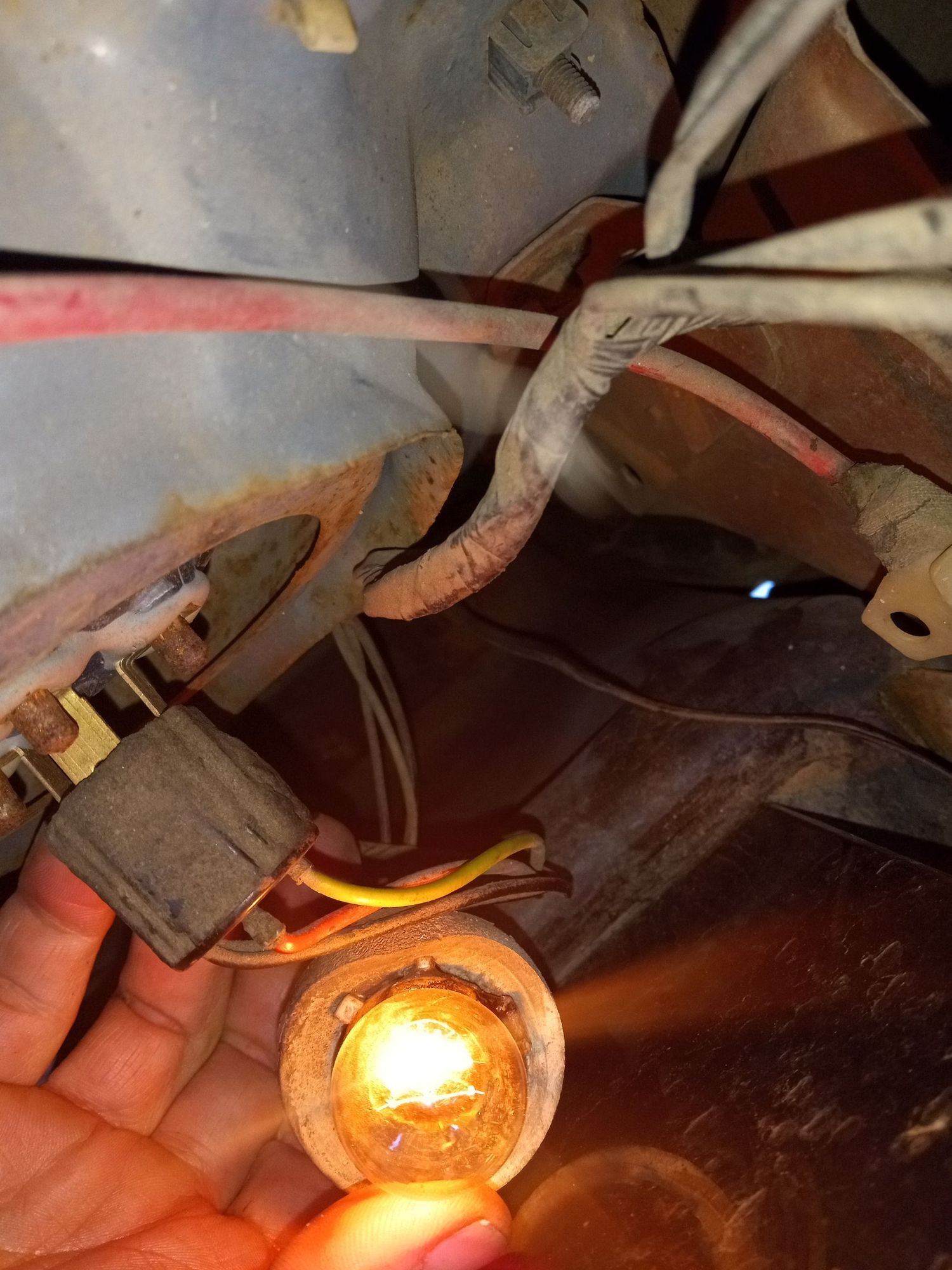

Hi All,
I wanted to see if I could get some advise on low-beams for my 1986 F250. AFIK, the truck is bone stock. These are my low-beam lights. They are amber on the plate and they do work. The problem is they are useless. I can't see anything at night with them. They look like the interior lights in my RV. Can anyone comment on this? Should I be using something else or did something get modified?
Thanks,
h.ubk

Huh? You totally lost me. The round globe bulb you’re holding? That’s the front marker and turn signal bulb. It should have two filaments in it as seen here:
Your low beams are part of the big rectangular headlights. Each of those lamps also has two filaments. Those big glass units are sealed beams, meaning when a filament fails, you replace the whole thing.
If your headlights only illuminate with high beams selected, there are a couple of likely culprits.
1) The low beam filament in each headlight has burned out.
2) The dimmer switch has failed and only works in the high beam position.

Originally Posted by h.ubk
Hi All,
Well, these are actually NOT your low beams, but the combined running/clearance and turn signals lamps. The dim light you see is supposed to be dim cause again it ain't no headlight!
In that picture with the bulb lit, that black plastic connector with the black, red, and light green wires, that's for both your low and high beams. The big glass lamps you see on the front of the truck are combined low and high beams assemblies, inside them there are two coils just like in the bulb you got on your hand, only much brighter.
Low beams get used all the time, highs nor so much, so naturally usually the low beam coils burn out first - it's rare for both sides to go at the same time, my guess is one died first and the at the time owner of the truck just kept driving on the other one till it went too, at which point he didn't bother to do anything about it.
Any parts store will have these lamps, they are sealed units so you replace the whole thing. Personally I'm a big fan of the Euro-pattern ("E-code") lamps cause they offer both a better light spread on the road and their bulbs are replaceable separate from the housing, however those you'll have to order online and strictly speaking they're only legal for use on motorcycles but not on larger vehicles (unless the law has changed in the last few years) if that matters to you.

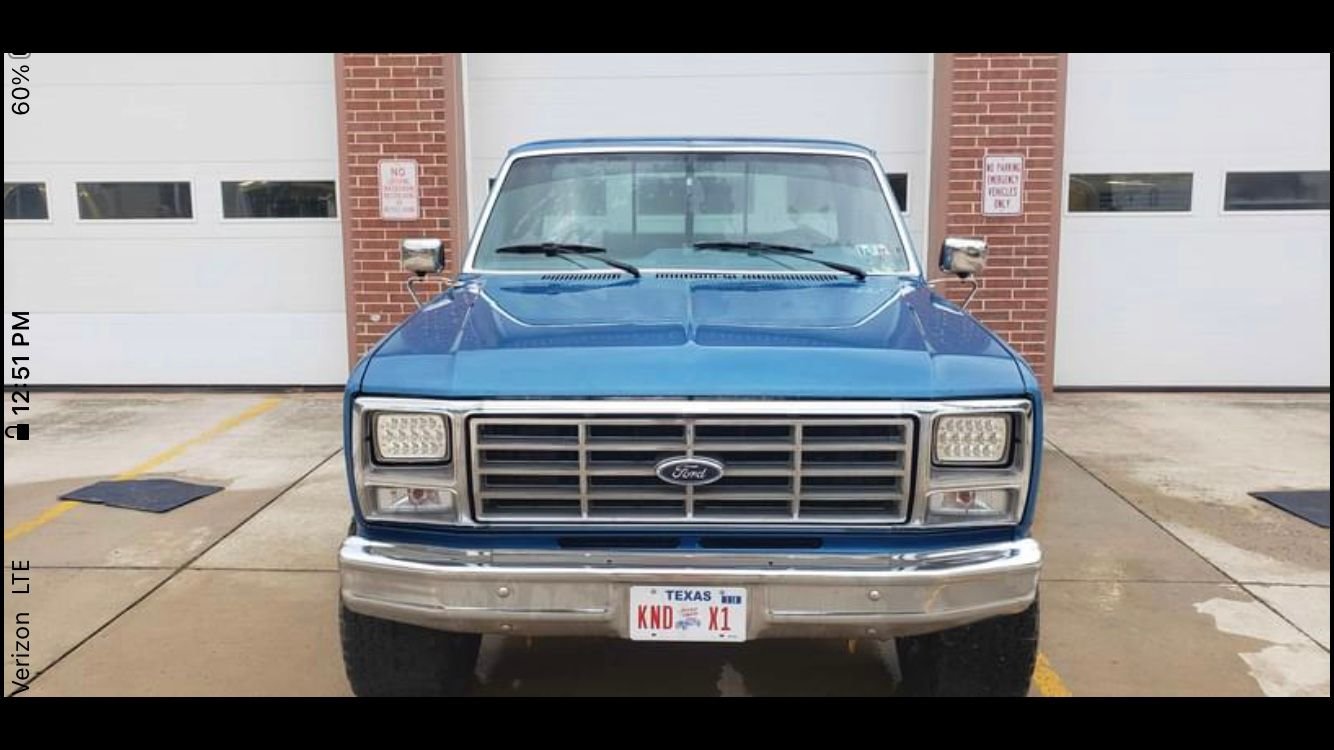

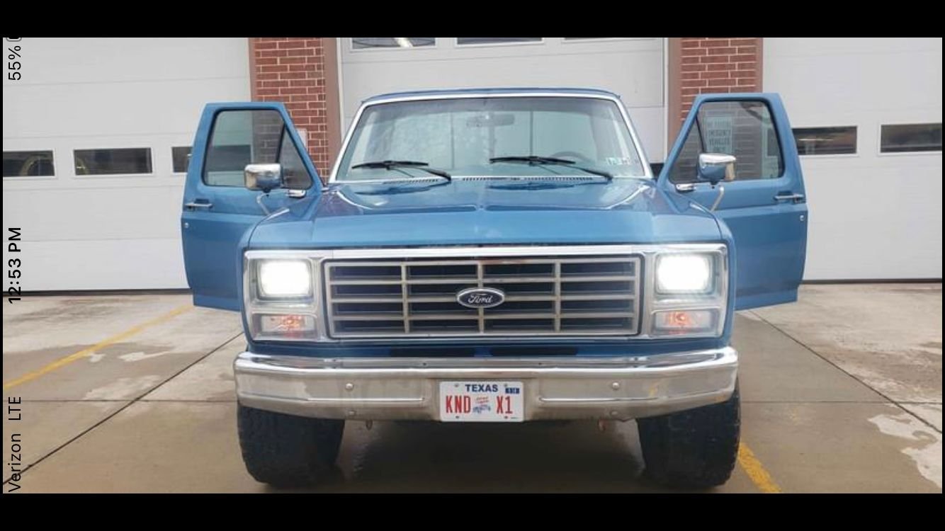

I would not do LED head lights, the beam pattern is not good on the cheap ones and the good ones are a few hundred that most do not want to spend the money on. As for them for turn / park you may need to change out the flasher to use LED bulbs and note the LED have to be the same color as the lens it is behind them or they are not bright or the right color.
The top big square lights are head lights, halogen bulbs from the parts store. Yes I am running relays and it made them really bright.
The yellow lights below are turn / park lights normal 1157 bulbs from the parts store.
The driving / fog lights in the bumper , custom added by me, are halogen bulbs. The kit came with relays, wiring and switch for fog / driving.
I use normal 1157 bulbs in the tail lights and are also bright.
Dave ----

For the head lights or the turn / parking lights?
Dave ----
I have to agree on not doing the LED lights but to each their own. I run the original glass sealed beams also and don’t have any problems at night. Plus I don’t like the look of the LEDS. At Ford truck shows they stick out like a sore thumb but again that’s just my opinion.
