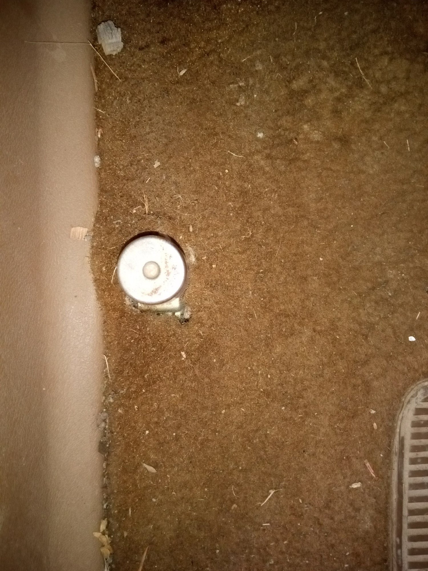

Wow, that's news to me. Is this the switch on the floor you are referencing? I tried pushing it and it doesn't seem to make a difference.

Yes that is the switch, when you push it in, the beams change. The contacts go bad inside or the connector gets nasty.
I don't know if you can take it apart to clean up the internals, maybe with some finesse. The connector is easy enough to clean up though.
They also are not that expensive to replace. I bought one because I thought mine was dead but I managed to clean it up enough to work.
Highs still don't like to come on always but a few stomps clean up the contacts enough to light em up.

Wow, I'm excited. I get low and high beams and LED lights. Thanks for pointing that out. I had trouble getting it to work, but after removing the carpet, I was able to fully push down on the switch. Thank you!!!
