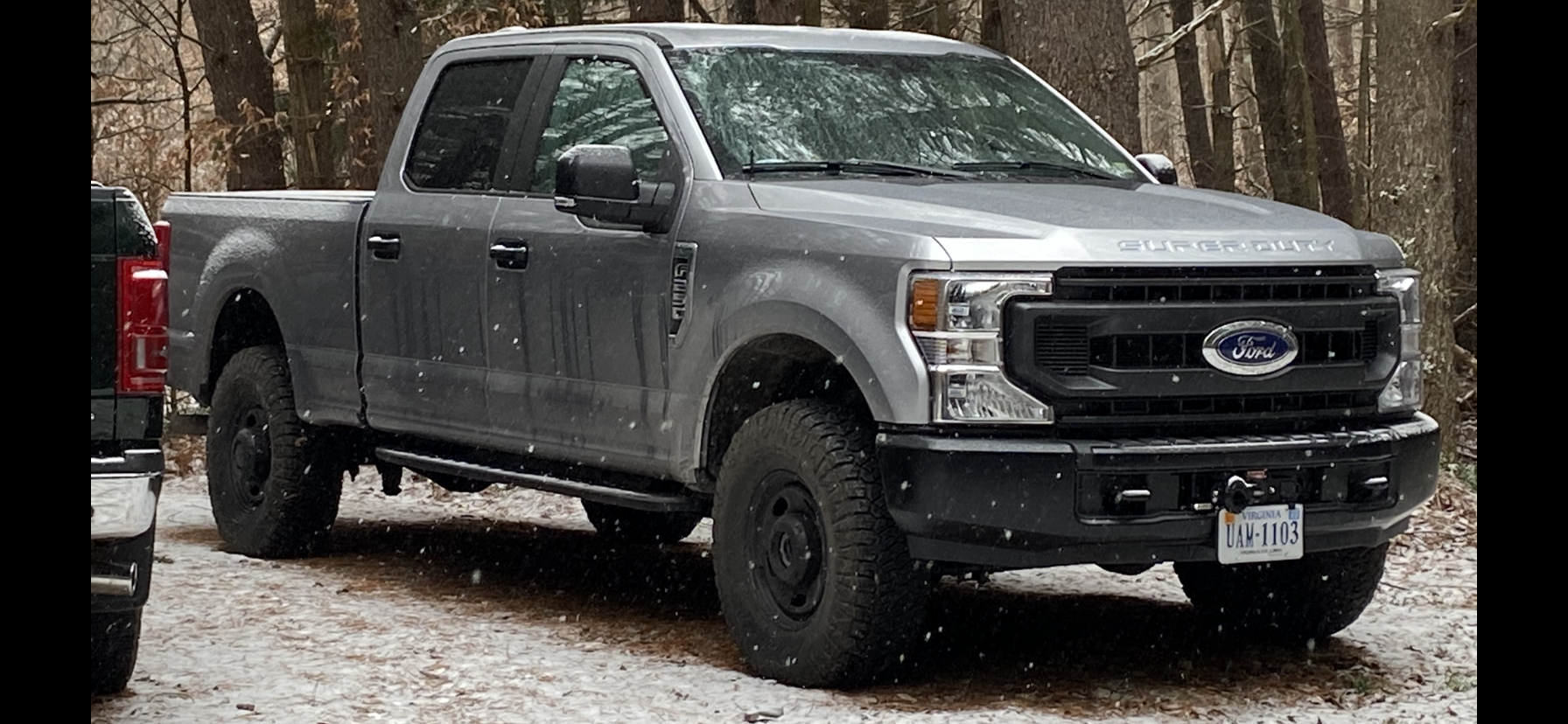

I got one on a F-250 XL 7.3
It is a nice winch with nice features. If I could change it, I would put the free spool handle higher up the body to improve clearance with the bumper, and I would make that handle removable so that you can keep it in truck and keep a vandal from doing mischievous acts with your winch line.
With x-plan it is about a $2700 option. Which you get to finance, my credit union gave me a 0.75% APR so it was a no brainer. Could have bought a badlands winch and some brackets and installed myself for about $1000 bucks probably.
There are threads on here about dealers trying to say winch issues are not covered by warranty. Dont know the final outcome on those but it is worrying.
It is a dealer installed item, so the install is up to who they put on the job.
My dealer installed it pretty crappily. And reinstalled the bumper all messed up. And didnt tighten the airbox hose clamps after.
I loosened all bolts and used a scissor jack to hold winch as high as possible while I retightened all the bolts. I then took a ruler and drove myself nuts getting the bumper as high and as even as possible with two scissor jacks allowing me to dial in the fit.
The overlap between the airbox flange and its tube is pretty substantial and the fit is pretty tight. Looked inside tube and it didnt seem to have any dust or water in it in the couple hundred miles it was loose before I noticed during a headlight bulb swap.
If your are handy, I would explore getting a credit and installing it yourself.

@mudjski That is a good looking truck!

Thanks.
I love it. Very little I would change if I could order it over again.

Let me ask you off topic…what suspension do you have on that truck? Looks pretty level…

That is bone stock, nothing special, springs front and rear. 40.5” to top of wheel arch in front, 42.5” in rear. My understanding is that that is the low end of rake on these trucks from the factory, as others have 3 or 4” rakes.
4800 Lb springs in front. Whatever they give you when you order an F-250 with 7.3L and 4.30 gears in rear. I know it has a DANA M275 axle in back, which I regret cause they do not make a TrueTrac posi for them. Blocks in back are 2”, so I could teverse level it easy, but I dont wanna squat when I load my quad and gear up in it.

Looks good. I’m more than a little disappointed that they lowered the 20 and up. My 18 has snowplow front springs and sits high. Yours makes me feel a little better.

Yeah it is all “eye of the beholder” I guess. More height needs more tire in my opinion and it already has 35s (34.7”) on it and I think it could use 37s.
I dont wanna do that cuz spare wont fit after that, and you cant find 37s narrow enough to run snow chains. Some day I will get Method wheels and run 37s except for the winter.
They just build bodies different now. I have an ‘86 K5 Blazer. Its is stock height to my knowledge, with 31s. Its rockers are higher then my F-250, its roof is lower, and the wheel looks bigger in proportion.
