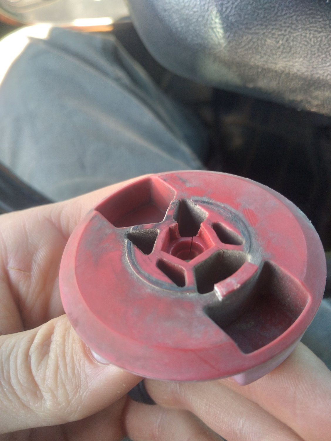

Hello all,
I am wondering if there is a place to source new aftermarket (or even OEM) locking hub dials for these dana 60s.
I see that Torque King and a website tdsideas.com have them for the dent-side 3/4 ton dana 60s and superduties, but none for our generation. I also contacted Warn Industries for replacement parts due to my understanding they are who supplied Ford with them back then. They replied that they do not have replacement parts for OEM hub lockers. I am guessing this is due to the fact that our hubs are immediately upgraded, but I wonder why when mine is working satisfactorily after 32 years despite the damage.
The problem with mine (and most everyone else's) is UV damage combined with wear and tear, as evident in my pictures.
Looking forward to some information! Thank you in advance.

Dana Spicer would be the OEM.

Hmm. You may have issues finding them. I would upgrade to a newer or more availabe ****/cover since it looks like the internals may be compatible with a newer type ****. You can also repair that with epoxy and get new ford decals for it. They ARE made by Warn!, go tell them they dont know what they are talking about

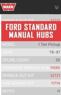

https://torqueking.com/product/56013...ssembly/#note1
If you dont care about the red part, you can buy ford labels and put them on black ones(would look nice)

if you ask for a replacement dial that would fit vs for that red one, you may get somewhere. I would look for a used hub online honestly me personally, find one from dodge or gm they may be more abundant. I think they were the same just diff color

Ford used a red dial while Warn dials are black otherwise they are the same. Neither Warn nor Ford services the dial as a separate part. In order to find just the dial you will need to find a used part in better condition than what you have.
​​​​​​​This is exactly the information I needed. I think the hub service kit is what AuroraGirl shared before.
