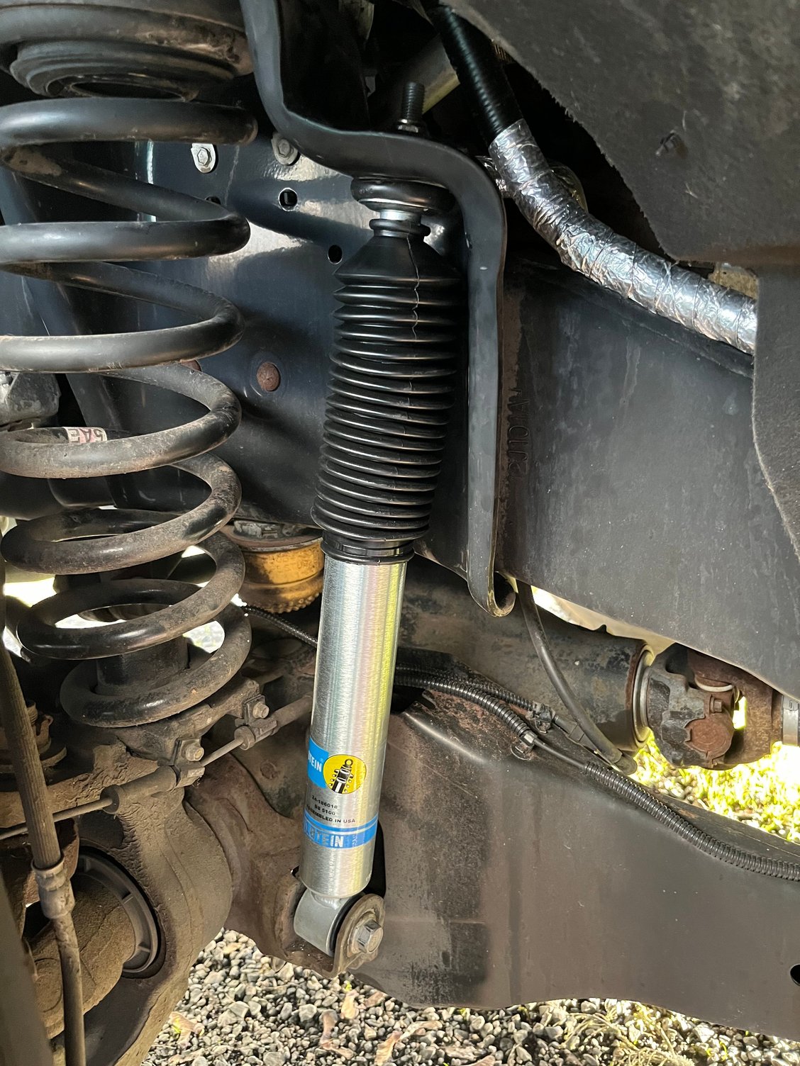

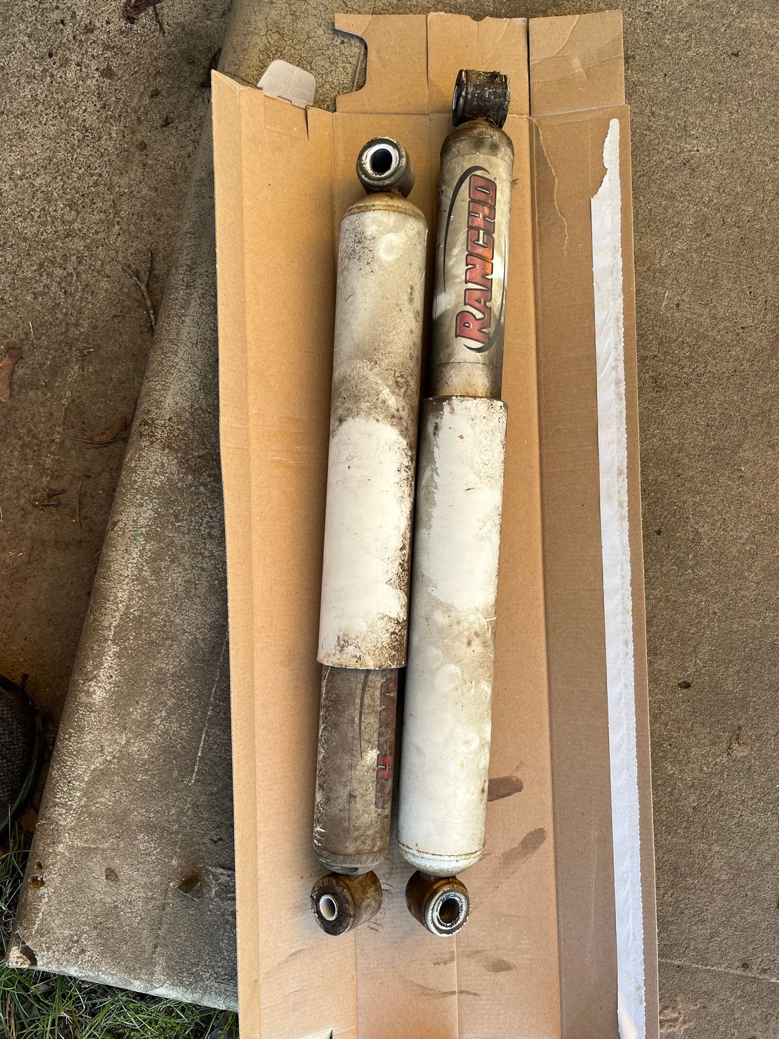

Went with Bilstein.
The originals wouldn’t even rebound.
The rears and steering damper are meant to arrive today.

Looks good. I know when I replaced my factory shocks the one I took off the right front would not rebound at all and the factory ones only had around 41000 mils on them.

These had 60k. Both wouldn’t rebound and might have had water in them or at least that’s how it sounded when I pressed them. It is Oregon after all.

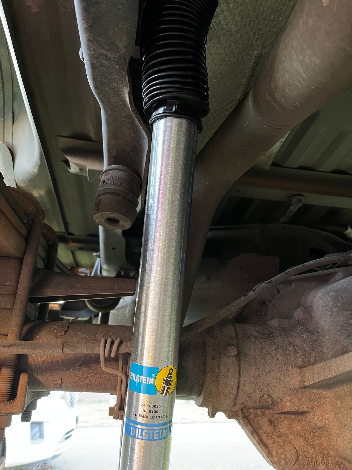

Rears arrived today so see how those are.

Rears went a lot faster. Originals had a little rebound to them, but could be pushed easily with one hand.
