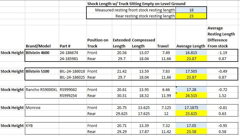

It seems that there's good and bad info regarding the 4600 vs 5100 series debate.
Often times, the 5100 is quoted as the shock needed for lifted or leveled vehicles. The F150's (and any other independent, strut front suspension vehicle) have adjustable ride height with the 5100s. The 4600 do not have the adjustable feature so they are really only sized for stock height vehicles.
The Super Duties are a bit different though. There is definitely a discrepancy of what is "stock height". Is it a gas or diesel, does it have a plow package, what spring rate was used, etc. all factor in to the actual stock height. For that, a shock of the correct length is needed, whether its listed for stock height or not.
In looking at the 5100 vs 4600 for my truck, there was a little information available online:
FAQ - Bilstein Question #4
BILSTEIN 4600 VS 5100 SERIES, WHAT ARE THE MAJOR DIFFERENCES?
The most helpful thing was to look at actual stock shock length and potential travel. I measured the shock with the truck empty, sitting on level ground and compared a few shocks in the running. The 5100's were closest to my truck's resting height and allowed for the most travel:
