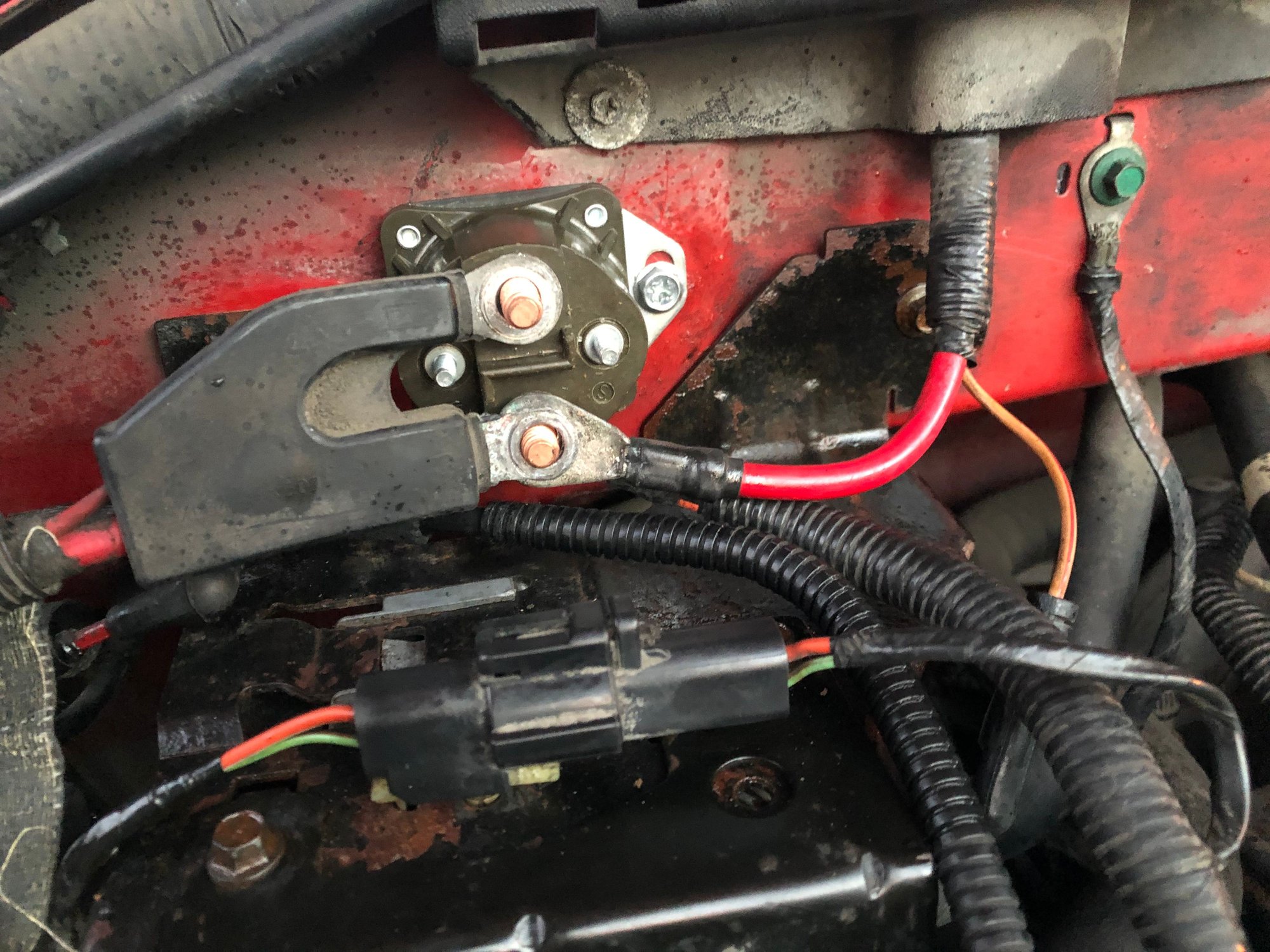

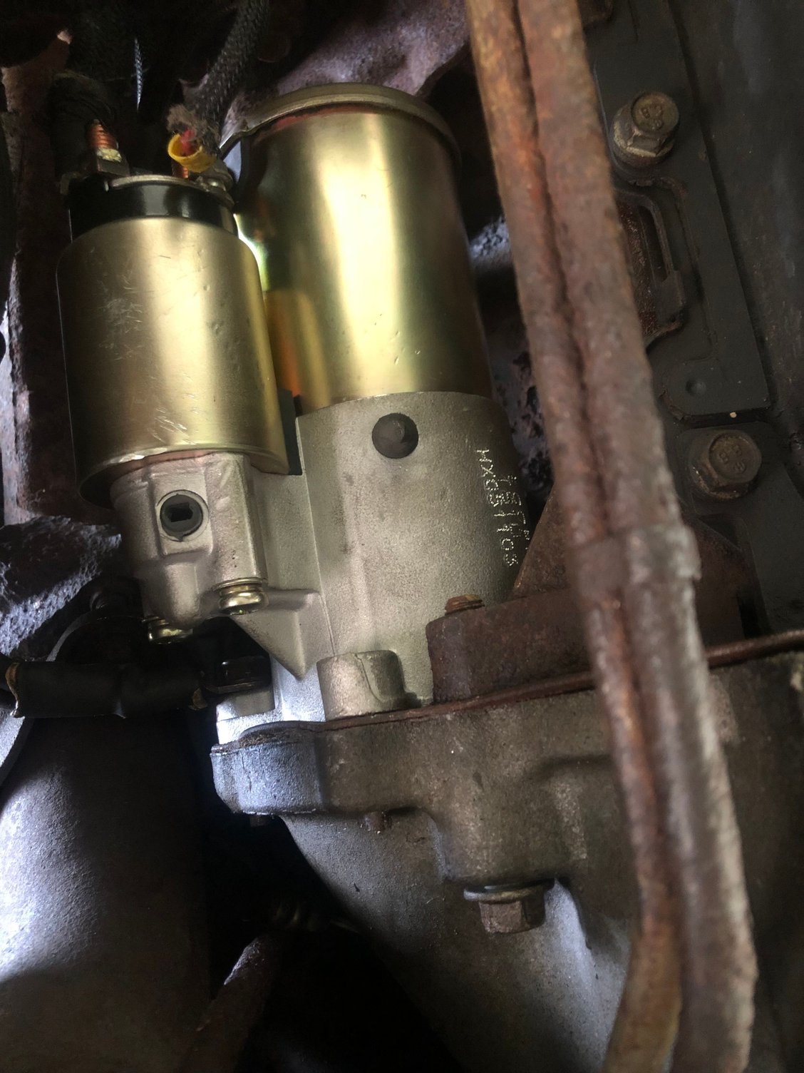

I got it from Amazon not motiorcraft, so prolly rebuilt. I’m not sure about the wiring because I didn’t that myself. I did take photos of how it is wired. I do know this is the first on one I put on then when truck didn’t start after installing, which still a broken bolt from it, left there, i orders another one. It didn’t work either,with both of them i at lesst got that clunk sound when i tried to stet it. So we then replace the solenoid relay in the firewall, nothing, battery terminals, then the ignition switch, after that started when d hearing one little. Click. Was told that the flywheel was stuck in the starter. Whe replaced tha next thens solenoid on the starter. WI to lol hi hunt changed won’t ststf

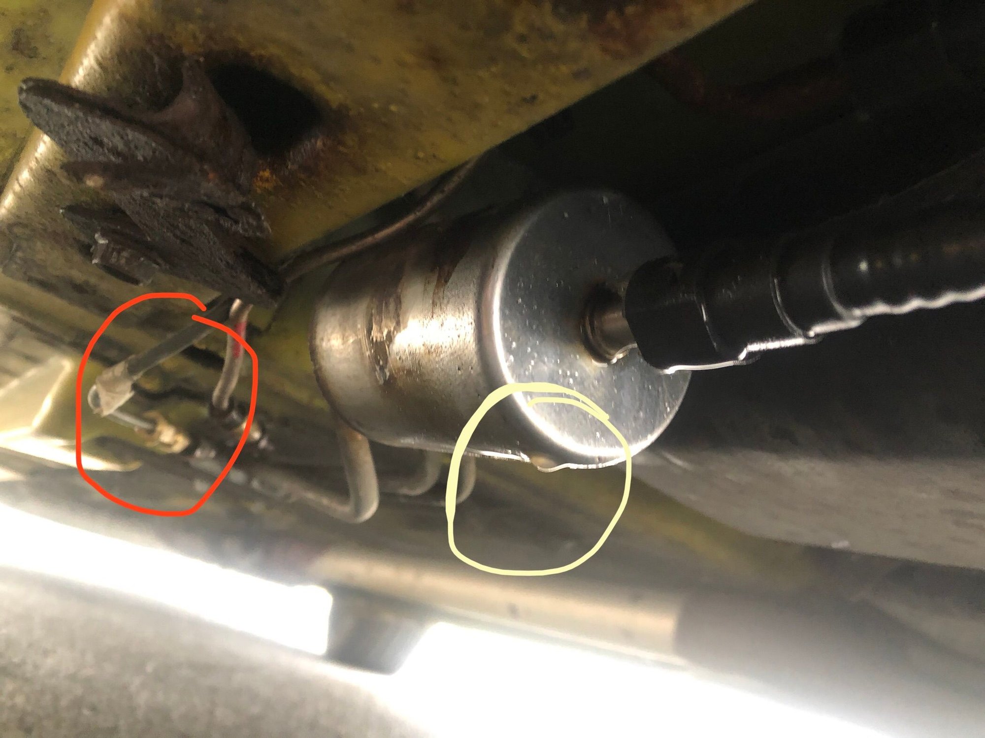

Sorry one of those pictures is from my other vehicle

I can't be sure from the photos. Assuming it is wired correctly and you have the right starter, have you tried starting in neutral ?
Is this automatic or manual shift ? The problem as mentioned by others could be the gearshift or clutch switch not engaging correctly.

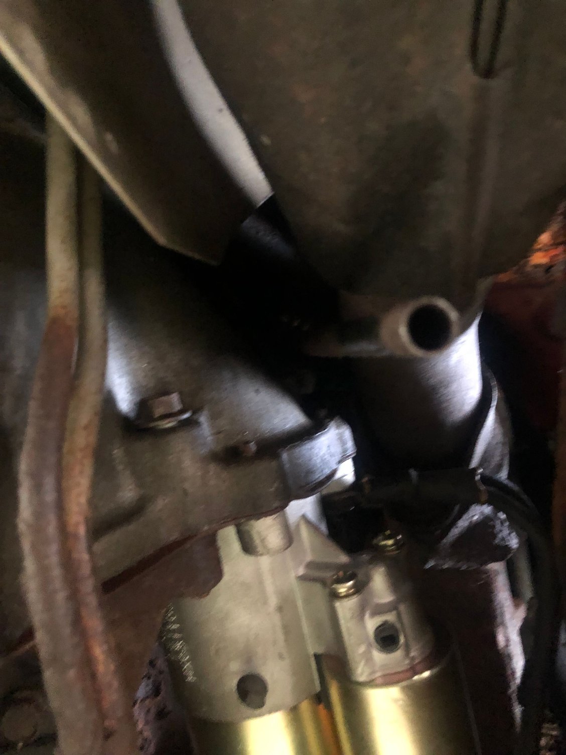

Before I bolt it down is this correct
