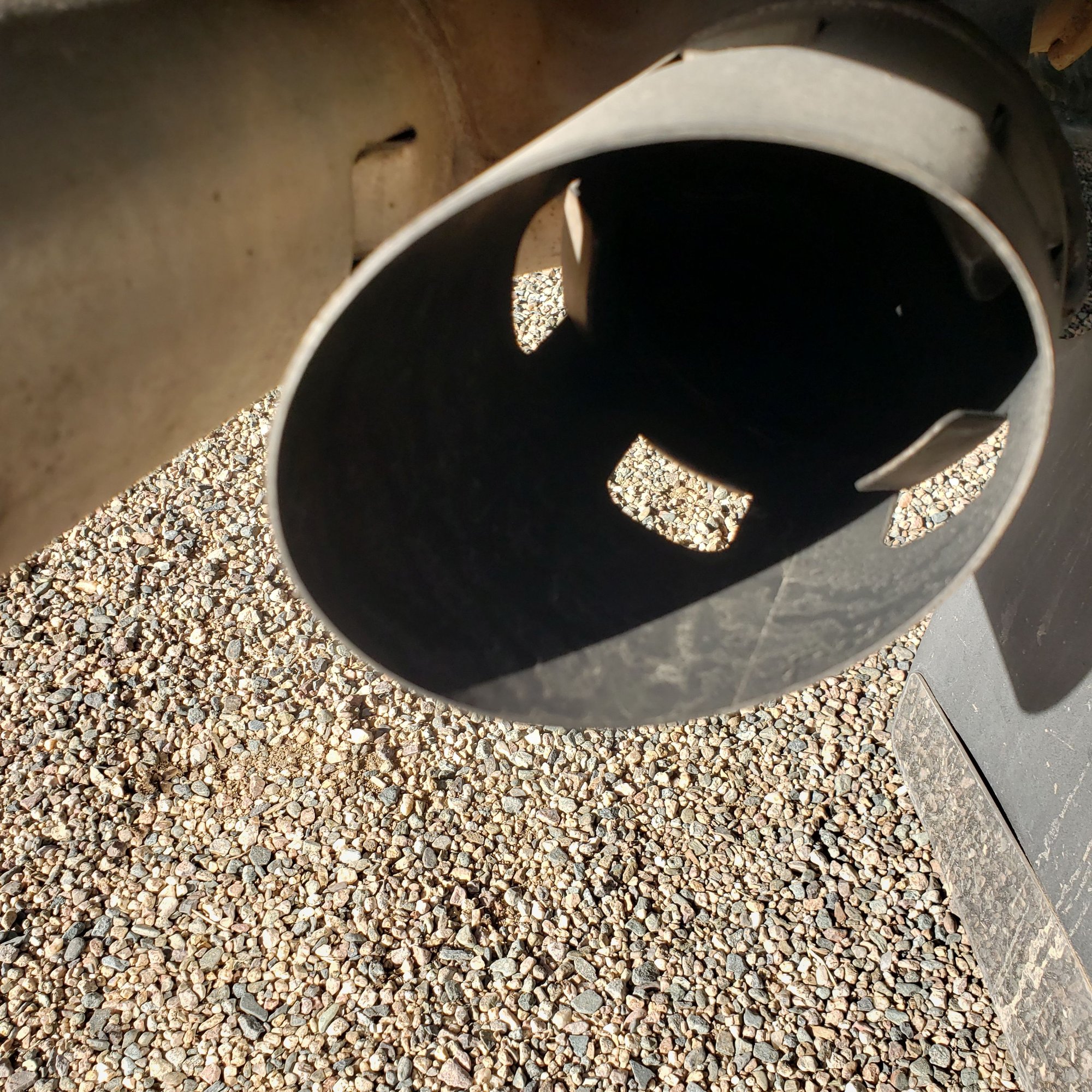

black exhaust tips
Monday I dropped my truck off at the dealer, again for black exhaust tips and using coolant in the main cooling system. they still have it! maybe something will get fixed this time?

Maybe. It would be nice to get these issues resolved prior to warranty expiration! If the dealer claims the DPF issue is normal again, they won't be doing so truthfully for your mileage truck. Most of us here know this isn't normal. If the separate coolant issue reason isn't found and you can't find a leak, I'd recommend at least an oil sample tested if you haven't already. Any oil growth?

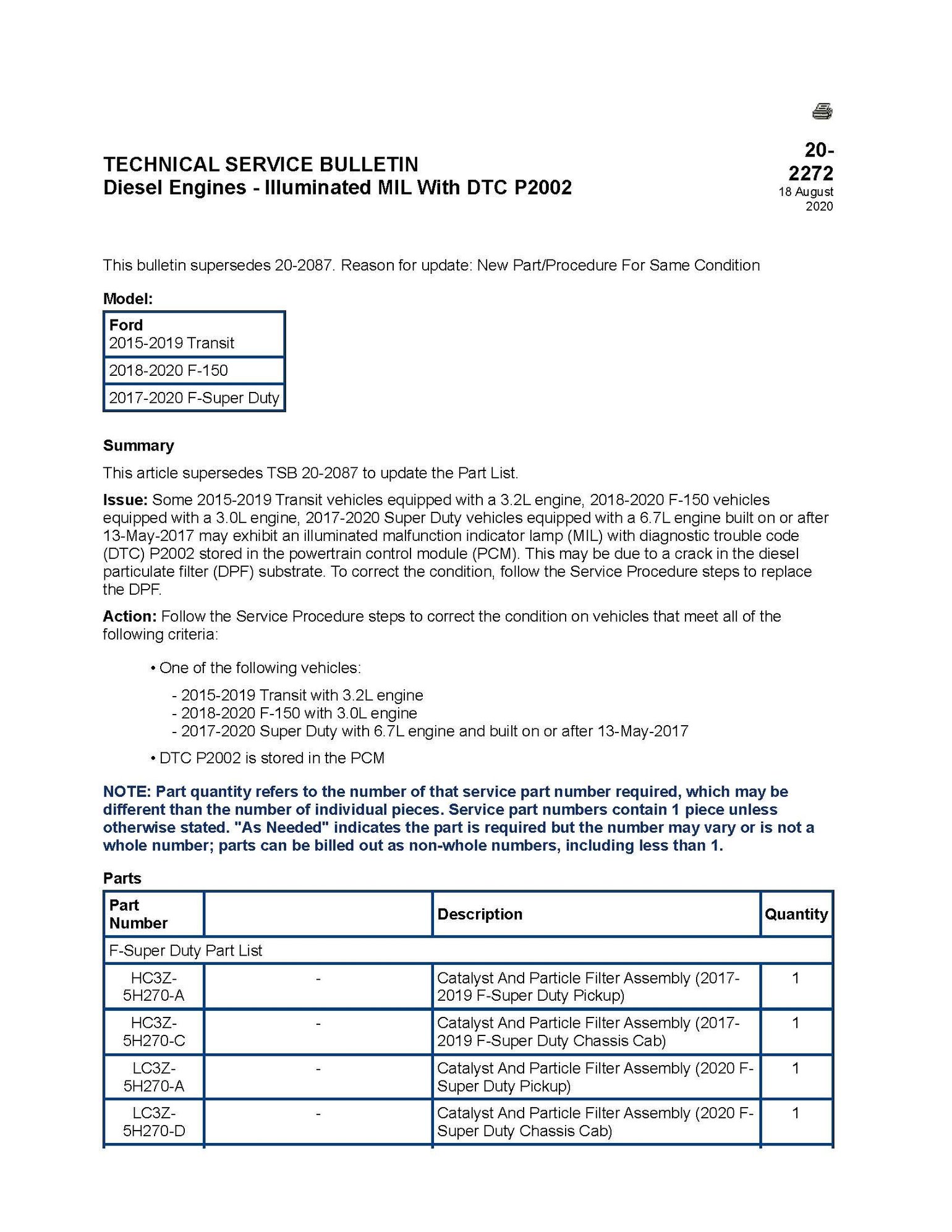

Dpf is cracked but without a p2002 they won't do anything.
If it failed emissions they would be forced too.

not being funny...doesnt look bad too me..more like gray color

It's still not normal and the real risk is when it does eventually trip a fault at 55,000 miles or some post emissions warranty number with engine de-rate and now you're purchasing a new DPF that had known issues under warranty, if you can even get one.

lighting.
they are the same color an my '97 with 4" strait pipes and stage 1 injectors.

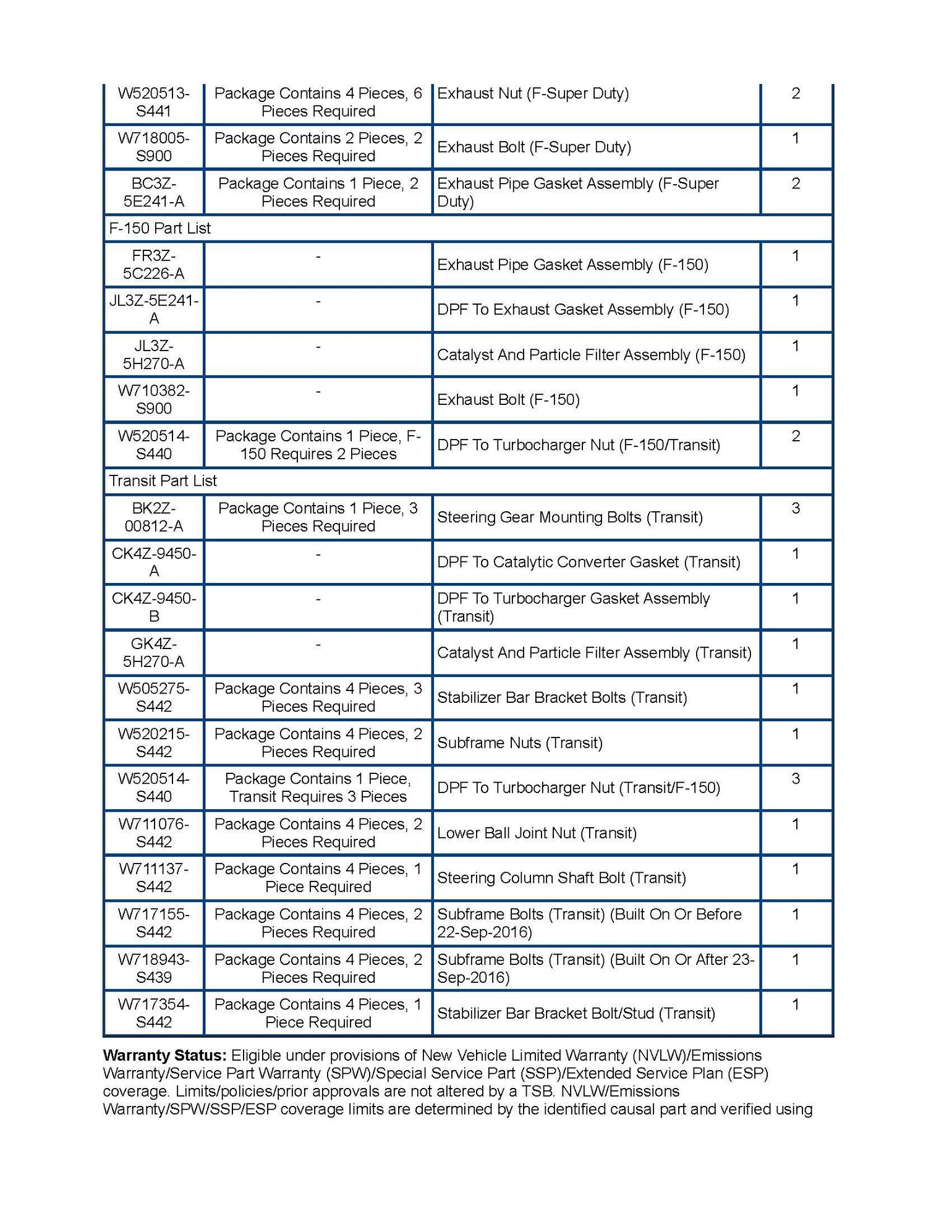

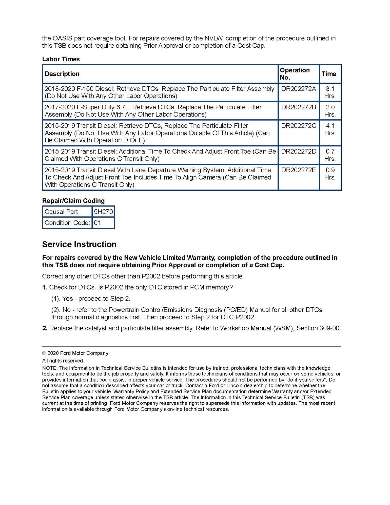

truthfully this falls under this TSB if you think about it. You just lack the code, but maybe this will help with your case?
