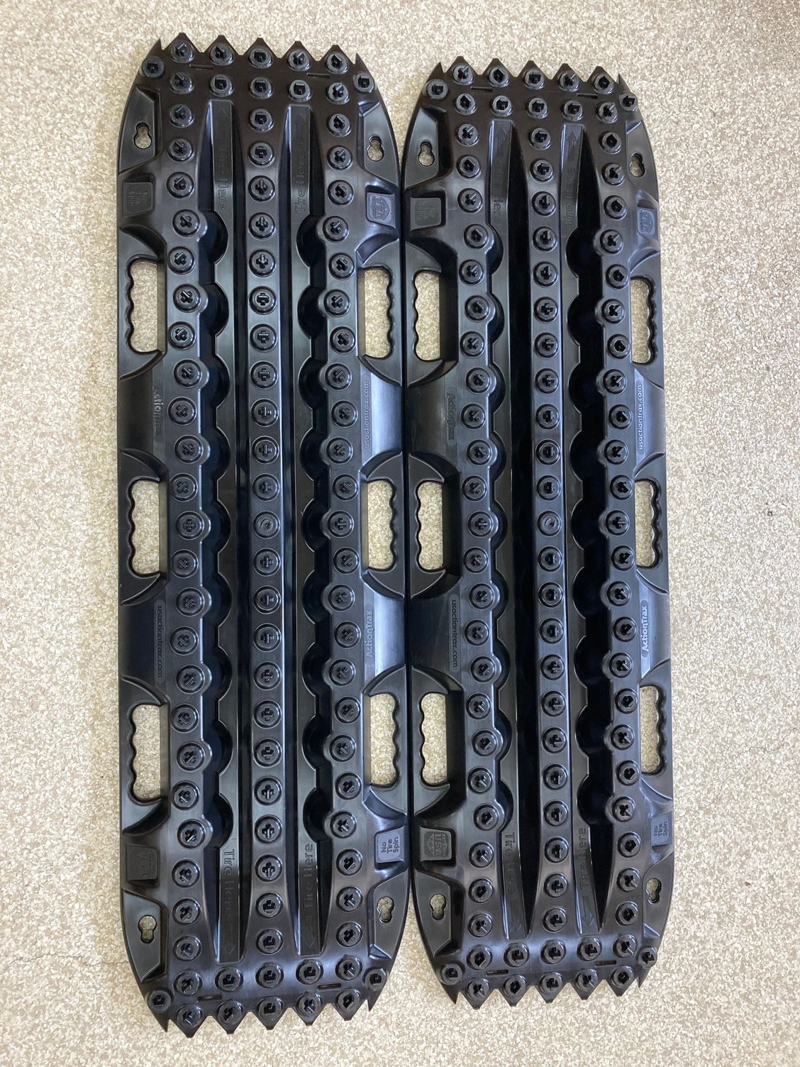

I’ve driven in snow and ice in multiple cites with a two wheel drive and have never been stuck.
For the EX, I have a TrueTrac LS, that helps, but I also have these:
and a shovel if that’s what it takes.
When I lived in Rochester, NY, I had a set of good snow tires and 300 pounds of kitty litter in the trunk of my Caprice Classic.
