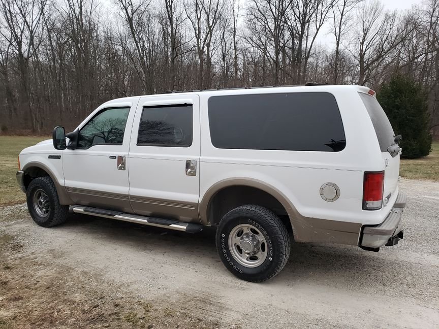

Here is a picture of it after driving 9 hours through partially salt covered roads from Virginia to Ohio. As soon as it warms up its going in for a deep wash.
It is pretty bone stock. The only things wrong with it that I have found (so far) are:
1. The check engine light is on. I was told this upon inspection and we checked the code together. It reads transmission speed sensor or something. It is a $58 part if that truly is what is flagging the code. The vast majority of these codes are for that part and not the tranny. It shifted super smooth and no issues for the entire drive back. I was told that this came on after he had a tire blowout a couple weeks ago that damaged the inside front drivers side wheel well. Perhaps there are wires from the sensor that run up through this area and it may be a wiring harness fix to the sensor instead.
1b. Related to the first is the wheel well. Any ideas on where to find a replacement or is a junk yard my best friend on this?
2. The cruise control does not seem to turn on. Maybe this is associated with the sensor and or wheel well/wiring issue.
3. No remote unlock key FOBs. He is going to find them and send in the mail (hopefully). I do have the key code for the door buttons though.
4. The steering is annoyingly loose, but not horrible. This could be a zero dollar adjustment of the steering box or hundreds of dollars. Either way I'm getting it fixed. I HATE loose steering.
Picture of damaged wheel well below...

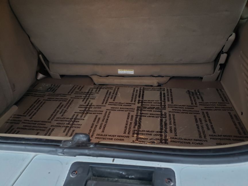

It still has the plastic dealer covering in the rear hatch area. I'm debating whether to tear this off or not. I can't believe its been on there for 21.5 years!

Nice! Was it a Firestone or General tire that blew? I would think the best place for that inner fender liner is going to be a wrecking yard...even if you can get an aftermarket it probably won't have the quality of the oem unit. I bet you're correct about that sensor and/or wiring relative to the codes. I would leave that dealer covering intact and put a weather guard type mat over it...we have one that's the matching beige color which also has a lip to contain spills.

Looks like a winner!
I agree on a parts yard being your best bet to find the inner liner, I would think any Super Duty liner from that generation should match.
Go through everything in that area looking for your any wiring that looks like it might have been damaged and address that to see if it helps with the codes.

I do not know what brand blew. I assume that it was a general tire that blew and he replaced them with the firestones since they look newer.
Good advice on the weather-tech mat to go over the plastic!
