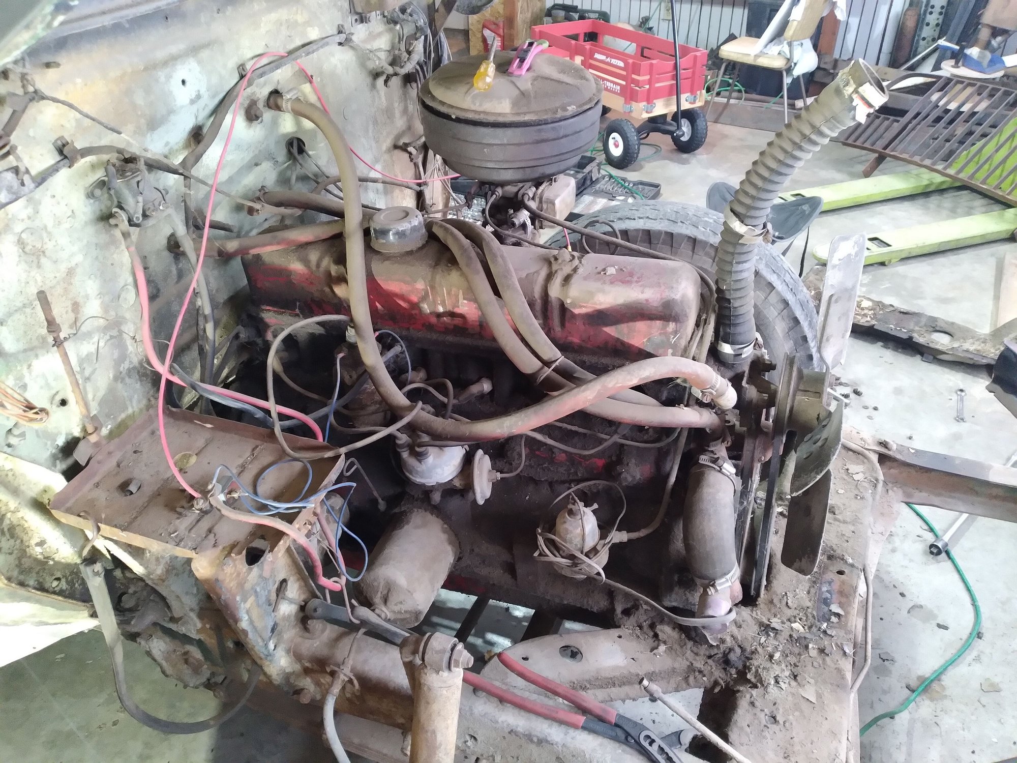

Please help! New to the forum and trying to figure out what motor was originally in my 1952 F-2 and what is currently in it now... the vin on the frame is F2D2RH17873 the number I found on the block is EAA-8015-B it is very similar to a 215 but I noticed the oil filter is closer to the starter on mine and all the other 215s ive seen, the fuel pump/filter is closer to the starter...

EAA 215 cu. in. I-6 1952-53 Ford OHV six cylinder. Increased to 223 in '54. See EBP

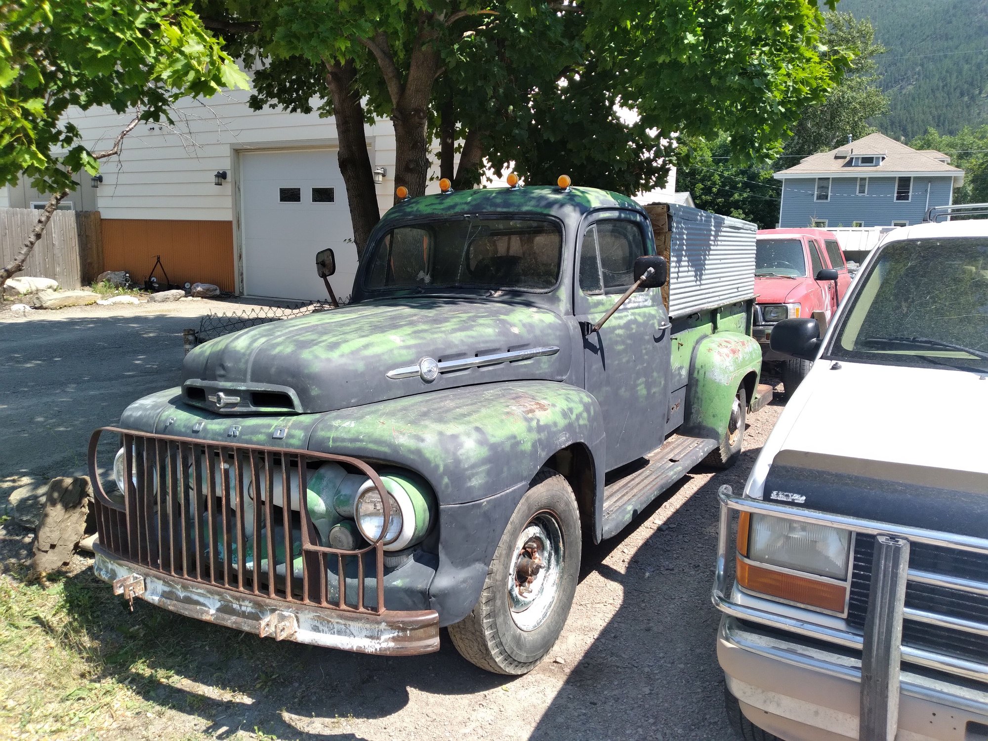

Roger,
nice truck. Thanks. How long have you had it?
And I don't know what EBP is either. LOL

thank you, my grandfather gave it to me as my first truck about sixteen years ago on the drive home I blew the soft plug on the back of the block and parked it. I fired it up a couple times just to make sure and it still runs great.

That is a 215 in your pictures. The very similar motors with the distributor moved forward are the 223s (or the not very common 262s).

Awesome! Thank you for clearing that up, one more question i have is what is the metal tube next to the bellhousing behind the exhaust manifold? What does it do?
That is your crankcase vent, better known as a road draft tube. As you drive, air passes by the end of the tube creating a vacuum drawing crankcase fumes and pressure out. In the 60's the road draft tube was replaced by the positive crankcase ventilation system, or PCV valve.
