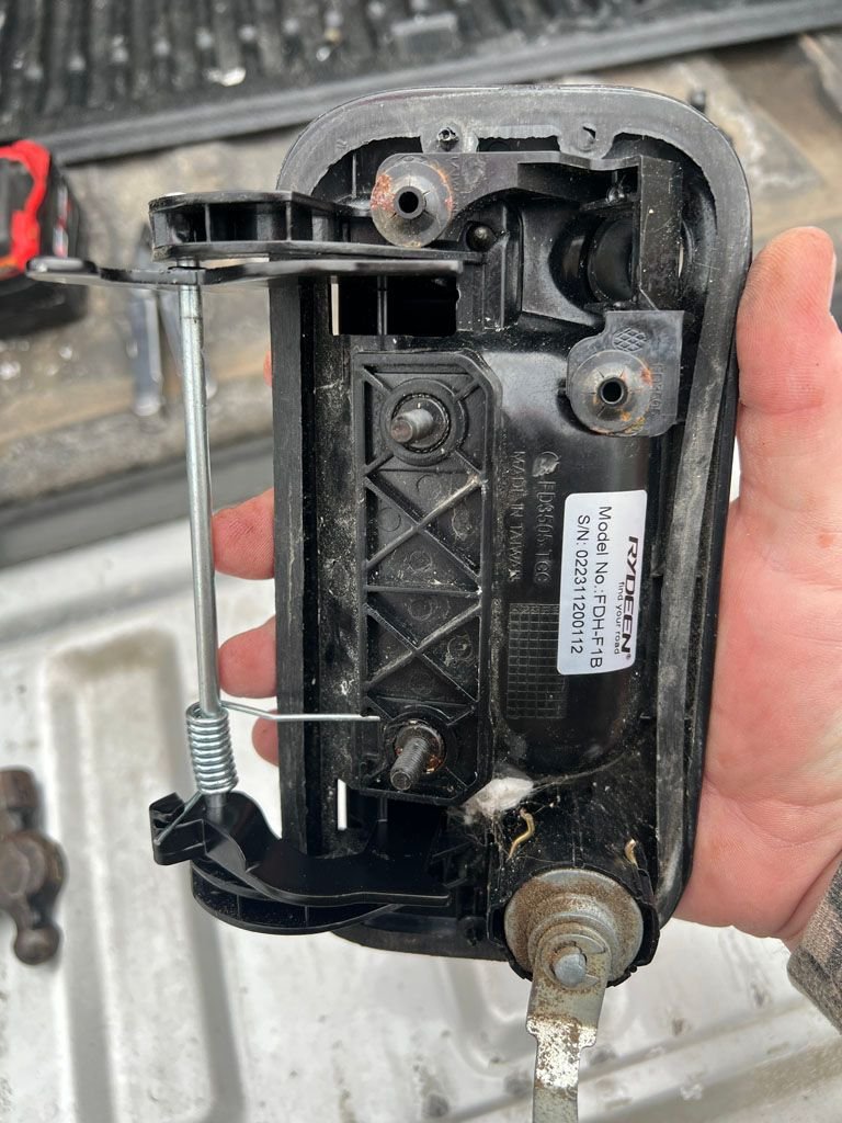

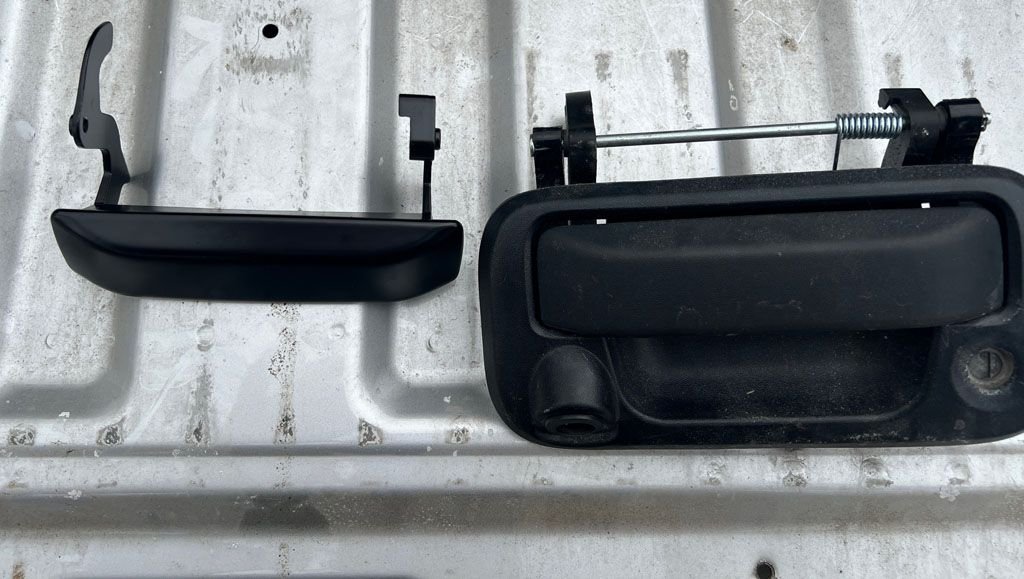

Installed the metal handle this afternoon. Here is how it went.
Metal on the left. Plastic OEM handle on the right in the Rydeen frame with camera hole.
Metal Handle installed in the Rydeen frame. Original handle broke into 3 peices last week when the handle broke while opening the tailgate. I found the original OEM handle on another frame when the tech replaced the failed camera last year.
Installed in the tailgate. There is the fit of the part. While I had the tailgate open, I gave it a quick shot of silcone lube on all moving parts. Much smoother.
From the outside. Looks like a stock handle. Retains all other function.
Here is a video of the handle in action Youtube unlisted. Click on the link
If you have any questions, just ask. It took about 15 minutes to swap out the plastic for the metal. The plastic panel in the back is held on 8 T27 torx shoulder bolt screws. There are a handful of plastic push in body clips. In my case, I had 2 10 mm nuts holding in the handle assembly.
