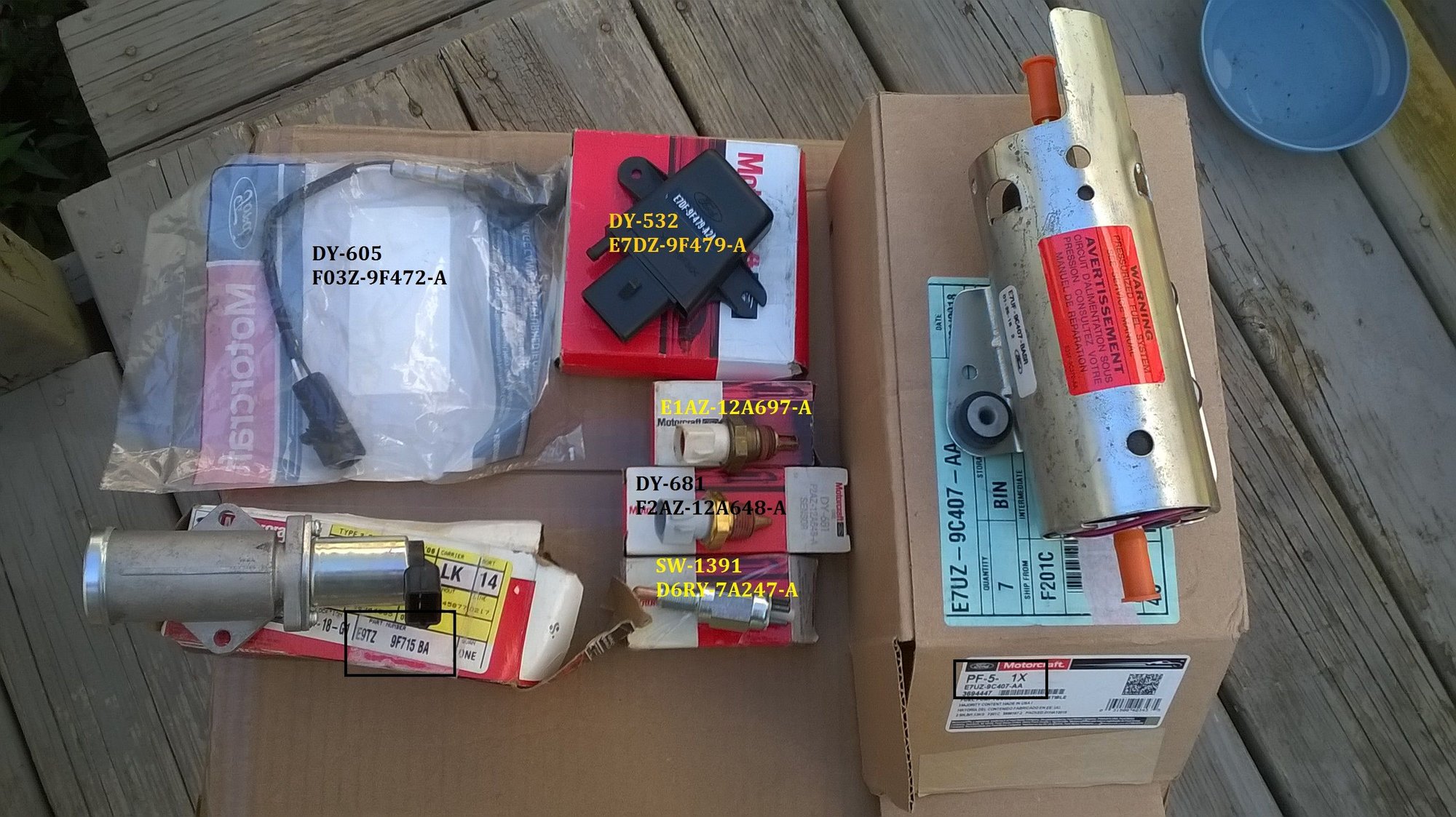

I agree with Conanski that it sounds similar to a the IAC or EGR sensor. Can you post a pic of the part?
Does it look something like any part shown in this pic?

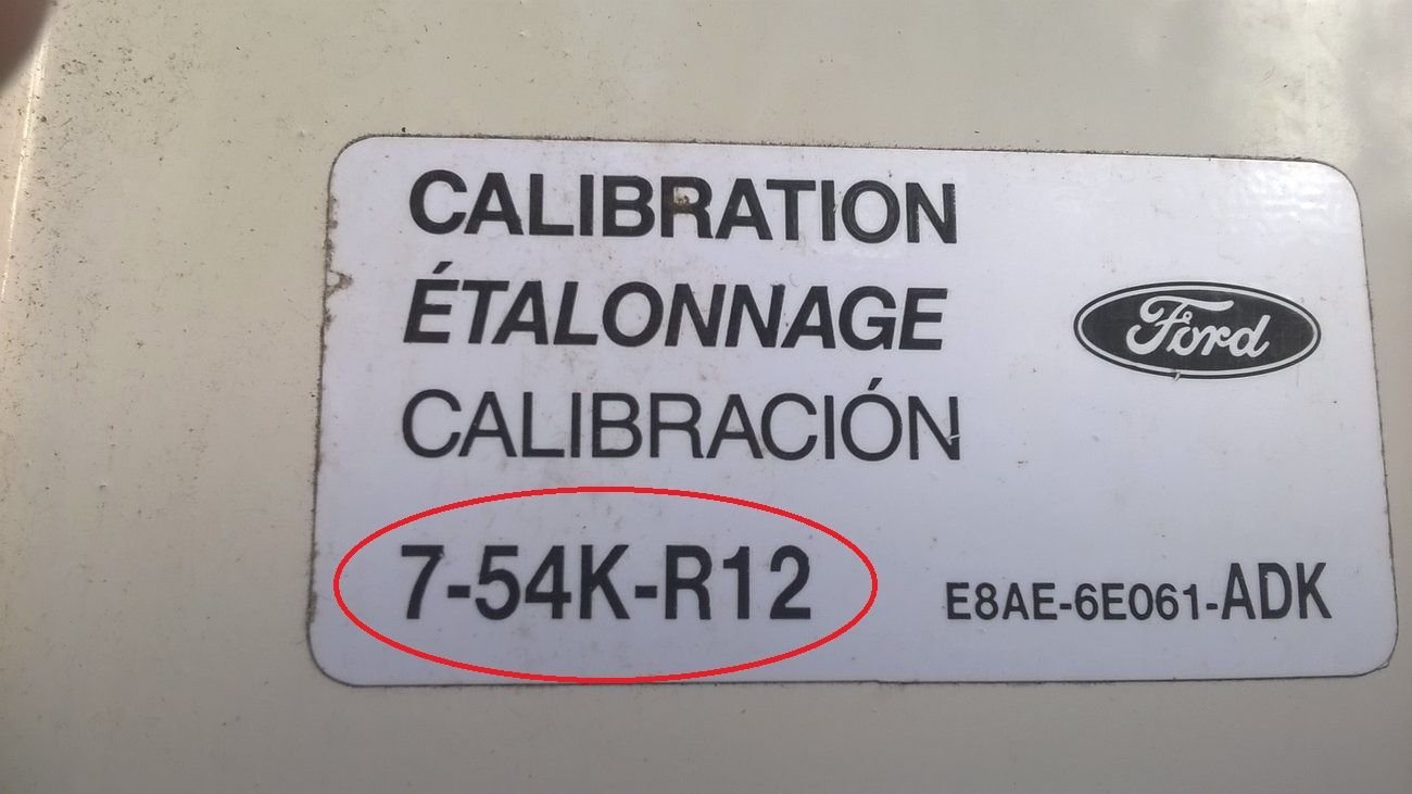

Also do you have a calibration code sticker on the door jam? Should look something like this... If so, then if you can post the number, then one of us may be able to pull up the correct part number once we know what the part is.
If it is an egr valve then it will look similar to one of these minus the position sensor.

Thanks Conanski and Annaleigh for your replies and help. I got your messages late this evening so I will try to answer the questions and provide a photo or two tomorrow. However we are expecting snow tomorrow and being a woose, it may take me a day or two to get back to you. A quick answer to one question however is that the part I have looks a little like the part show in the lower left corner of the picture of parts provided by Annaleigh. It has the exact same electrical connector, it is cylindrical like the picture example however the attachment flange is at the bottom, not the side as with the photo part. In the middle of the flange a tube extends about 1/2 inch which penetrates the engine when it is bolted in place.

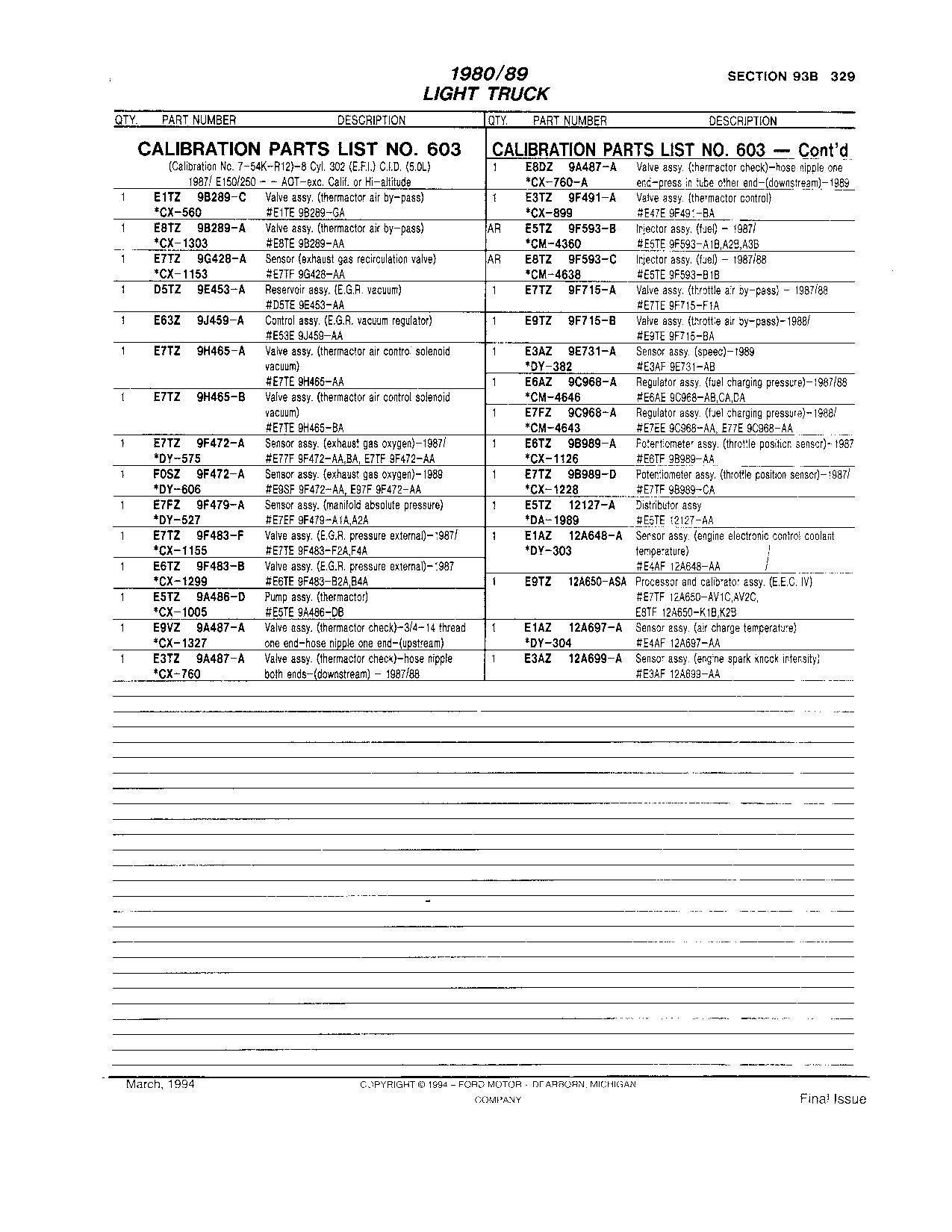

Glad you identified the part. The lower left part in the pic is in fact the IAC used on my 88 E150 with a 5.0.. Since you have a 89 with a 5.8. the IAC might be different.. That is part of the reason why I ask if you could find your calibration code number. With your calibration code I could probably find the ford factory parts list used for your specific van. Below is a copy of my calibration code parts list. All but the fuel pump in my pic above are parts for my van as per the calibration code sheet.
The IAC is known as the Valve assy. (throttle air by-pass). There were 2 different ones used on my van

Those older InverTec, Falcons were really nice RVs and if Teh RV and your engine and transmission are in good shape then don't get discouraged and throw your hands up in the air! It is most likely fuel or sensor related... The pic of motorcraft parts are just some of the sensors and parts have been collection over they past few years. Last year I started replacing all of the old used 33 year old sensors with the new ones I had been collecting just as preventative maintenance. As Cornanski recommended, I have kept the old parts because all but one of them was good and I saved them for a spare..
