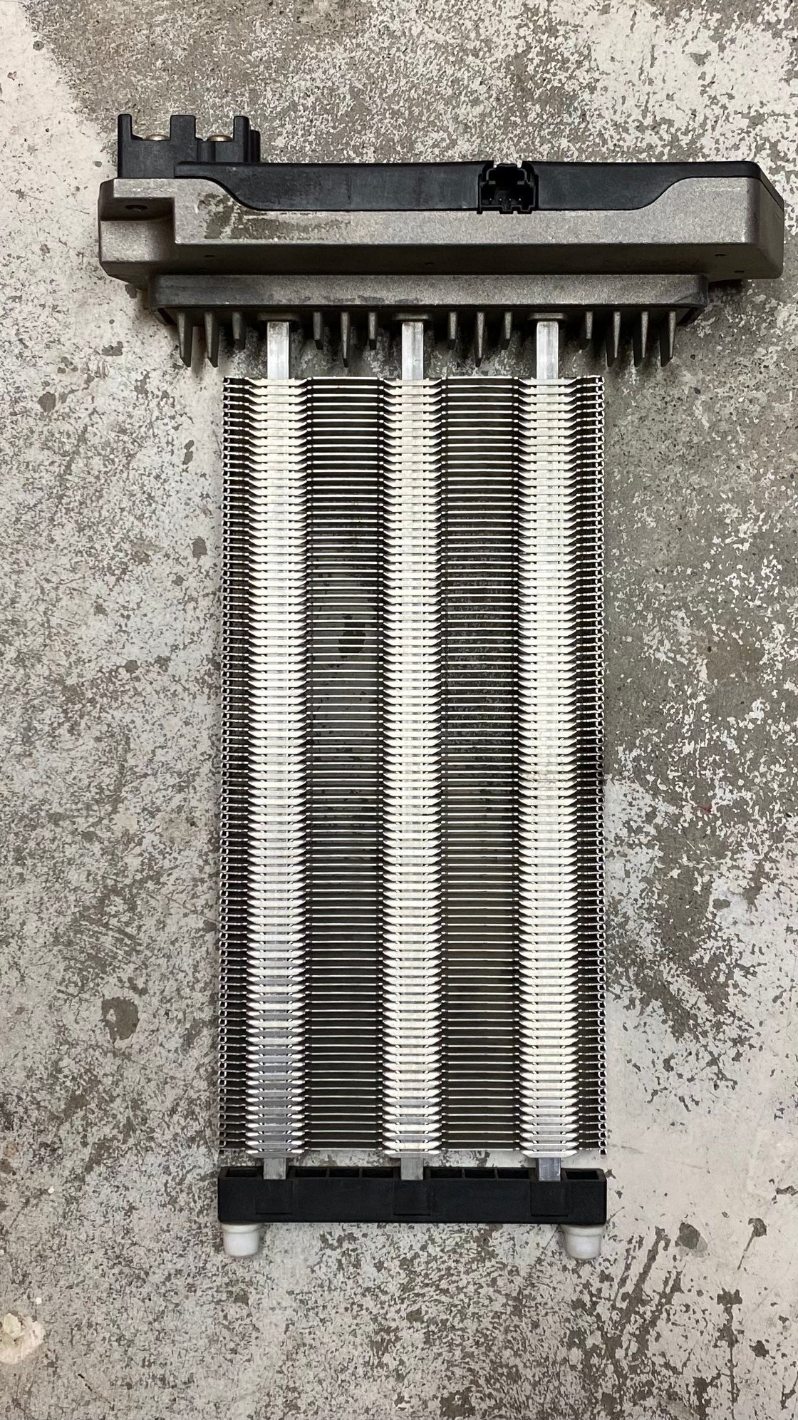

I’m not sure if Ford change any of these parameters form the earlier Rapid heat systems but on 08-10 trucks the rapid heat uses theses parameters to turn on:
Engine rpm: >500
Engine coolant temperature: -40c - 83c (-40f - 181f) turns off >84c (183f)
Alternator load: 0-15% low heat mode, 16-85% full heat mode, 86-96% low heat mode, 97-100% turns off
HVAC request for rapid heat, requires HVAC to be set to heat mode.
Note: these are the parameters that the rapid heat requires to turn on, the HVAC has its own requirements that must be met before request the Rapid heat to turn on.
Rapid heat has 3 heat settings, each heat setting draws 40A for a total of 120A.
Here is what the Rapid heat unit looks like
