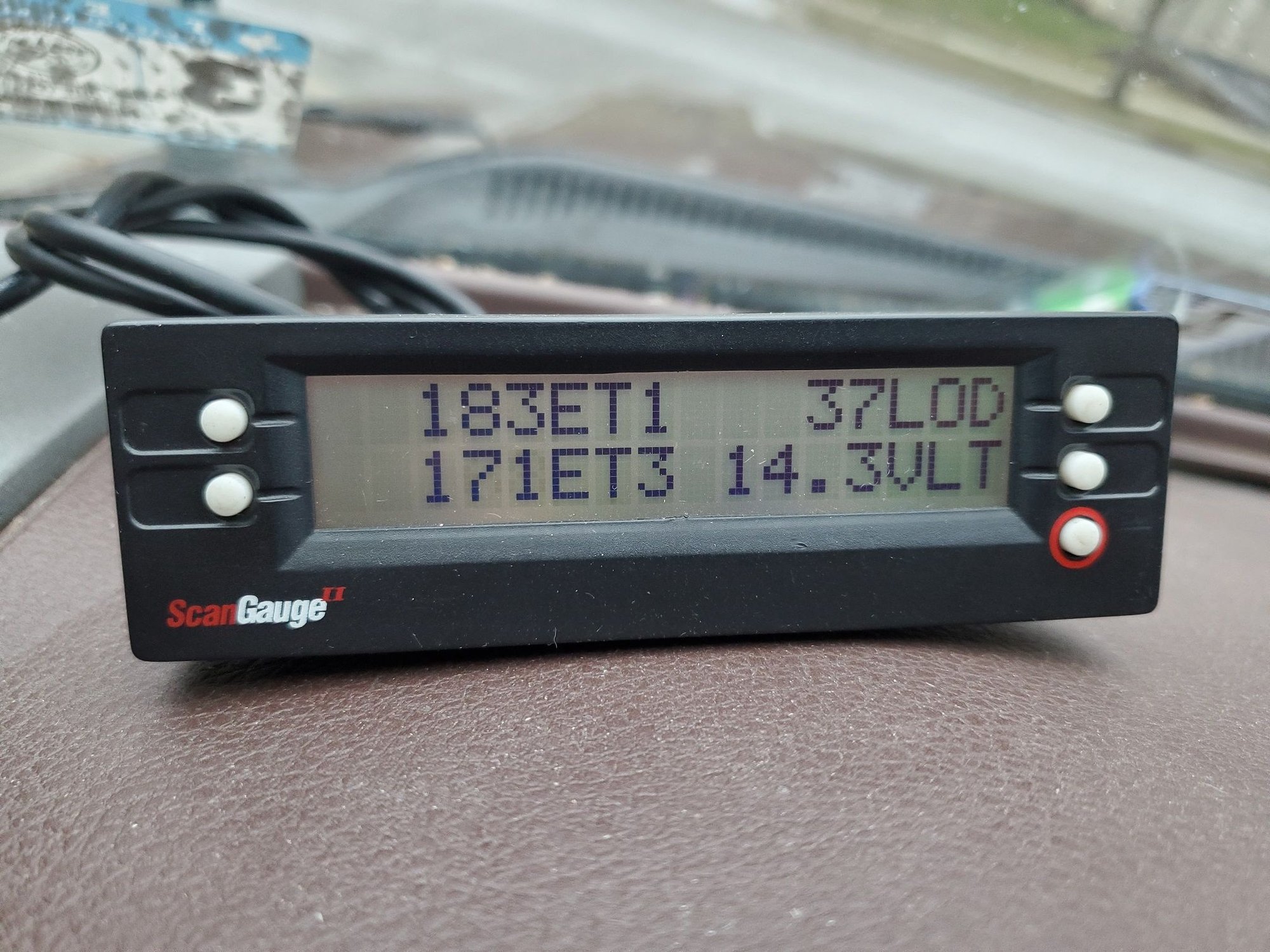

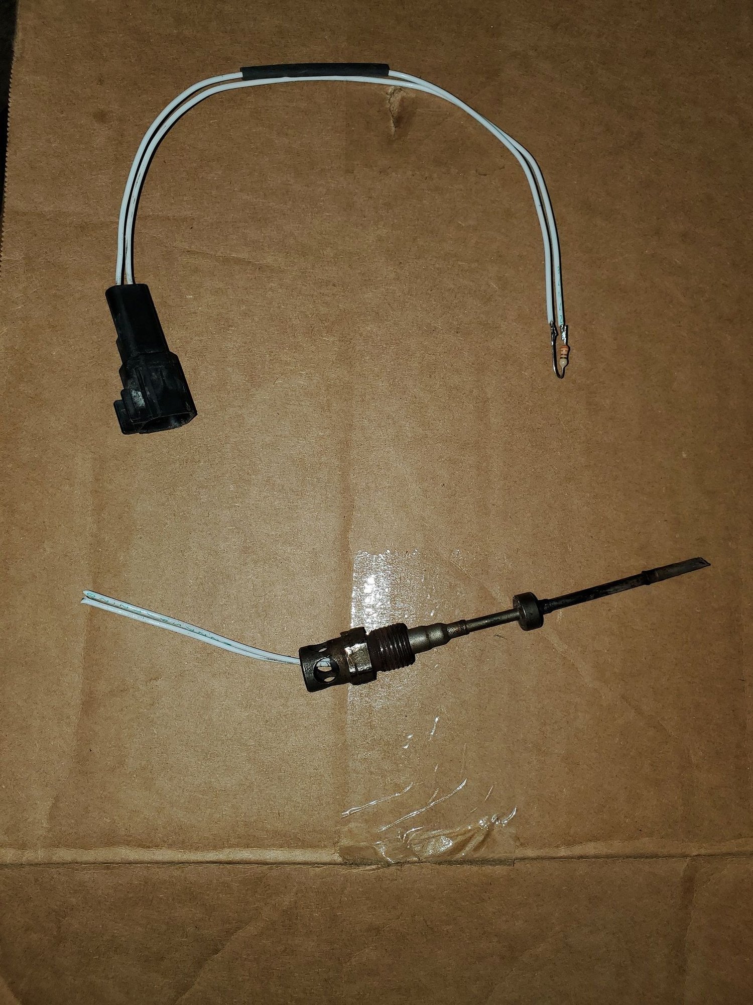

330 ohm resistor on the old sensor wire:
Result?
168-175deg reading on EGT3 (bottom left number):
I checked the results with a couple of on/off cycles to see if the computer would throw any codes on shut-down/restart. Nada.
Success!

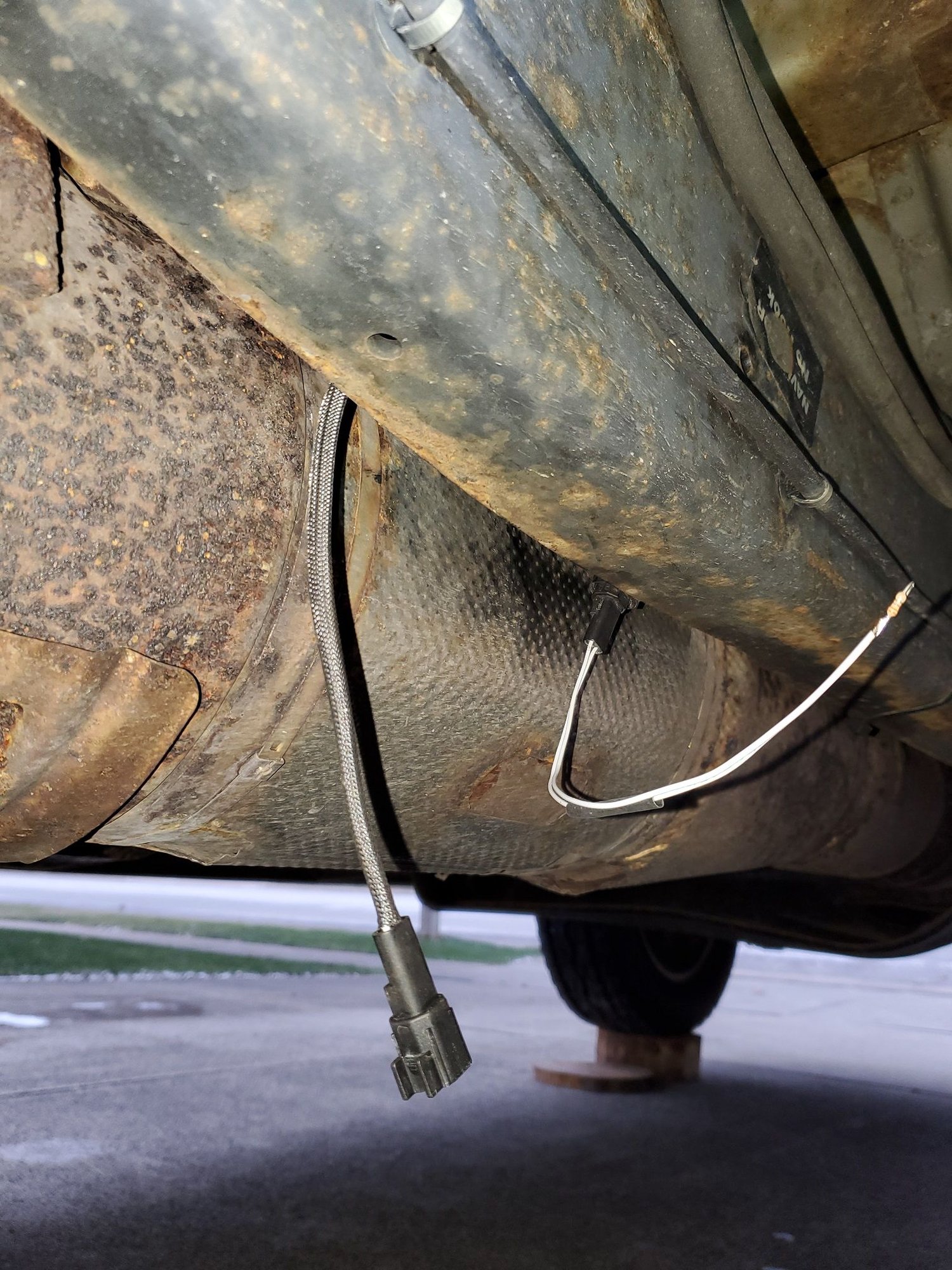

I sealed everything up with heat shrink and tossed it in the truck so its ready to go:

Of course this isn't a permanent fix. The idea is it is a "pop it in the connector and go" emergency fix to get off the road. It sure beats trying to wrench out an old EGT sensor on the side of the highway. A couple minutes to get to the old sensor connector and pull it apart, pop this in place, clear the codes, and off ya go.
The exhaust system gets HOT - I wouldn't want this rubbing up against the exhaust pipe so having a way to secure it back away from the pipe, in the case of my test here it was EGT3 so I could zip tie it to the frame rail, for example.

On a bit different topic - I tried to check the resistance of the old sensor. I didn't think it had completely failed, but I got no resistance out of it (open circuit). I even put it under flame for a few seconds to try and heat it up - nada. Deader than a door nail. That makes me wonder if it failed completely when I removed it? If it had gone open while still in - why was the truck not shutting down?

Interesting. I suppose another "data point" is the ScanGauge display - I did not find it reading odd ranges, or 0. Though, I did not specifically pay attention to it.
I will try unplugging the sensor again and cycle on/off a few times and see what codes/messages it throws when I get a chance.
