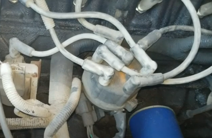

Does anyone have a picture of the distributor installed on a 95 f150 4.9? I need the orientation of the cap screws and electrical connection please.

dirty but maybe you see it.

Thank you very much
