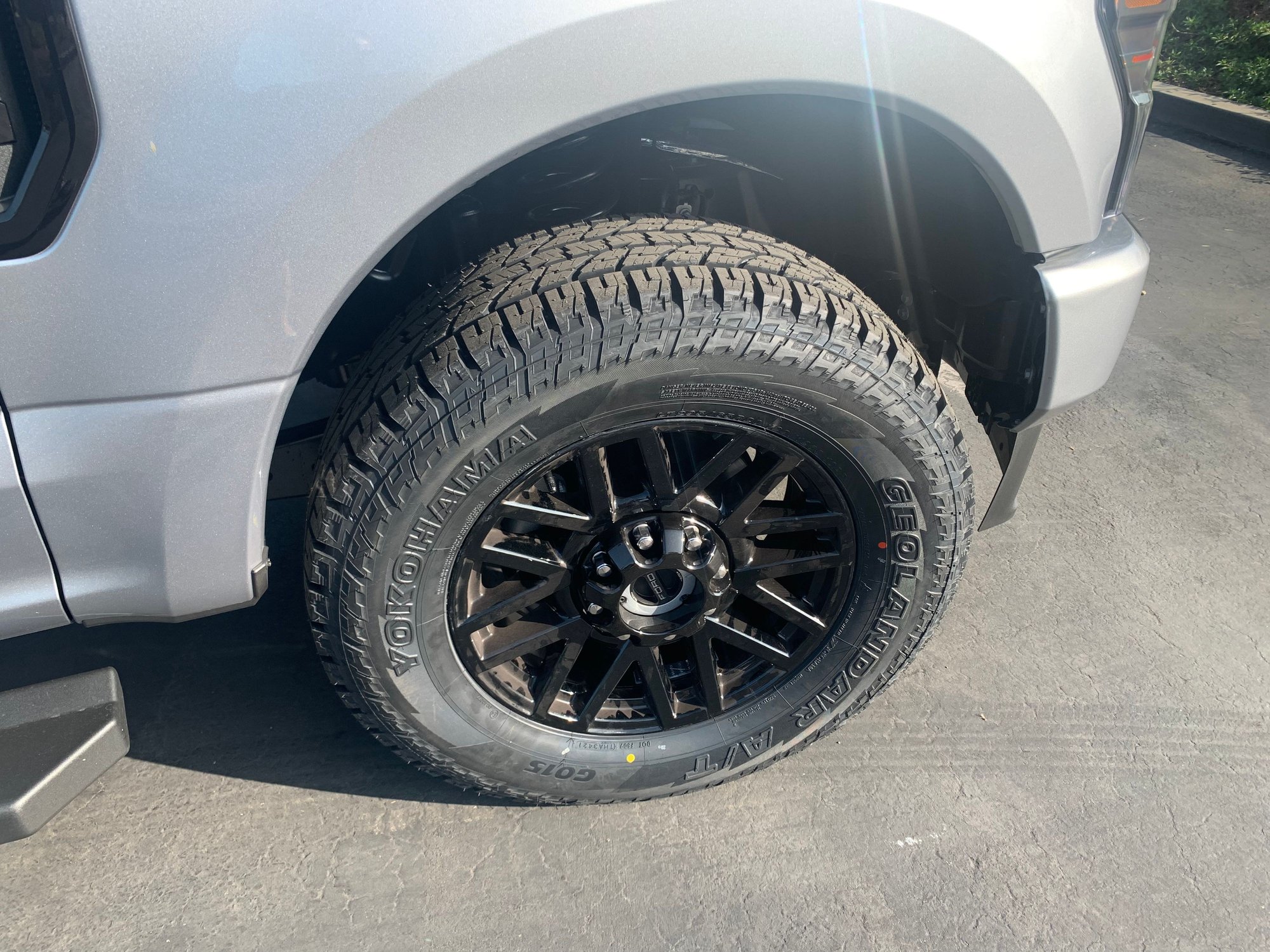

I’m liking these for the quiet ride and 3PMSF.
