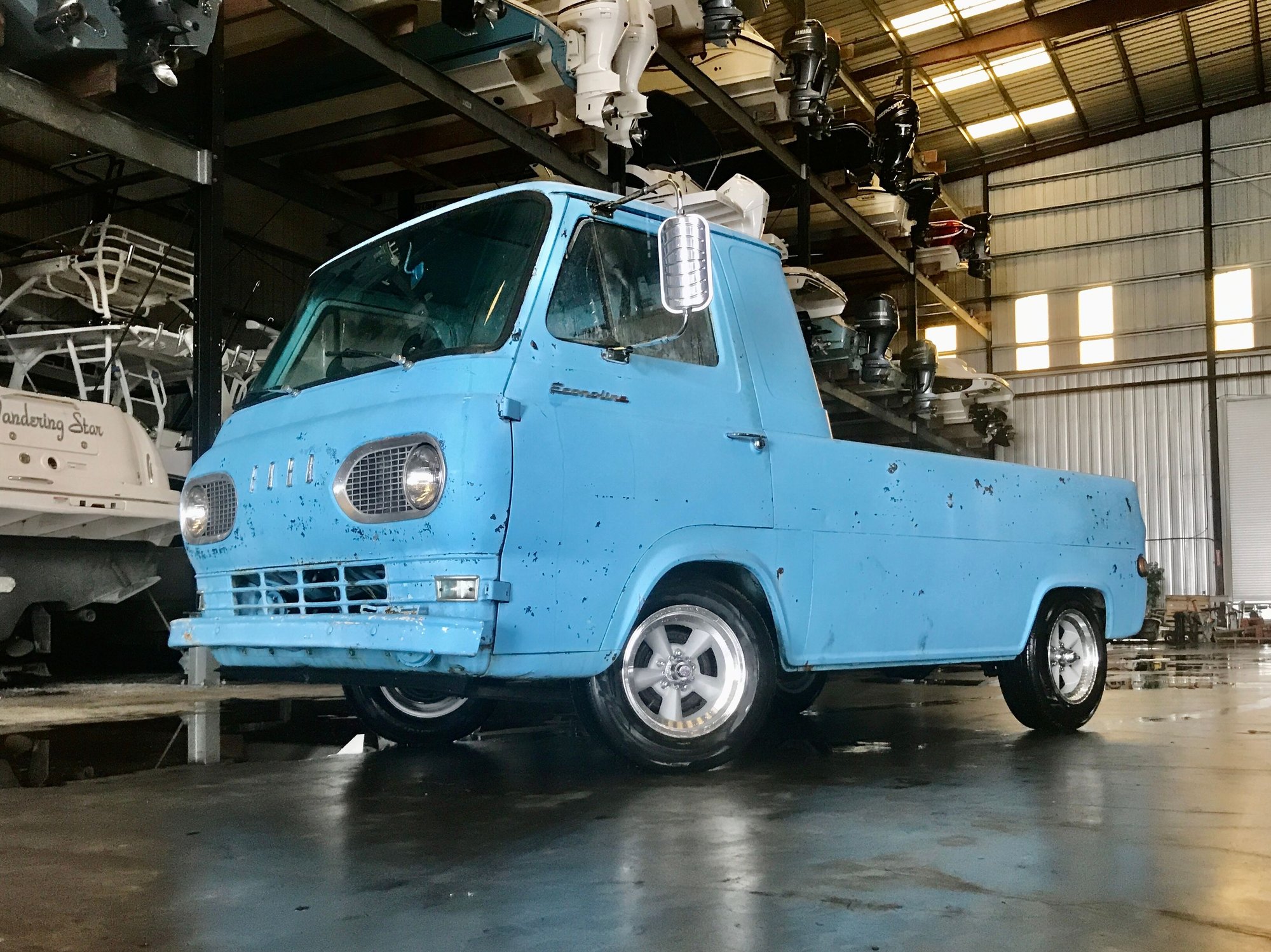

Gentlemen, If I purchase a '65 econoline pickup this weekend It will be my daily driver. Among other things I will want to tow my trailer with it, and drive it in the snow. From past experience passenger car tires are NG for towing a heavy load so I'm going to need light truck tires, also I want a good tread in the rear for the snow. I was hoping someone could give me a largest size recomendation for wheel and tires both 14" and 15".

I’ve got 205/70R15’s on mine. It’s lowered 2” and nothing bigger will fit the front for sure.

thanks, that's what I'll shoot for then. Oh hey any idea what the backspacing is on your wheels?And how wide are the wheels.
