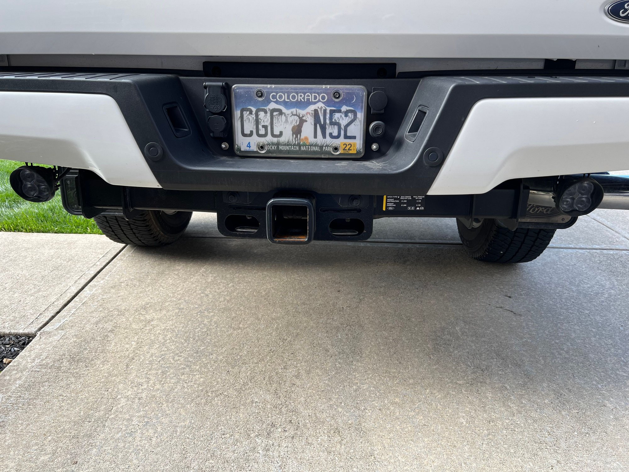

These are from superbrightleds.com. Mounted using the existing bumper bolts, wired to an upfitter.

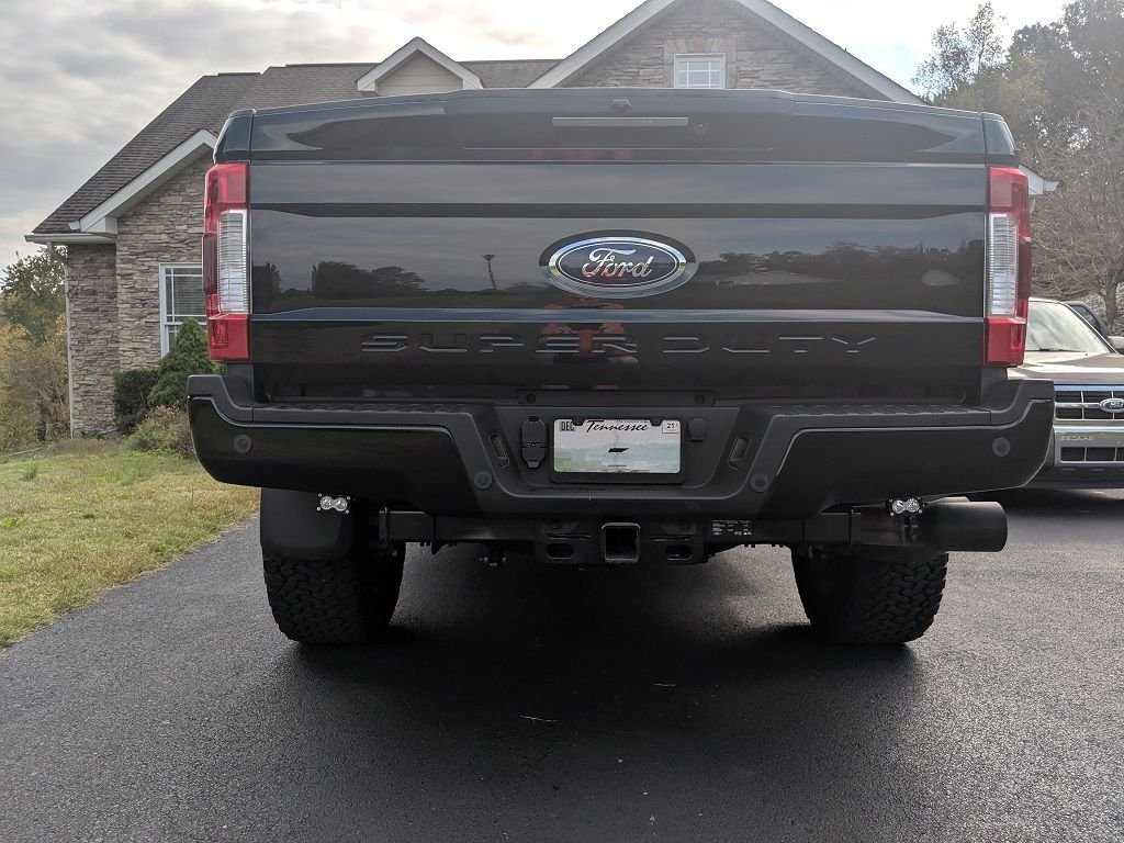

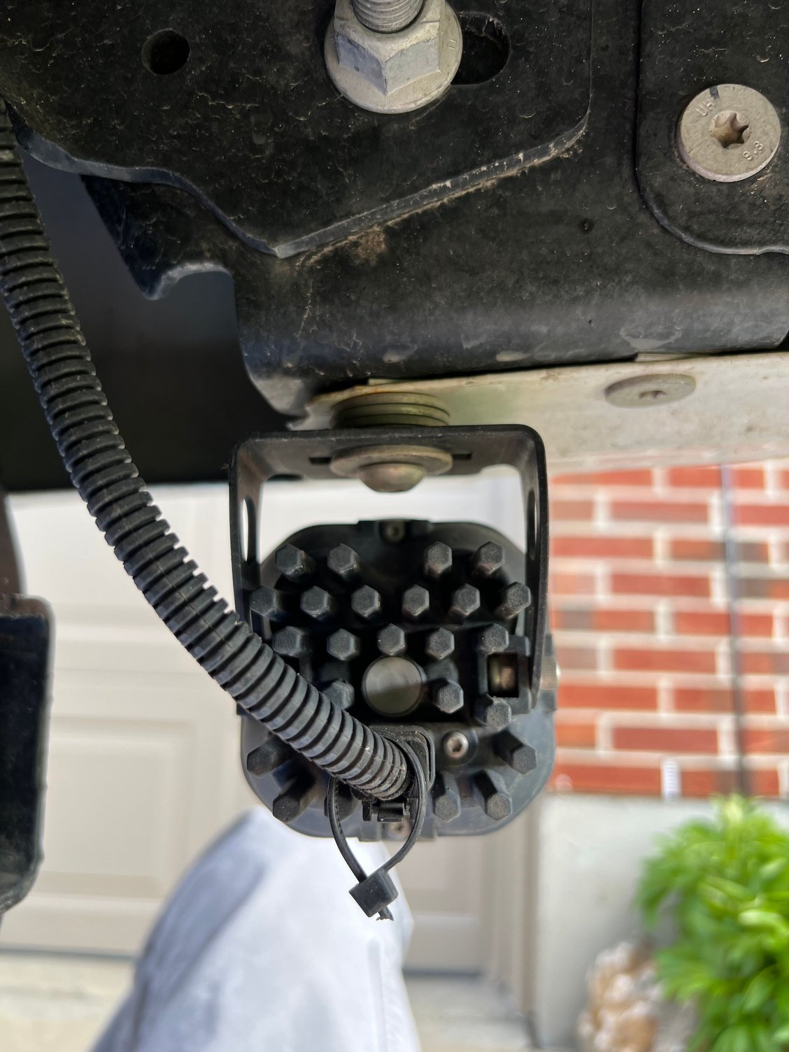

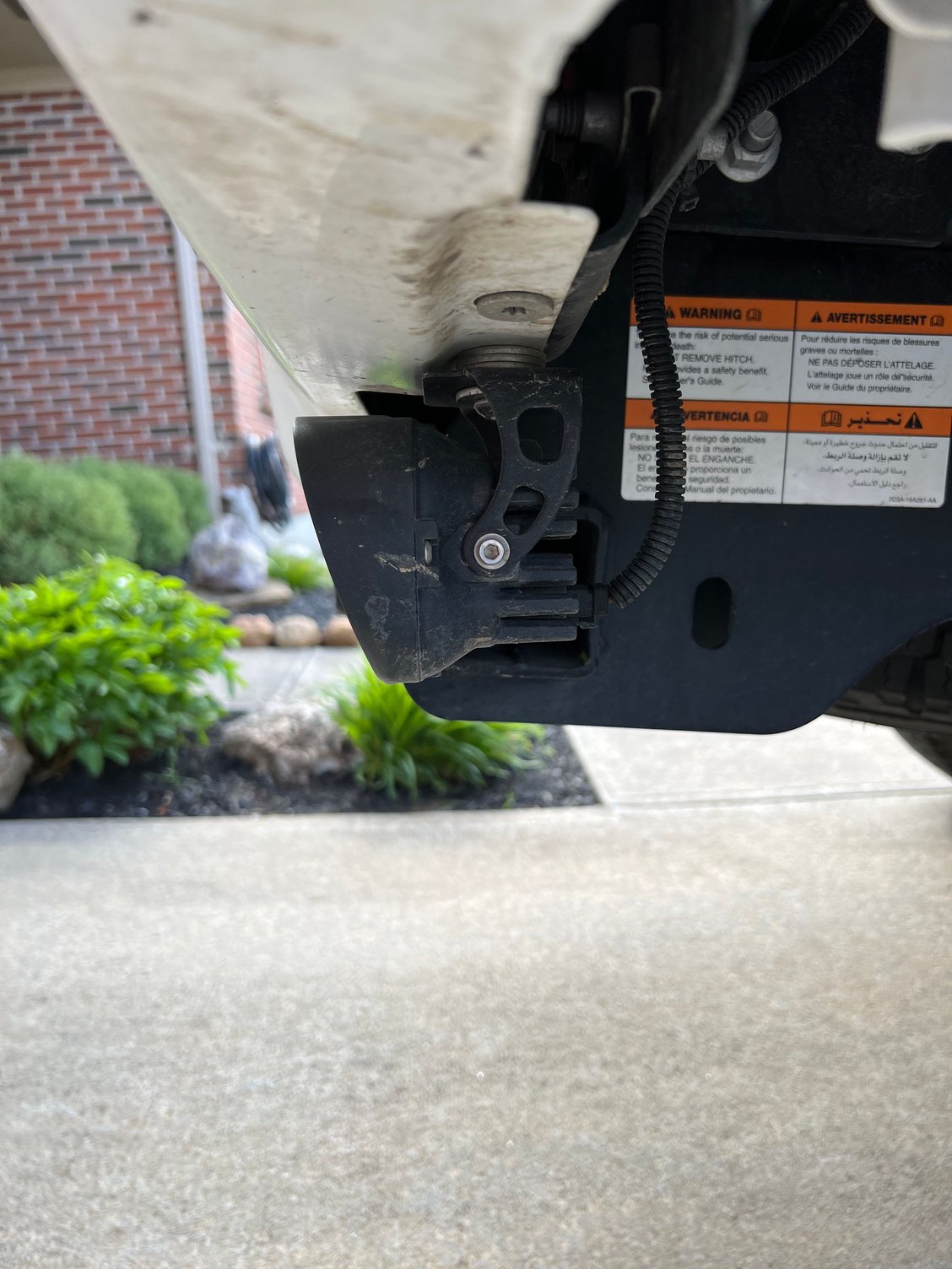

I installed a pair of these after seeing how well they work on my tractor. Two reflectors on each light - one spot pattern, one flood pattern. Solid aluminum body, O-ring seal between the cover and body. I took one apart and flipped it around so the flood pattern was on the outside of both sides. They are wired via a relay to the 7 pin hitch so they come on in reverse but only when my lights are already on. I also connected them to an upfitter switch for manual operation. They are not the cheapest out there but they seem to be pretty decent quality. The mounting hardware is stainless - I used an existing bolt.
https://usa.alpena.ca/trailfire.html

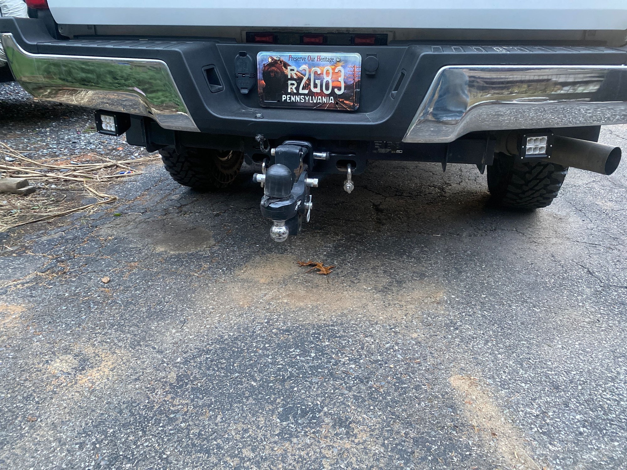

Always been a fan of under bumper lights on my truck. Added these last night. Wired to Upfitter switch so I can use them only when I want, don't like them tied into Reverse.
https://www.amazon.com/dp/B081DTRC46?psc=1&ref=ppx_yo2ov_dt_b_product_details https://www.amazon.com/dp/B081DTRC46?psc=1&ref=ppx_yo2ov_dt_b_product_details

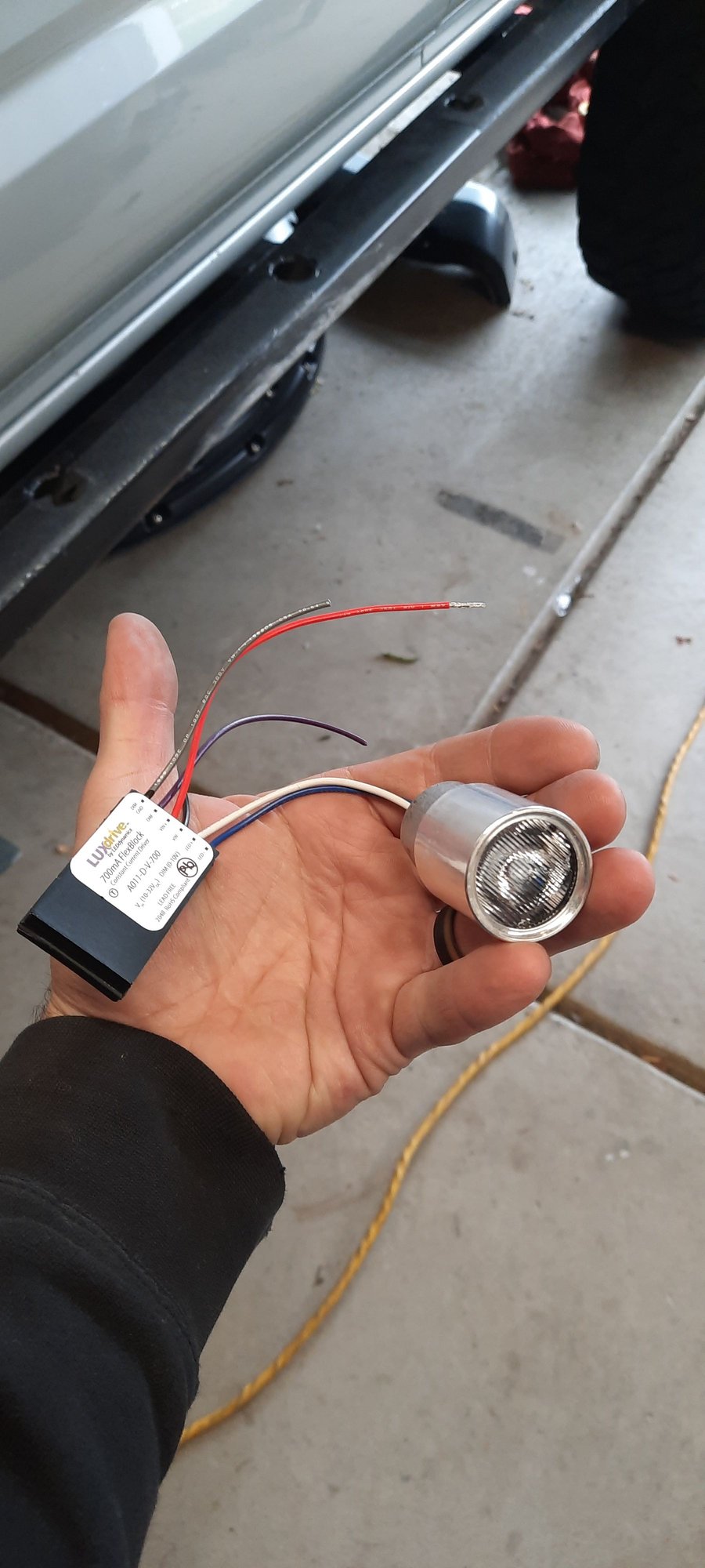

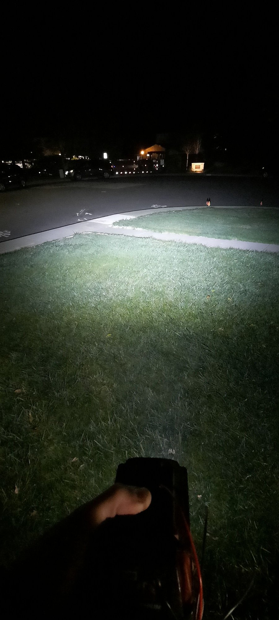

Currently building these. All I have to do is figure out the mounting. Plan is to flush mount them into the bumper
A true 1200 lumens per light, with a 45 degree wide optic. About a 1.25" diameter hole in the bumper on either side is all that's needed...

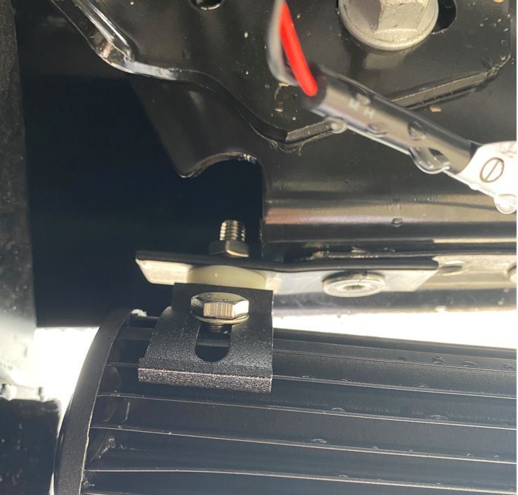

I have had great luck with all of my Diode Dynamics lights. For the rear I utilized an existing fastener location in the bumper. Stainless steel bolt washers and a nylon spacer to prevent galvanic corrosion

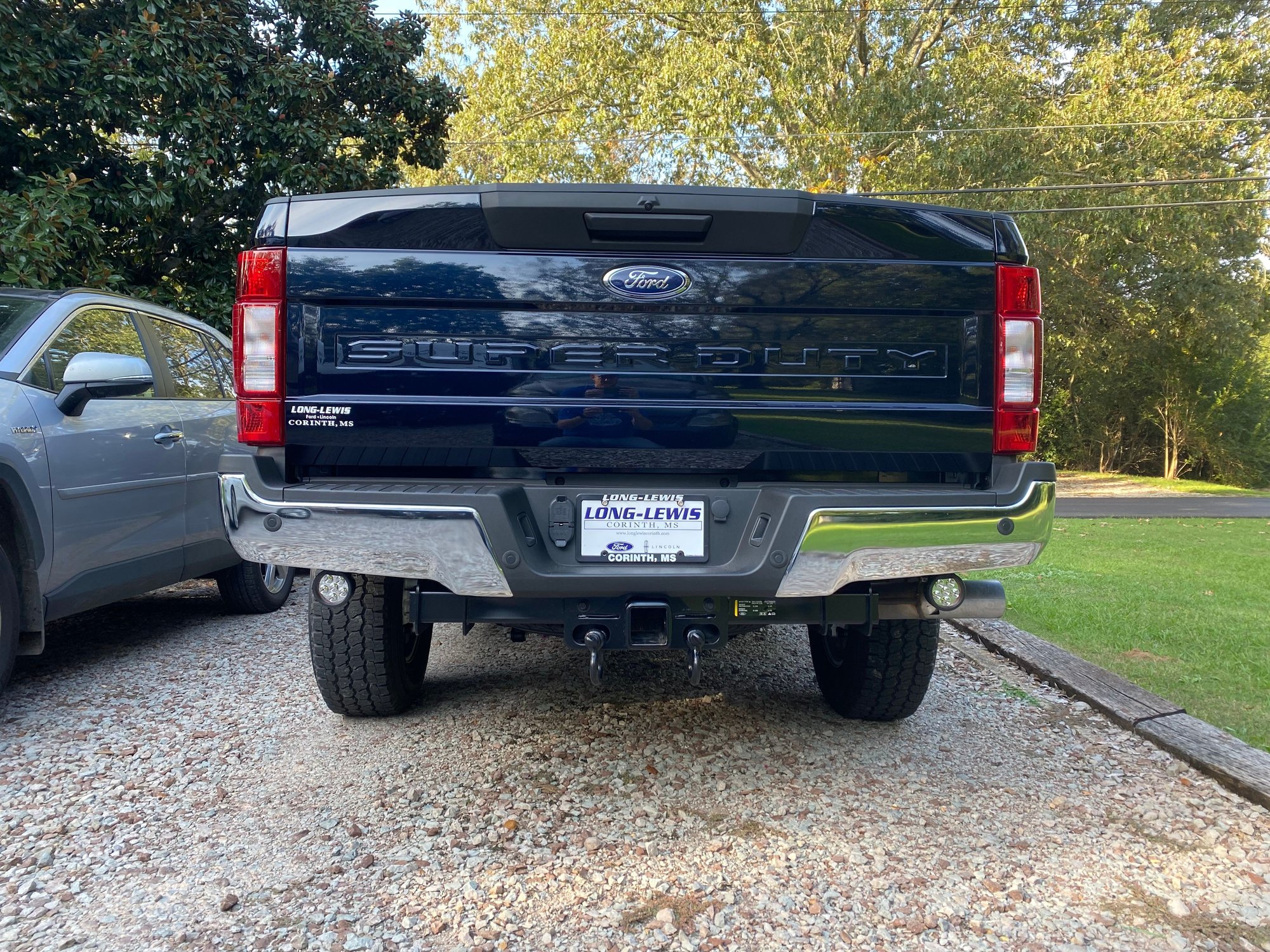

I mounted a set of $30 round lights from Tractor Supply last October using a pre-existing bolt like Squirrel did above. They have held up great so far, however I didn’t use a nylon washer to prevent the metals from corroding... I may go back and add one to each light. But so far so good. I like that they don’t look crooked since they are round, are easily and inexpensively replaced if needed, and I didn’t have to drill into anything to mount them.

The bumper and associated metal around it is steel. You won't have galvanic corrosion like when mounting steel to the aluminum body.

You wouldn't anyways. What about all the steel nuts/bolts/rivets going thru the aluminum body right now from the factory.
You guys act like a mixed bucket of screws is going to spontaneously turn into dust 😂
