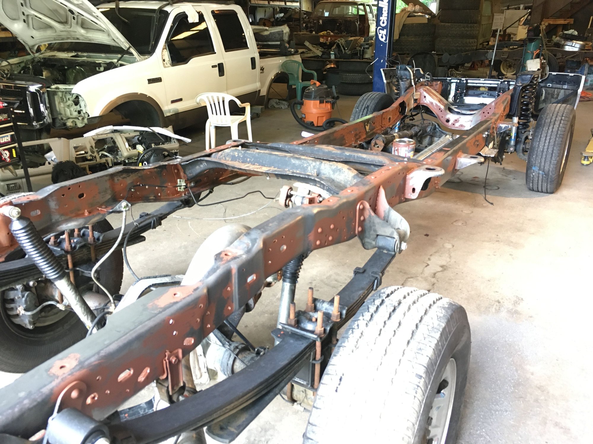

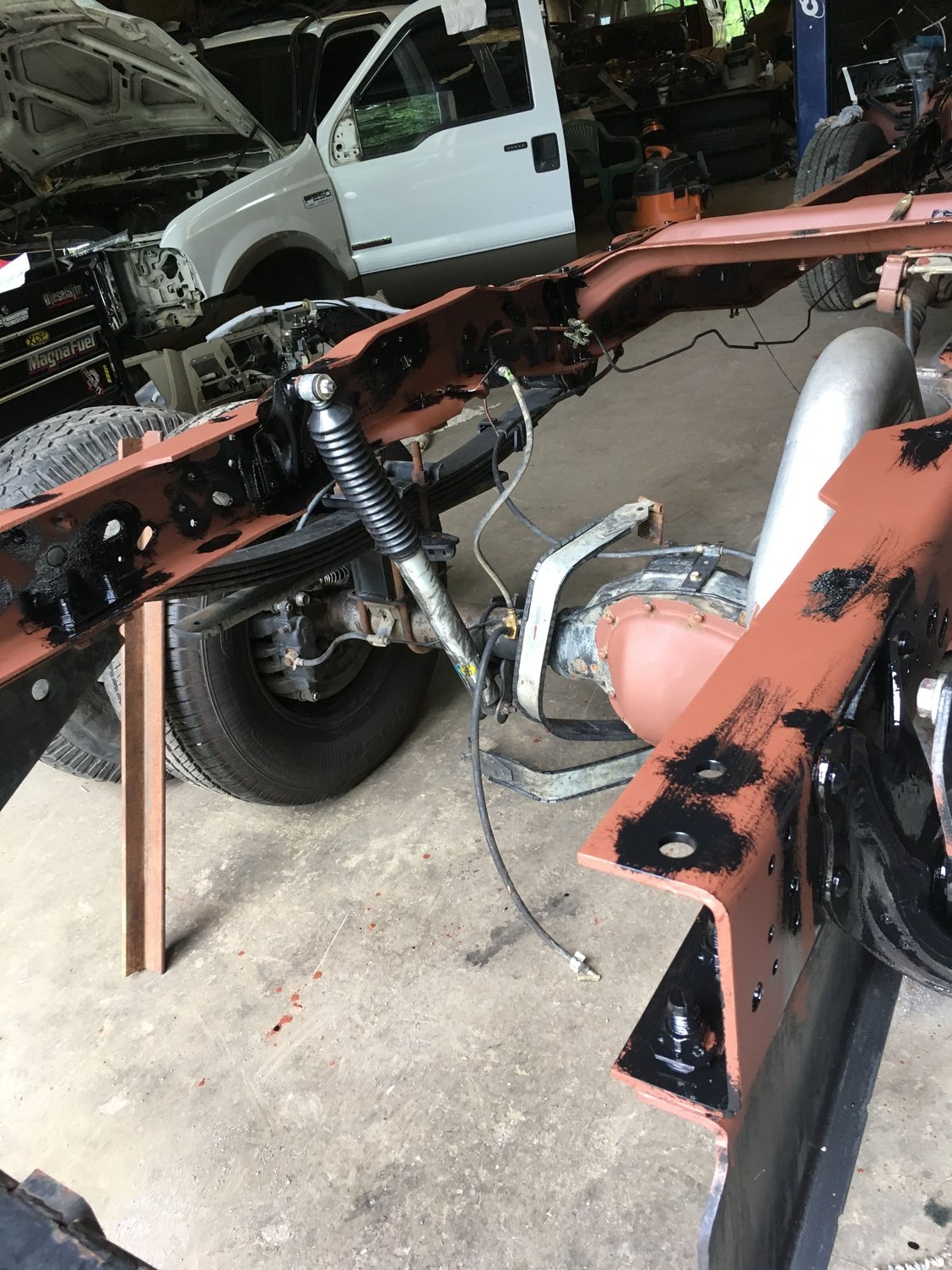

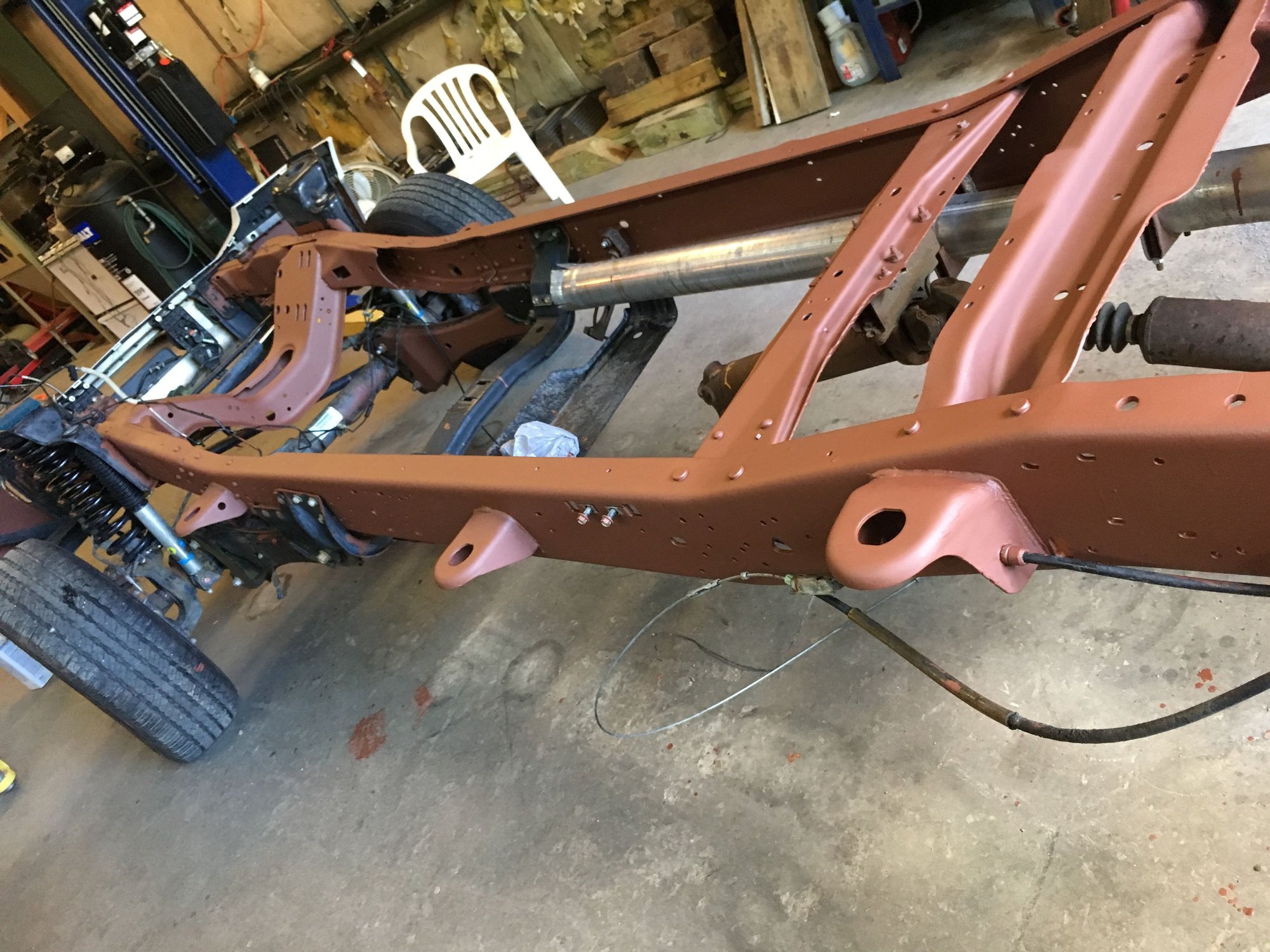

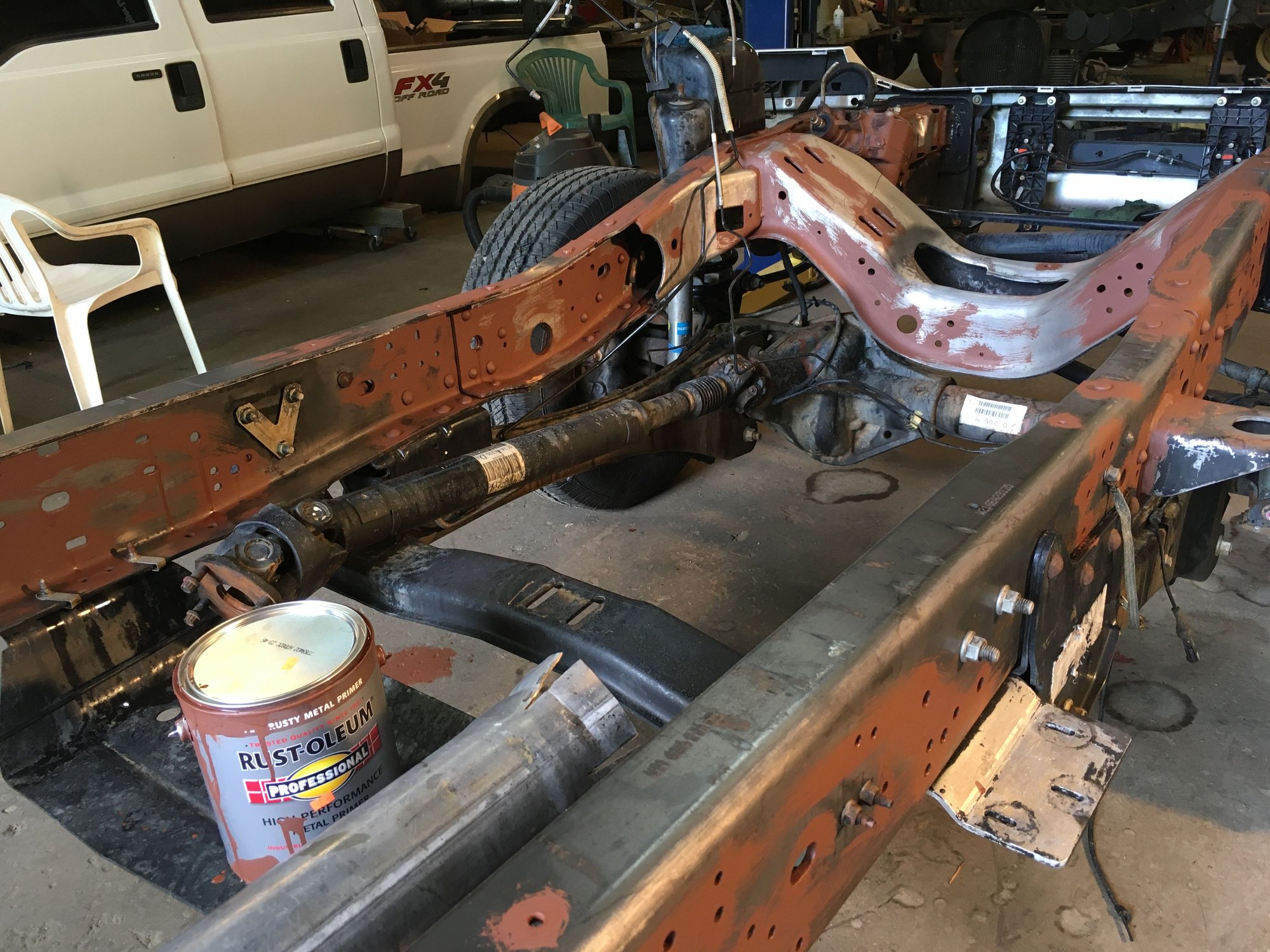

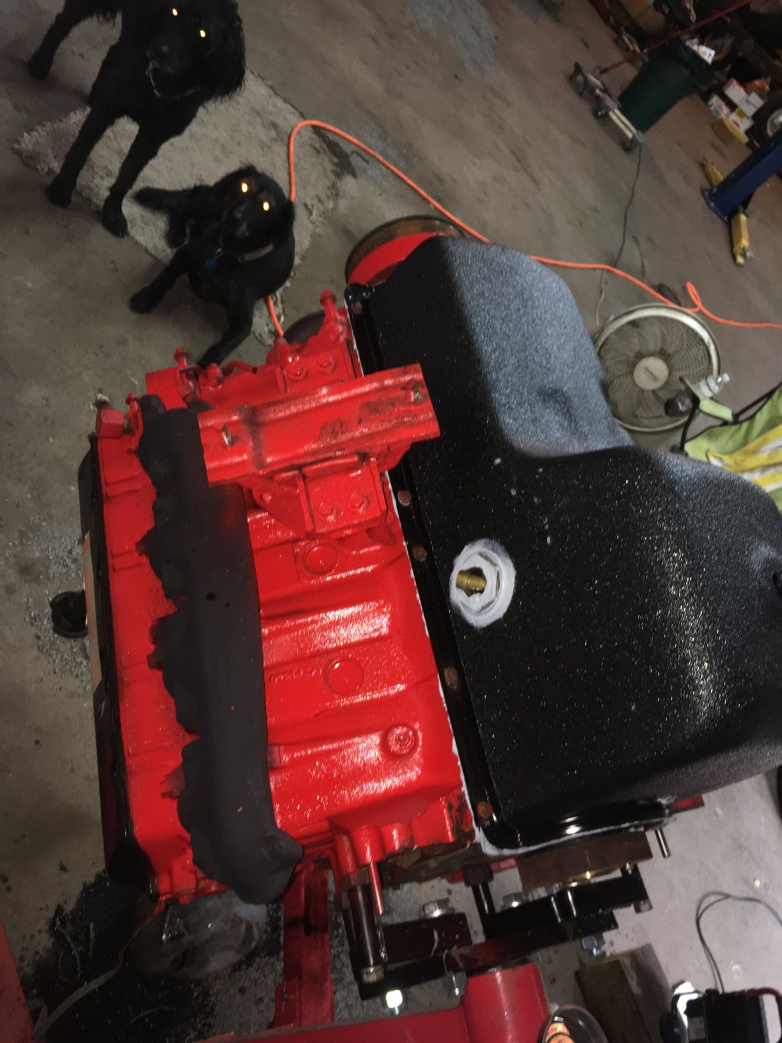

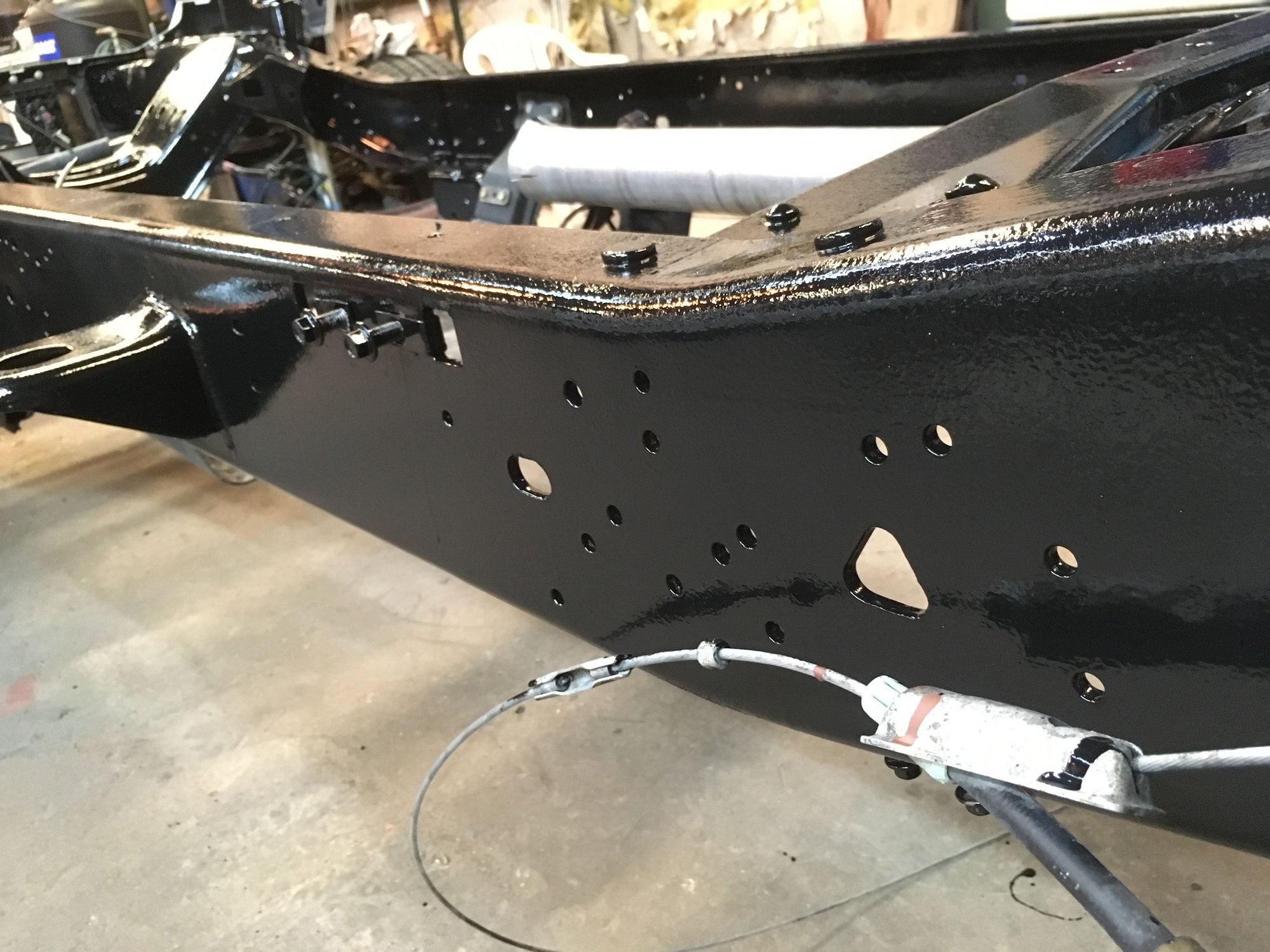

Long before there was a weld-in flange, I was replacing factory flanges and adding TA31 sealant ‘for good measure’. This was a typical oil pan replacement for me - new (spectra) oil pan, professionally applied bedliner, new Motorcraft dipstick flange and copious application of TA31. This does well enough I still question the expense of a weld-in flange. If I were to repair one in the truck, I would use the Riffraff solution
You mentioned wire wheeling to prep frame, etc for paint. Coming from an industrial painting background, I have to say this is generally a bad idea and there are much more effective methods. I strongly recommend degreasing caked on grime with stiff brush and diesel, then p-wash with rotating zero degree tip (HOT water is best if you have that option), using degreaser as needed to make 100% sure there are no petroleum contamination present. The goal is no surface contaminates and nothing ‘loose’ that will fall off with your paint on it. Use Rustoleum Rusty Metal Primer and a 1” chip brush to paint inside all of the holes and hard to reach spots first, then use a 1/2” nap cigar roller to cover everything else. (2) coats of primer is best - follow recoat directions for proper cure time. Follow this with same application technique using Rustoleum High Performance Enamel. These products are $26/gal at home cheapo and applied correctly will outperform any of the over-priced, over-marketed products like poor15.
I only mentioned wire Wheeling get some of the big stuff off but, I like your method better. Man that frame sure looks pretty
I don't think I'm going to strip the whole truck down just to coat the frame anytime soon but it would be a fun project! Especially since it's my only Wheels! Its hard to take that much time off as much as I'd like to. I also have no way of remove the cab, bed, or engine from the truck. I'm quite limited on resources for stuff like that!

You don’t have to pull cab. But bed isn’t so bad.
You don't have to pull the cab to paint the frame? How would you paint the top rail of the frame? Joel and I pulled the bed off with a 2 ton chain hoist. Same with the cab. But he had a nice A frame to park under.
Compromises will be made! But you can get most of it if you try.
I use the engine hoist or my tractor to pull beds. But, (4) people can do it.
