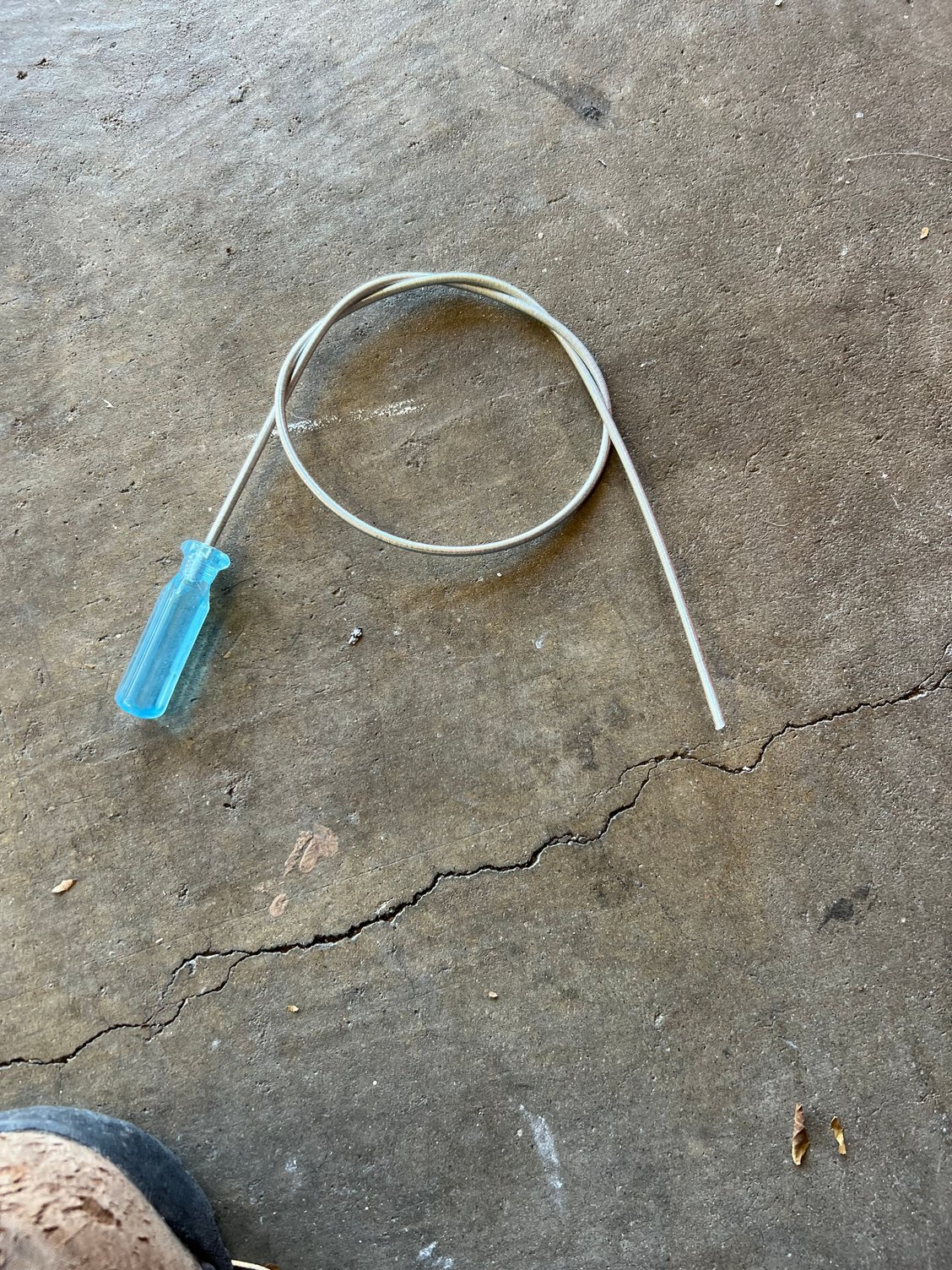

So while I was replacing my water pump I decided to clean out my ebp tube I used this
we use them here to clean out the spiders on our swamp coolers

when i 1st got the truck mpg was terrible, i cleaned it out real good, LOL mpg is still terrible!
But i wasn't to dirty this time, took a few turns and jabs but made it all the way through will little effort
heres the link to it
Dial Steel/Plastic Evaporative Cooler Tube Reamer in the Evaporative Cooler Accessories department at Lowes.com
you can use it in your drill just have to grind it down to fit, and only run it forward, it will unravel if you reverse it!
Ask me how i know LOL

Thank you for the link! I was looking for one of these tools a couple years ago and was not able to find one. Were you able to do it by hand at all or did you have to put it in a drill?

Don't forget to clean the fitting on the manifold too. This is the only place mine was caked, the tube was clear.

Being in Tucson I have a few of those, I cut the handle off one to put in the drill for use on clogged swamp coolers but for the EBP tube I doubt you'll need to use a drill. When I did mine at 140K there was barely anything in it, everything was in the sensor and at the connection.

I used a bicycle brake cable to clean mine out.
I cut it to length and chucked up the lead end into the cordless drill.

I was able to do mine by hand this time, 1st time it took a drill and wd 40 and brake cleaner to get through it, i guess doing it often enough helps to get through it by hand
