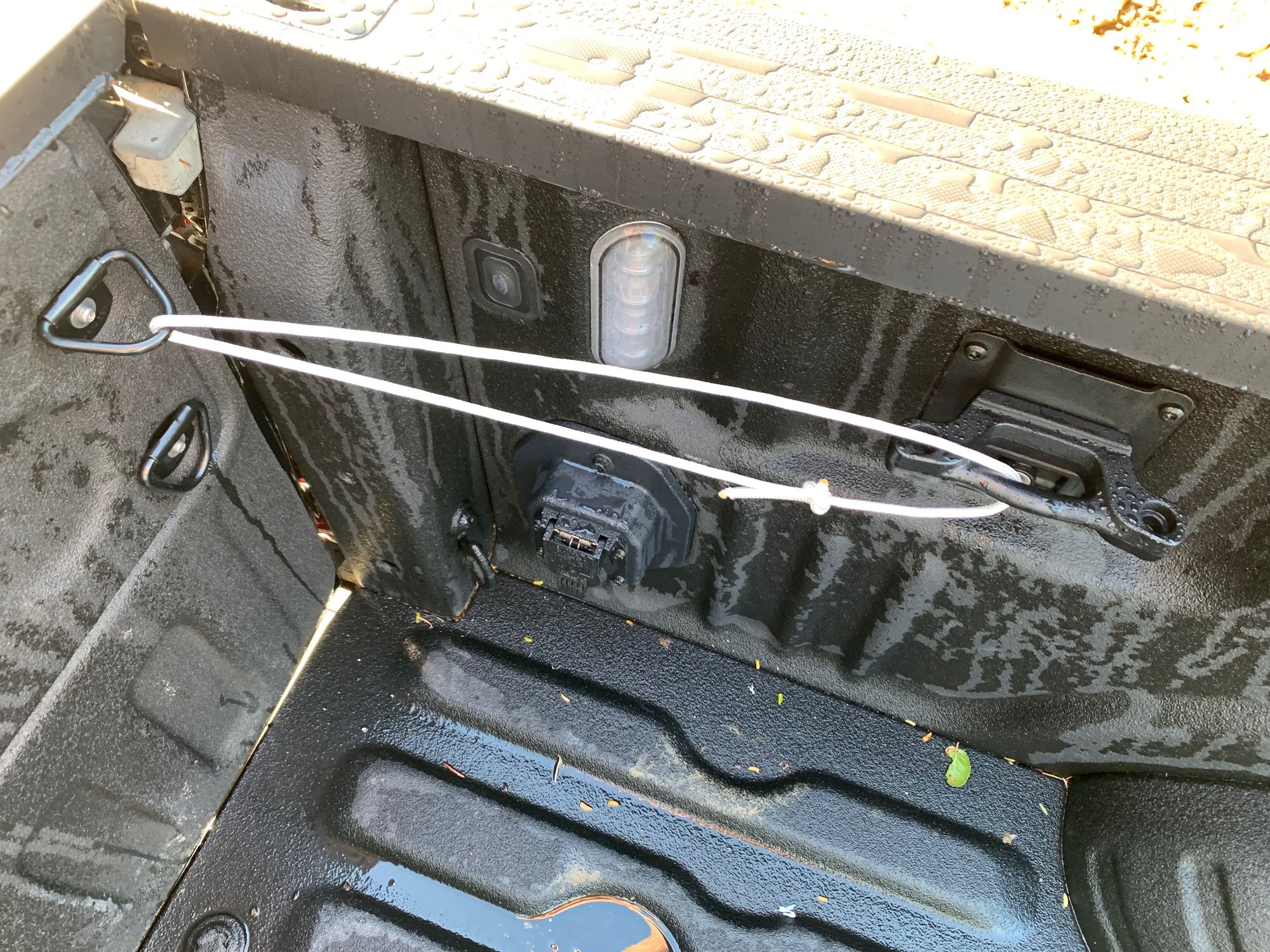

I upgraded to a bungee cord after this photo was taken. Too bad I wasn't using it last month when I was backing up my dump trailer, the tailgate went down and crunched against the trailer jack. Neat-o. PS: I had the recall done long ago, didn't help.
in many instances these trucks cost nearly as much as a house . youve got a bungee holding the tail gate closed and dont find that maddening ? i would be disgusted to say the least
