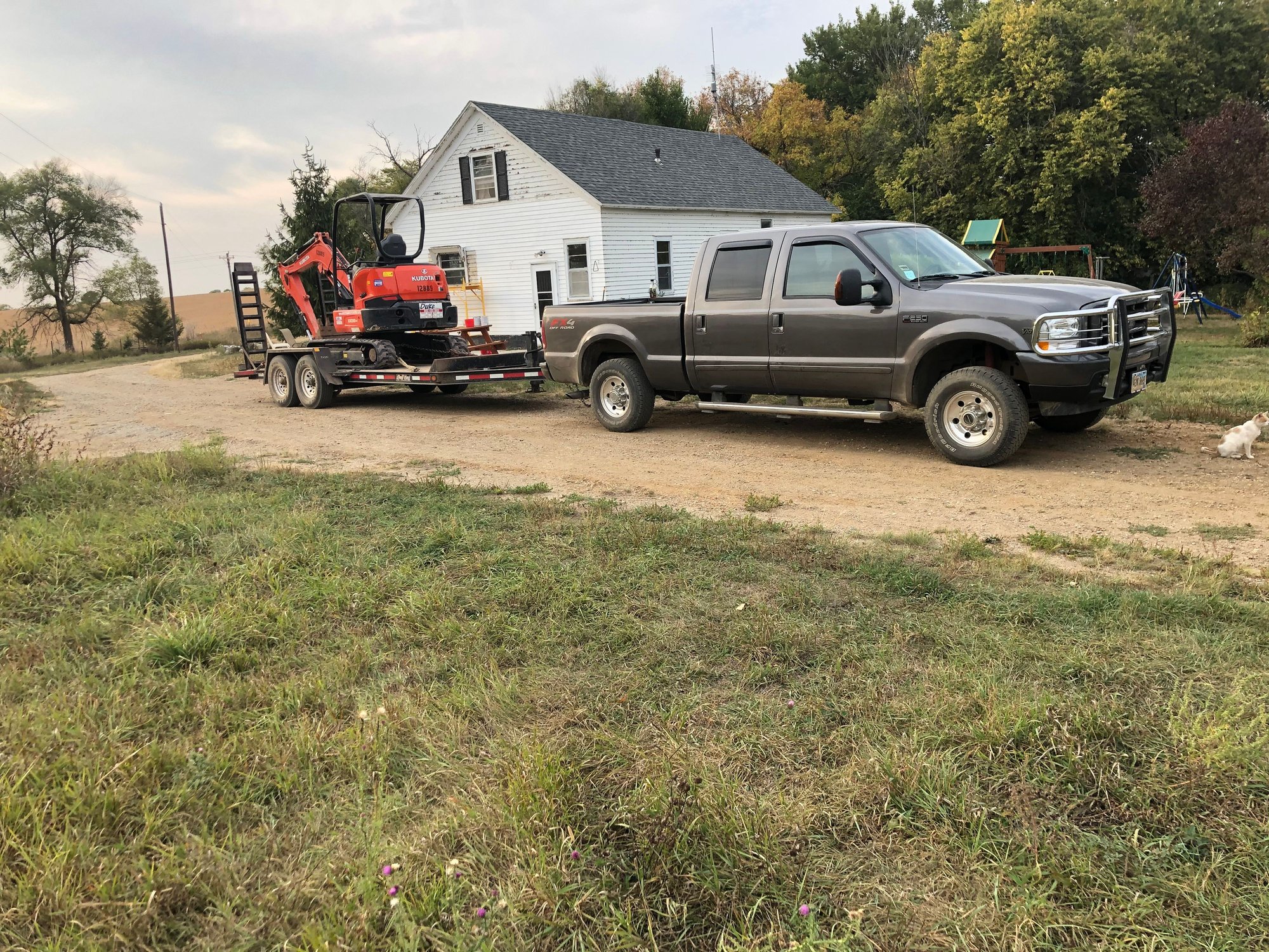

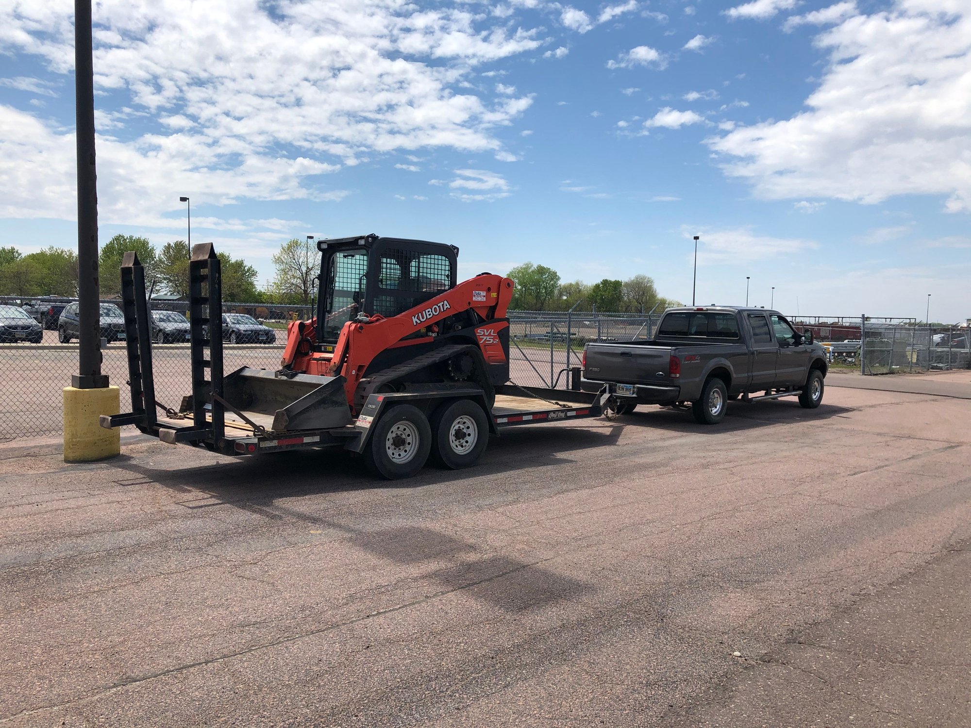

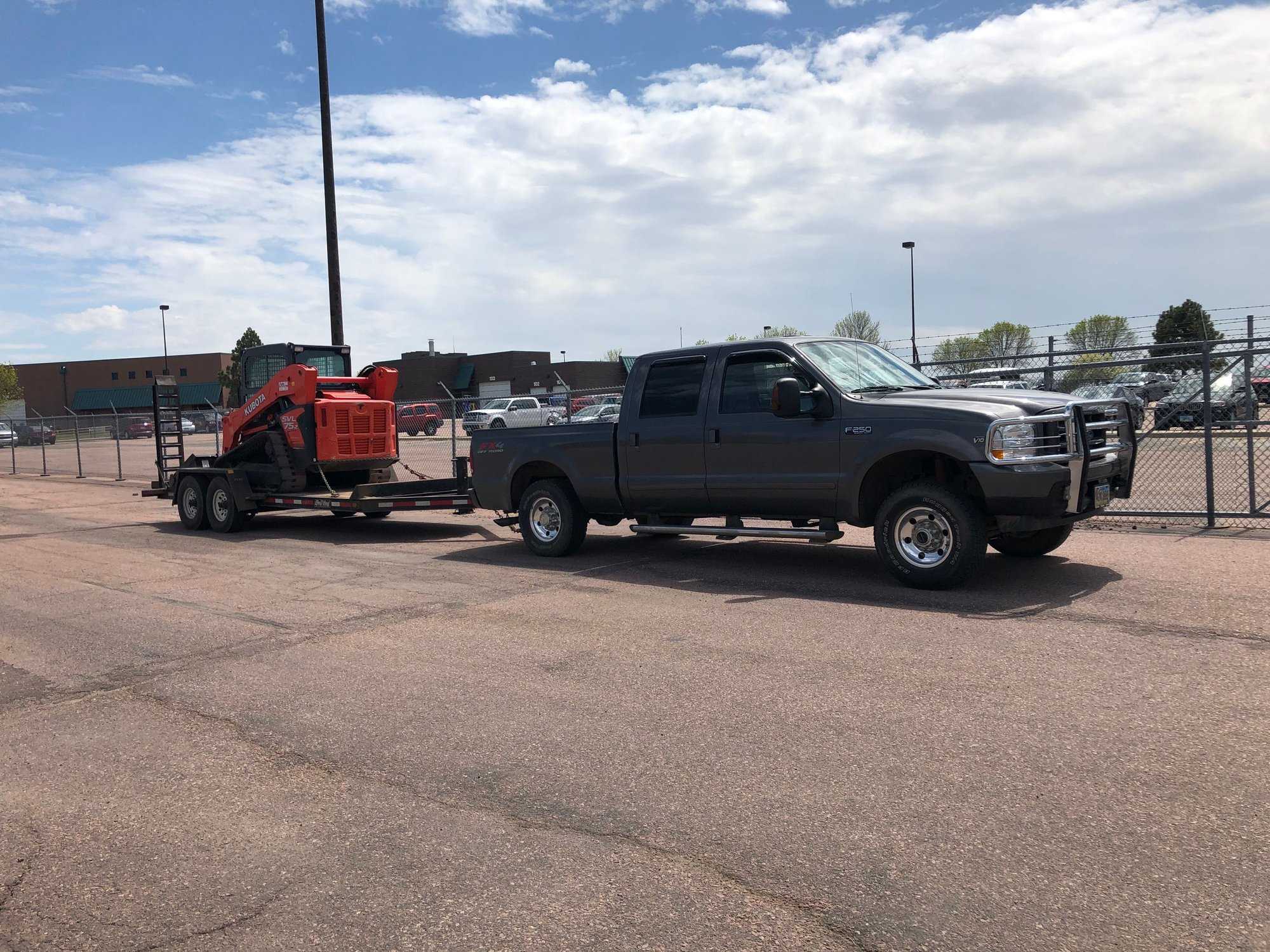

I’ve pulled between 10k and 12k on the factory hitch a few times. If balanced right it pulls really good and doesn’t take enough weight off the front end to become unstable. Going 60-65 was no problem without a huge wind load. A tall load of the same weigh would pull much harder.
If you are thinking of doing this commercially then there are some considerations you should make. An up graded hitch would reduce your liability risk. It is possible to break something with this kind of load, and overloaded components are a huge liability. So find a hitch and ball mount rated for the loads you intend to haul.
Also a weight distribution set up might be wise for those times where you can’t center the load just the way you want or need.
Doing this on your own is one thing. Commercial endeavors are a whole other matter. Personally, I’d recommend against it for commercial purposes.
The excavator below was 7500 lbs on a 3000 plus lbs trailer.
The skid loader was 9200 lbs on the same trailer
